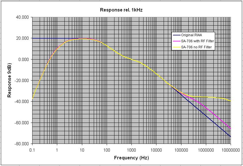

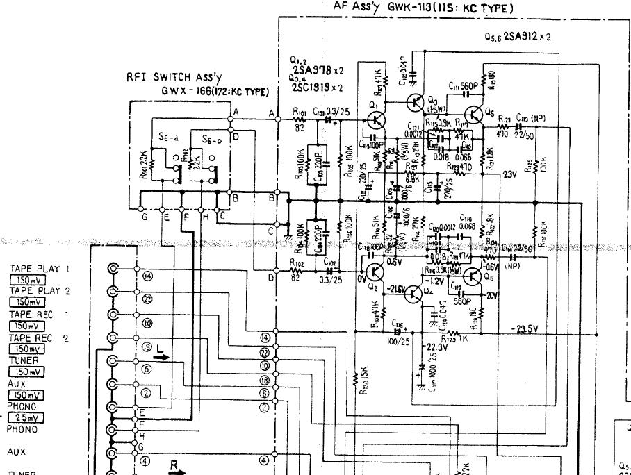

I had an SA-706 on my bench two months ago (SA-706 is identical to SA-7700, save for wooden side panels).
This humble MM RIAA pre from Pioneer is specified with an Overload Margin (for 0.01% THD) of 37dB/1kHz rel it’s stated sensitivity of 2.5mV or 31dB rel 5mV/1kHz.
I measured (for 1% THD) the OM as 213mVrms/1kHz. This is 38.6dB rel it’s stated sensitivity of 2.5mV or 32.6dB rel 5mV.
At 20Hz, overload (1%THD) occurred at 22mVrms and at 20kHz overload (1%THD) occurred at 1080mVrms. Thus at 20Hz and 20kHz, overload falls approx. 8dB behind the values predicted by the RIAA gain curve
Not a stellar OL margin but quite adequate, certainly much higher than the poor numbers found on many other (hi-priced not excluded) units. (*)
The RIAA response is really good.
With RF filter OFF, deviation from theoretical RIAA curve is –0.34dB to +0.13dB 20Hz to 20kHz.
With RF filter ON, deviation from theoretical RIAA curve is +0.04dB to +0.12dB 20Hz to 20kHz.
The hidden asset of this pre is how the output of the RIAA feedback network is tracking the preamplifier output in terms of distortion. No high excursions of THD and ugly waveforms rising suddenly up there, past an input signal level. Distortion increase occurs gradually.
This is not the simplest ever RIAA circuit. It is to their credit that they paid a lot of attention on the power supply lines.

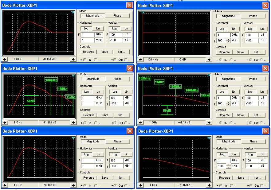

Look at the HF roll-off as implemented in practice on RIAA preamplifiers.
A lot of them follow the upper curve.
Some follow the middle and some the lower.
Some implement the roll-off above 100kHz passively at the input, some incorporate it in the RIAA network and some around one or more transistors.
George
(*) And many manufacturers specify overload for 1% or 3% THD.

That's quite respectable, as well as an easier schematic to follow.
About the only thing of concern for me (although there are plenty of upgrades possible) is the 220pF loading, which is already close to the recommended C for many cartridges. With the tonearm wiring and interconnects it's apt to be considerably higher.
