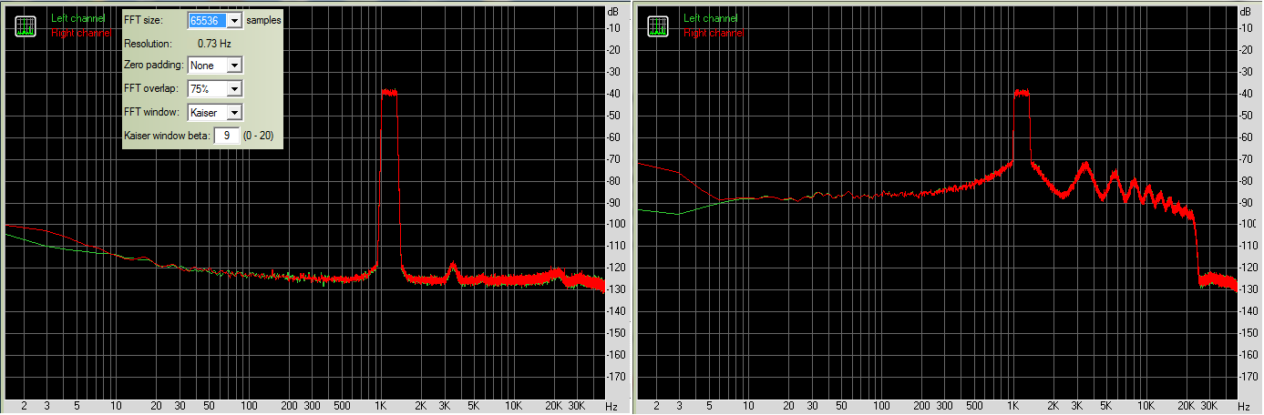

I would rather like to follow my previous post and bring some evidence. The test signal is a narrow-band noise (1000Hz - 1300Hz) which is unaffected in one file and the 2nd file has a special low-level distortion, spectrum of which may be seen in the attached image. If the test is performed on the pure sine, the files are indistinguishable. Tested on narrow band noise the difference is clear. Link to files below, this time no ABX is requested.

I can not hear differences in files presented here and I don’t comment on perception issues.
But these two files is an exception, I clearly hear differences.
I couldn’t imagine that the kind of distortion shown in the 1kHz screenshot can have such pronounced effect (aural and on FFT) on the 1kHz to 1.3khz noise.

Pretty much same except I got ‘bat’ instead of ‘vat’
Listened over main speakers via airplay

That's fascinating.... Big difference! Thanks....
