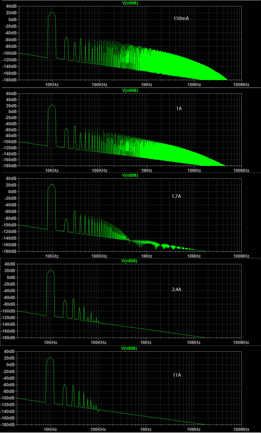

Attached FFT of various output currents of the same amp.
(I love LTSPICE: never the magic smoke ;-)

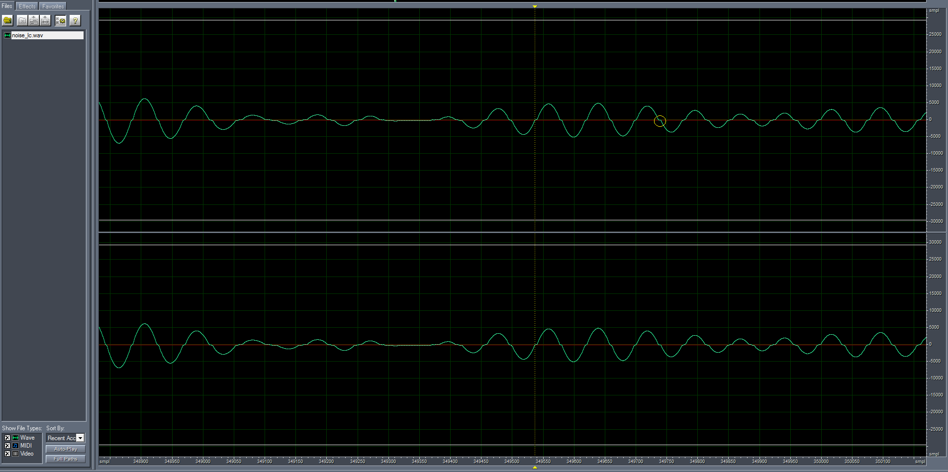

That's interesting, Pavel - thank you! Can you say more about these distortions & how they were created - might help others experiment too?
Transfer function is modified in the low level area. Normally it should be a straight line, here it is bent for low levels, approaching quickly to zero. The result looks like a crossover distortion of a poorly designed, heavily underbiased class B amplifier.
Thanks Pavel
