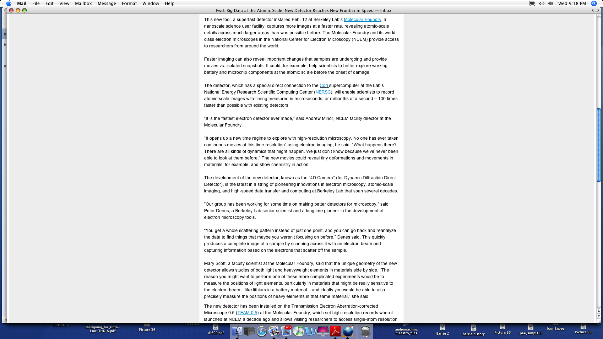

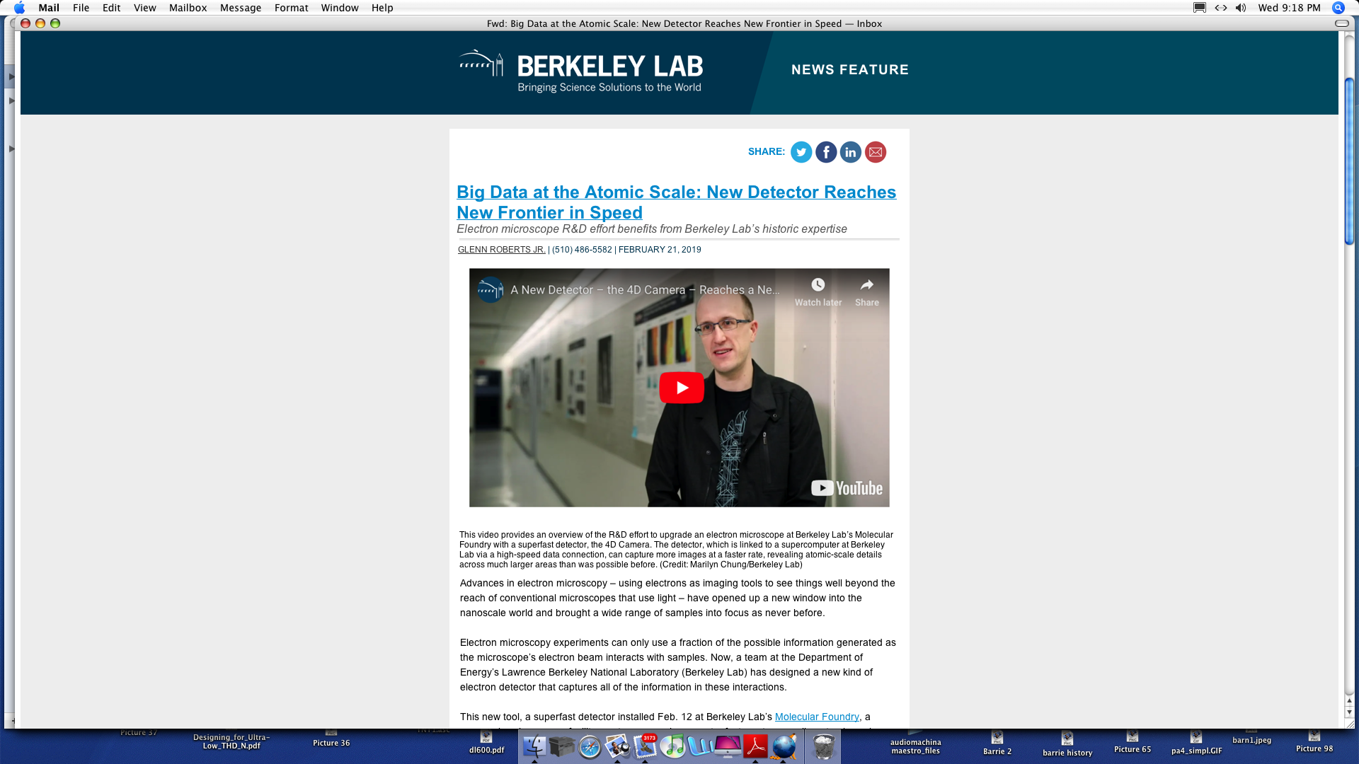

John, pretty cool add in for their TEM. Looks like a really high end FEI that they've modified heavily.
