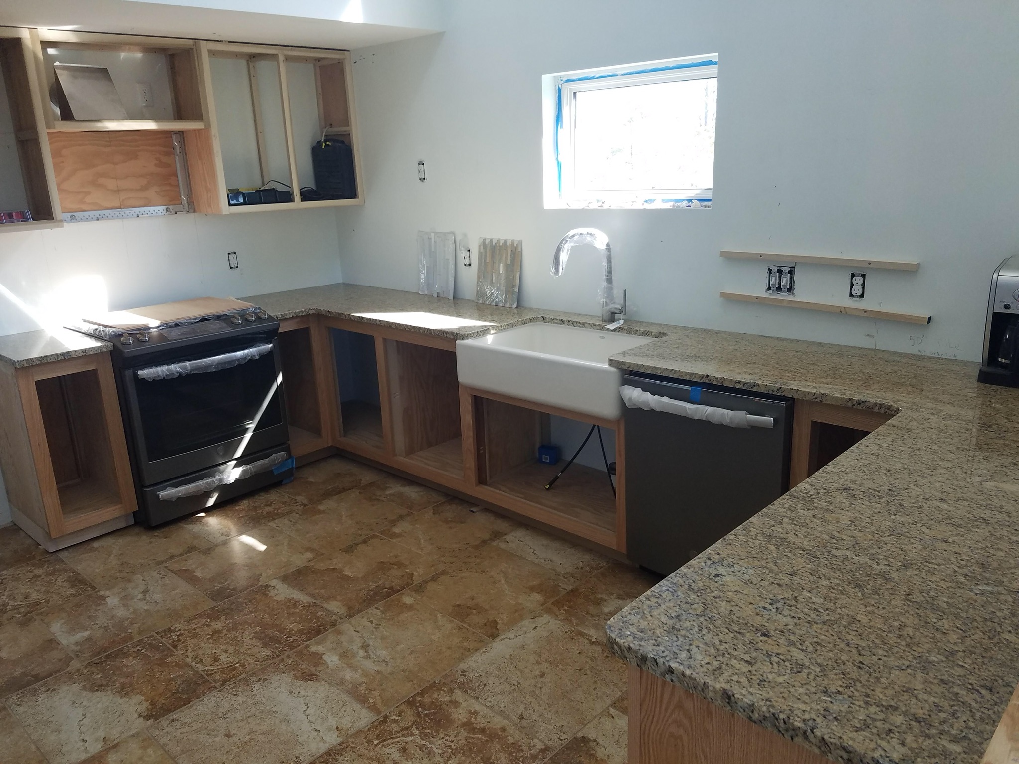

Yah.....plan is to try incorporating my lab 15’s as high into the mid bass as possible (up around 200hz)
It’s gonna be a two sub (l/r) stacked speaker configuration (10” mtm on top) just gotta finish the kitchen b4 I’m allowed to work on the new wall of sound!
