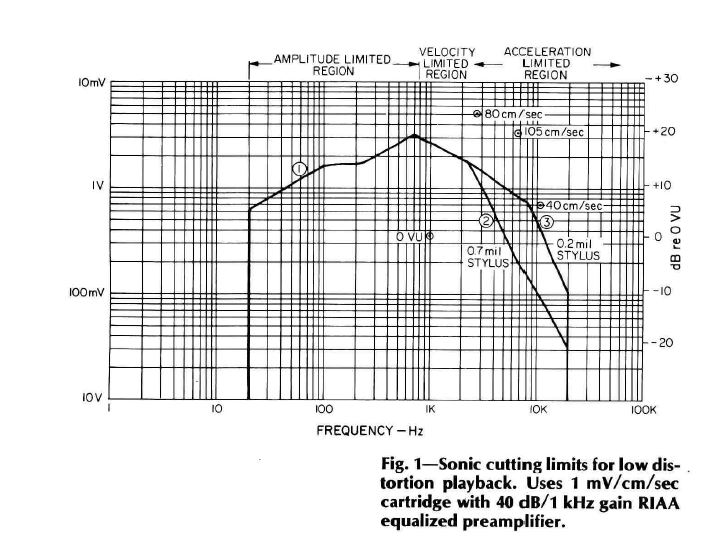

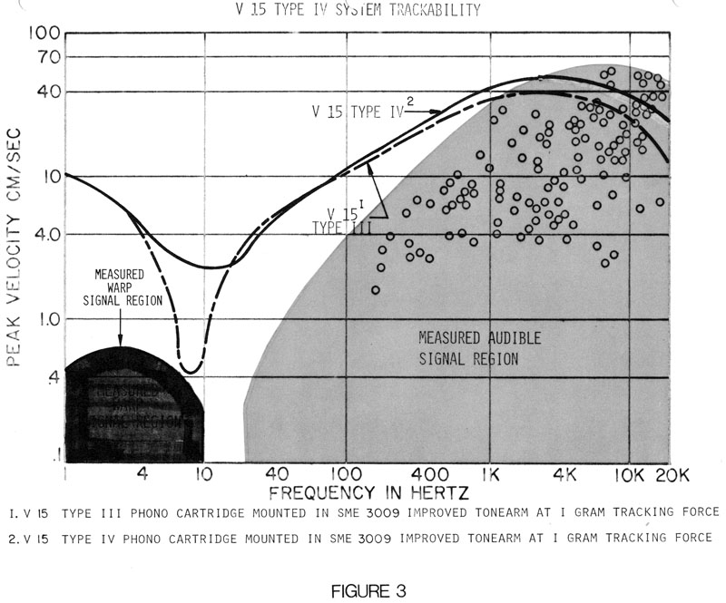

And for context on my comments on the shure trackability please see attached the graph from the shure 1978 technical seminar (r) and Holman's chart (l)from his papers. The 105cm spot point is from a mono record and is clearly untrackable by anything, and possibly uncuttable?

I've just looked into the specs of Neumann's SX74 cutterhead and it actually is 10kHz/10ms toneburst with a max. 105cm/s
Chris: No hating, but some of the numbers cause a raised eyebrow. No one ever bothered to check their numbers and they generally only appeared in advertising print. All suggests there might be some harmless fun trying to replicate?
Certainly didn't mean to point a hatey finger at you, of all people, but wondered where the name Shure came into it. They really were the good guys back then, solid pocket-protector propeller-beanie-hat guys. I would disagree that their numbers were wobbly at all; everyone in those days worked with the same numbers. Shure, Stanton, Ortofon, B&O, some wacky Brits, everybody was fishing in the very same pond.
Doesn't mean that a modern look can't turn up something new, but vinyl records were made by people just as smart as us (much smarter than me, of course, but still) who did just that for their profession. 45 years later what are we doing? A simple Newtonian snapshot only shows how far we are from a detailed model, and, by that same token, how unnecessary a tons per square inch model really is. It's an impossible and antique medium, so we should enjoy it as is, not?

Shure were the only people who actually measured and published on the limits of what was on records. It's always intrigued me that no one tried to counter this or publish their own numbers. It's fun to poke the carcas, same as drilling my own emulsion tubes for weber carbs.
