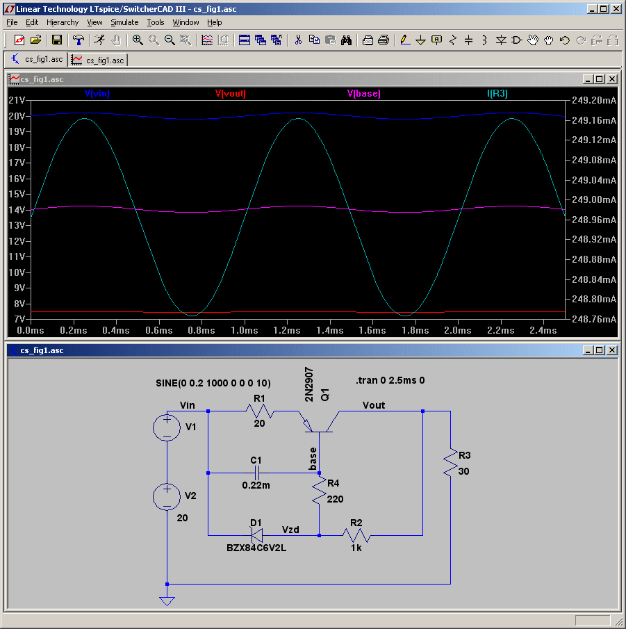

Gerhard, my question was more about the 100R shunt resistor, this value is to high if you expect something like 200mA from your current source, because in this case you get 20V across this resistor, and your "unreg" source is 20V... so you need at least 27-28V with a 100R resistor, or lower his value.
Hi, you are right. 100 Ohms was the value where I stopped playing ..
Let's take this one, then the Zener gets enough current, too
Gerhard

john curl said:
Richard, what I am most concerned with is the 1K resistor. Looking more carefully at your complete schematic, I see that you have only a 2V differential across the 1K resistor and this implies that all the current from the resistor goes into the transistor to supply the base current. Is the 3V device even turned on? Anyway, why not put the 1K resistor to ground. Wouldn't that work OK?
As I said in my last post, you are absolutely right John, about the 1K resistor (too low to set the zener current), putting it to ground now that you pointed it, is obvious! In this case the value for this resistor must be higher around 2.5K-3K (17V/3K=5.6mA) and for fig1. During all these discussions I wondered more especially about the pro's and con's of the current source transistor "direction" and trying it in an unusual way, so just like you (as my crossover design is fet's based), I forgot Ib!.

In fact I need 150 mA for the audio circuit and I think that a current source about 200 -250mA would be appropriate, and would allow a suitable Rds on the shunt mosfet, the problem with this circuit is to get a high current (with low noise) on the pass device (current source), with the requirement of a low noise reference (zener or led) so 3 or 4V and a “high” emitter resistor (but not to high) in my case something between 10-20R. In short I need the highest V reference together with the lowest noise to don't amplify it by a low emitter resistor value.
Justcallmedad, I think that we are on the right track. I don't know which color led is the quietest, or if the size of the led matters. Still, the effective impedance of the leds, even 2 or 3 in series is pretty good at low currents because it follows the 'diode equation'. So 2 ma should be about 13 ohms per diode. Not bad! A 3V zener might be 100 ohms or more, at 2ma. Not too good. Seems that leds could win in regulation, and probably in noise, in most cases.

Real circuit measures report.
I tested today in the “real world “ the 2 current sources circuits, the schematics are reported below. I set Ic to 100 mA.
I didn’t use any capacitor, and I measure the line AC rejection of those current sources.
The fig2 rejection is about 55 dB until 100 kHz then increases progressively towards 20 dB at 4MHz.
I get 10 to 20 dB better AC line rejection with the fig2 circuit. Adding a cap from base to ground improves it of 20dB.
I used a led in lieu of the zeners on the schematics
Has someone an explanation on these important differences between these 2 circuits on AC rejection ?

Re: Real circuit measures report.
Justcallmedad said:
I tested today in the “real world “ the 2 current sources circuits, the schematics are reported below. I set Ic to 100 mA. ......
Is this a result of a real, soldered circuit or a simulation? (Nice 5 digit voltmeter!)
If it's a soldered circuit, how are the current sources implemented? Are they potential energy sources?
Does "rejection increases from 55 towards 20 dB" mean that it's getting better or worse?
One would expect that fig. 2 is a little bit better because the beta of the npn is probably a little bit better. I did not check the data sheets. But a difference of 10 to 20 dB seems too much to be explained by beta.
If you insert a cap from base to gnd in fig. 2 you get something that looks much like a cap-multiplier AC-wise. This means it probably behaves more like a const. voltage source with a constant current load (I6 par 100R) for AC rather than a CCS. That's not bad by itself, but a second stage parallel regulator (as probably intended) won't find the Hi-Z environment it works best in.
best regards, Gerhard

Gerhard, these results are not from a simulation, but from a solderless breadboard.
Rejection worsens from 55 dB towards only 20 dB at 4 Mhz.
Differences can’t be explain only by Beta mismatches, but rather as you pointed out by the Hi-Z Low-Z from one way to the other… that probably causes emitter degeneration in one case and not in the other or perhaps also, by a better channel separation (Base/Collector) in fig2 case.
I have tried to lower the shunt resistor to 10 Ohms but in this case my function generator doesn’t work properly (Zout 50 Ohms) I will carry on these tests later with a modified power amplifier for a good bandwidth until a few MHz.(Gv=1)
In any case it could be interesting to see which is the most suitable direction, knowing that we get line and load disturbances. The goal is to know which direction is best appropriate taking into account the different characteristics of these 2 disturbances.
