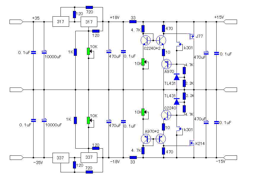

hi,beppe
my reg PS is based on my frined's design which showed below
john curl said:It is an interesting schematic, SG, but it could be made quieter with the addition of a few parts. Buffering the TL431 would lower the noise contribution of the regulator. This could be done with a simple RC filter, after each TL431.

john curl said:There I have a low Gm, low noise fet, like a J203, as the reference, with its noise attenuated by a large (100uf) cap to ground. It is true that there will still be some really low 1/f noise, but it works well in the audio range.
Do you think that a SST310, U310 or BF512 is an acceptable replacement?
regards, Gerhard
Gerhard, these devices would work, but there are better devices in general. These devices are made for RF. They usually have low capacitance (good), and moderate Gm (OK), but they have low voltage breakdown and probably an even lower initial leakage threshold. It is better to find parts similar to these, except that they trade off higher voltage for lower Gm. These usually make a better current source.
thanks for your advice,Mr.John.I would try...
I had tried to lower the noise of output voltage:add a 220U EL cap paralelled with the TL431,add a 22U EL cap paralelled with the NFB resistor of TL431,add a RC network of 1U film cap and 10 ohm resistor paralled with the output of PS,and add a BJT buffer in correct amp.each modify give me a lillte improve of the sound.
the 'buffer' what you said is refer to the 'simple RC filter' or a active buffer? thanks again.
X.G.
X.G. I would put a 1K resistor just after the TL431 output, then the cap. The problem here is: The TL431 makes 100+ nV/rt Hz noise and has a very low output impedance. Putting a cap DIRECTLY across the output will NOT do very much, if anything useful. The cap must have something to work against to be a good RC filter. Now, 1K and 220 uF for example, gives a rolloff starting just below 1 Hz, so at 100 Hz, you have about 20 dB lower noise from the source, and at 1KHz, you have about 40dB or 100 times lower noise. For a line amp, this would be OK. A moving coil pre-preamp should use a completely different design and reference, because the bass frequencies can be boosted as much as 80 dB, or 10,000 times. In this case, the 1/f noise that would remain, would be annoying during measurement and even listening.

Michael, I am only addressing a specific schematic that was posted here. The solution is fairly easy, and it is a good example of an ongoing oversight.
This oversight is trying to bypass a voltage source with just a capacitor. It just doesn't work very well at audio frequencies. Yet, people, both pro and amateur, will try to bypass a zener, or a TL431, or LED's without thinking it through. Of course, it is best to start with a low noise source, if it is practical. When it is impractical, or all that you can get is some component, then knowing how to apply an effective low pass filter is useful. We can go even further with active cap multipliers, or even an active low pass filter, but that is a lot more work than a simple RC time constant added after the voltage source.

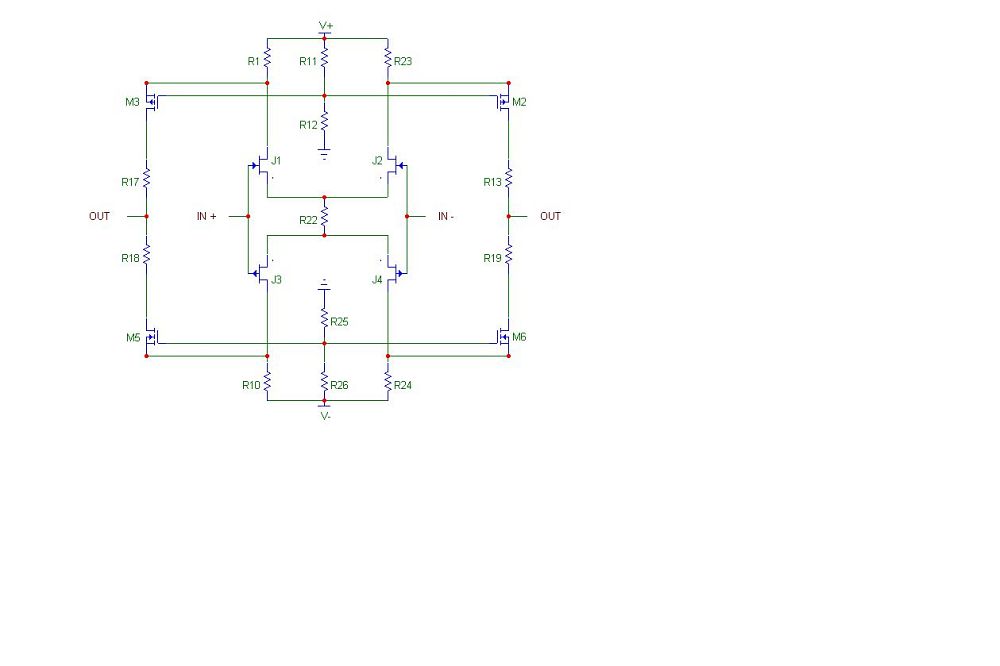

I received an e-mail from a group of contributors to this thread, and I was sent a schematic, that is, in principle, an accurate description of the CTC line stage. It is OK to publish this schematic on this website, as it is only a generic description, which I stole from Charles Hansen, anyway. This might make things more clear, as to what I was trying to achieve with the Blowtorch preamp. Thanks Charles.
lumanauw said:Will it be better if R1-10-23-24 is replaced with CCS?
Nelson Pass thinks so…
http://www.diyaudio.com/forums/showthread.php?postid=723517#post723517
For open loop, eliminate the feedback resistors and load the folded cascode output as Justcallmedad wrote...

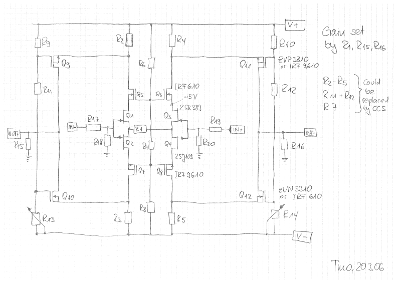

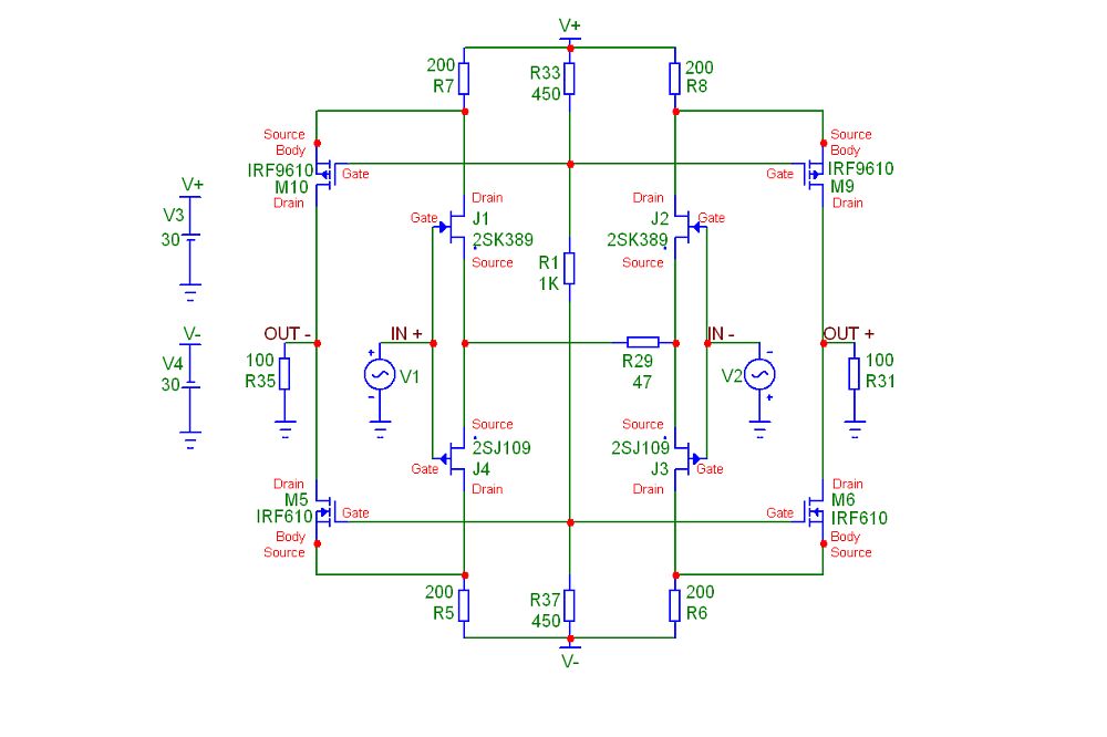

zinsula said:This is an example how I would do this today....
JFets running at IDSS and cascoded.
JFets running at Idss, good!
But why "double" cascode ???
