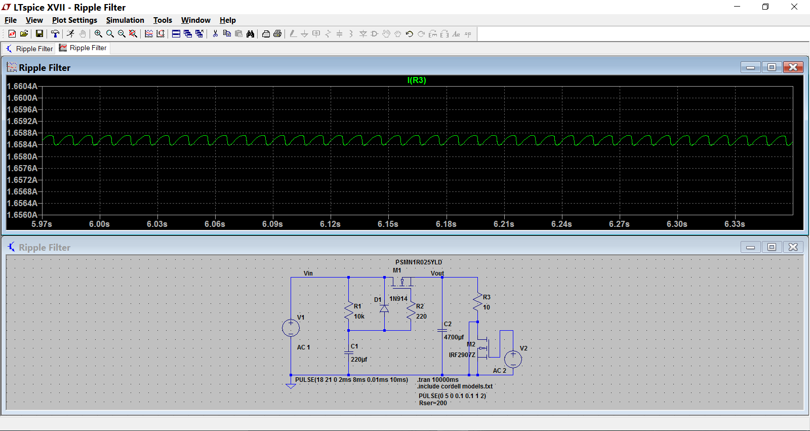

As Mark said really, a logic level low Rds device. This is the PSMN1R025YLD.
Looks good
Ripple at 1.7 amps steady state and pulsed 1.7 amp.
I've attached the spice file set up for the IRF240 which will run straight off in LT IV. The PSMN1R025YLD FET model might only be available in LT XVII
Looks good
That PSMN1R025YLD looks like an awesome FET, however it has 25v limit which sort of limits it to 15v class A head amps or maybe preamps. A 25v typical class A supply might be too much. I like the 890 microOhm Rs_on, and continuous 100A!

Is the input capacitance too large to use it as an audio OPS?

The capacitance shouldn't be much of a problem at audio frequencies, and these things are meant to be used at high speeds in DC/DC convertors and so on.

The driver has to be able to both charge and discharge the gate capacitance and so a few milliamps need to be available.

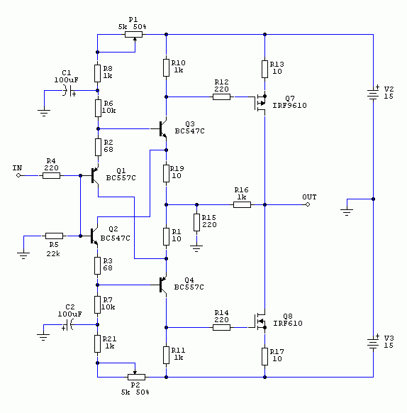

Perhaps something like this could be done for a small amp to drive headphones but replace the IRF610 with this unit (assuming there is a complementary p-channel)?

I don't see why not although as always, it would be advisable to do some real measurements and weigh up the pros and cons compared to more traditional devices.

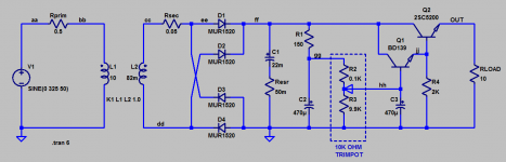

Which is why it's a good idea to include a 20 turn trimmer potentiometer in your circuit design, and then use an oscilloscope to measure your circuit's operation under worst case conditions (min Vin, max Iload). Dial the trimmer while watching the oscilloscope traces. Adjust until you achieve a balance between dropout voltage and safety margin that is acceptable to YOU. Done!
The schematic below would benefit from a very low threshold voltage NMOS FET like IRL640A. If your input ripple is small, this particular MOSFET can operate with quite low dropout voltage. If your input ripple is big, dial trimmer pot R2 until you get the safety margin you think you need. Done!

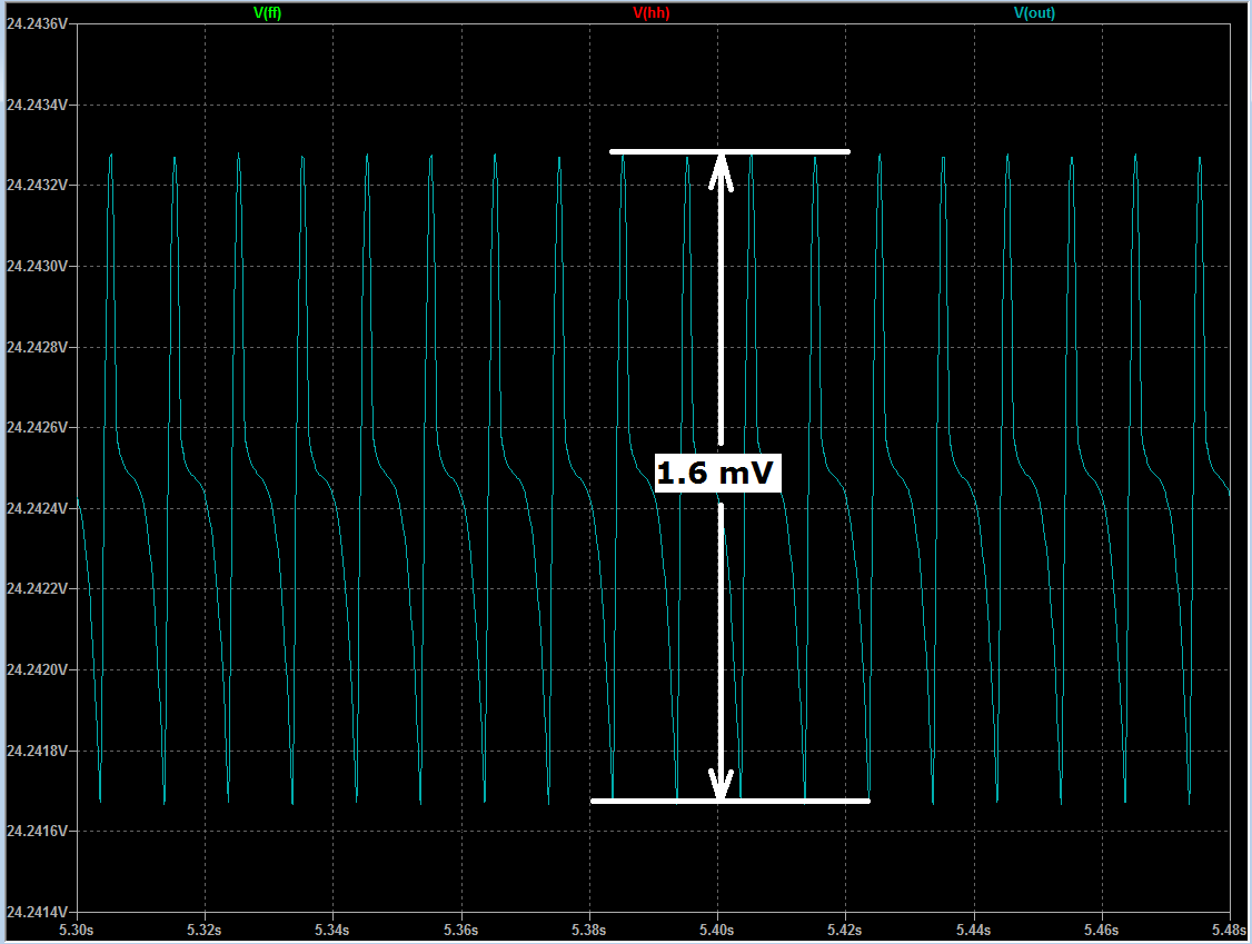

Here's a darlington version of a positive supply capacitance multiplier. I reduced BOM cost by downsizing the enormous bulk capacitor C1, from 47 millifarads (post #1) to 22 millifarads here.
Dropout voltage has been optimized through the use of a trimmer potentiometer; Vdropout = 1.3V. {input is 25.5V, output is 24.2V}.
Output ripple is 1.6 millivolts.

Thanks Mark. I will give it a try - I agree you don't need the 47mF and huge BOM savings with the above setup. That's a nice low dropout voltage. 33mF Cornell Dubelier caps are not very expensive and will give quite a bit better ripple control. Also I did sim with 2.2mF inside instead of 470uF or 220uF and that helps a lot. I get maybe 150uV ripple with 2amp load as I recall.
Assume the worst power amp ever conceived: an amplifier with ZERO power supply rejection ratio. Every millivolt of ripple on the supply rail, becomes a millivolt of ripple at the loudspeaker. Then 1.6mV peak-to-peak ripple is 0.6mV RMS into the speaker. Power delivered into an 8 ohm load is 45 nanowatts: 45 billionths of a watt. A very quiet sound.

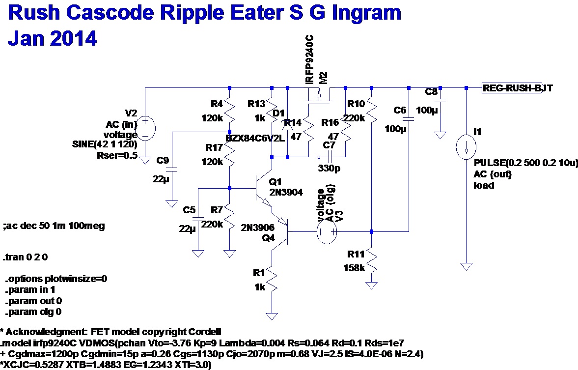

I'll add my 2c then....
http://www.diyaudio.com/forums/power-supplies/258464-rush-cascode-regulator.html
