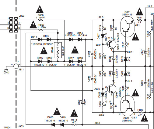

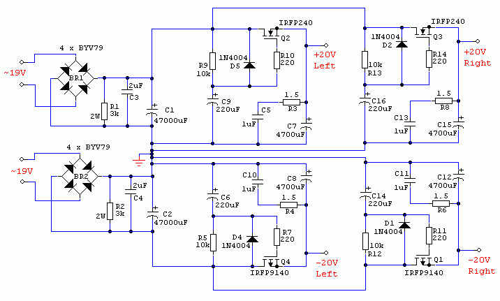

Many high quality Japanese amp used simple capacitance multiplier with CCS for zener to fix output voltage. Please see pic as below:
I tried simple capacitance multiplier with only 1 BJT tranny per rail, there is no any sound when hearing closed speaker cone but still available a little hum, buzz when i tested by earphone. So i want to find better circuits, anyone can suggest me?!

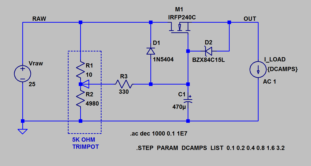

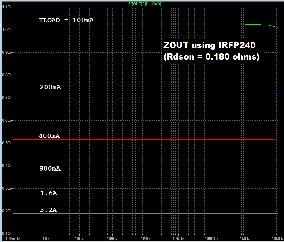

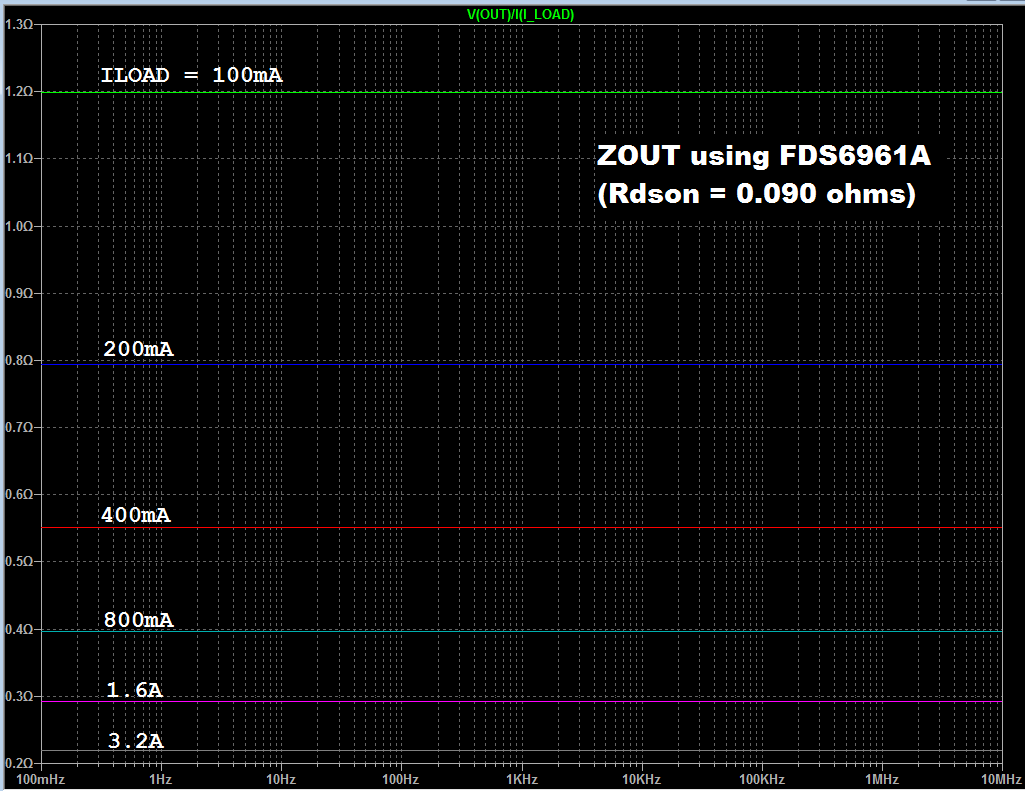

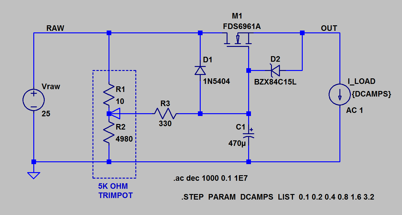

Here is one way to measure the output impedance of a capacitance multiplier circuit, in simulation: Zout = dVout/dIout. You use SPICE's AC analysis to perform small signal "incremental" analysis, then inject an AC "test current" into the output and measure the resulting voltage. Ohm's Law tells us that Zout = outputV/inputI. Easy.
I ran it for two different MOSFETs whose Rdson values were different by a factor of two. As you can see, the MOSFET with the smaller Rdson had the larger Zout. Load current was varied around the post#1 centerline value of 1.5 amperes. As member AKSA pointed out, output impedance decreases when output current increases. This is why I like to connect resistors straight across the rails in low power audio circuits (preamps, DACs, line level accessories): the extra current lowers the power supply output impedance, and the cost (extra heat) is small.

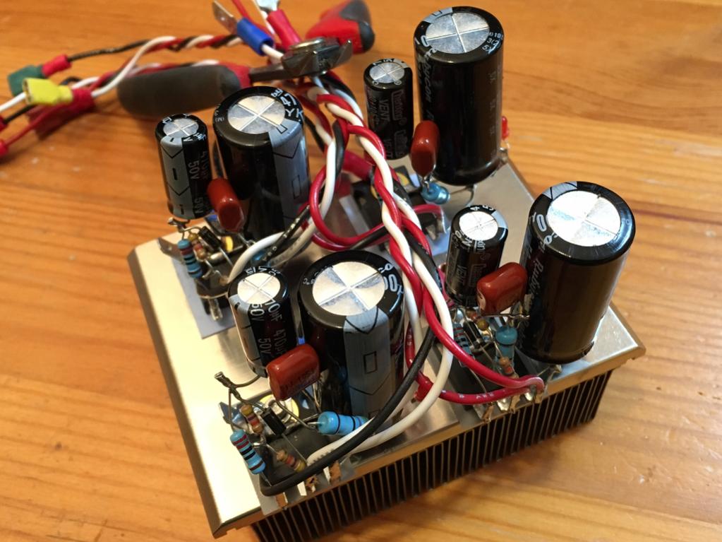

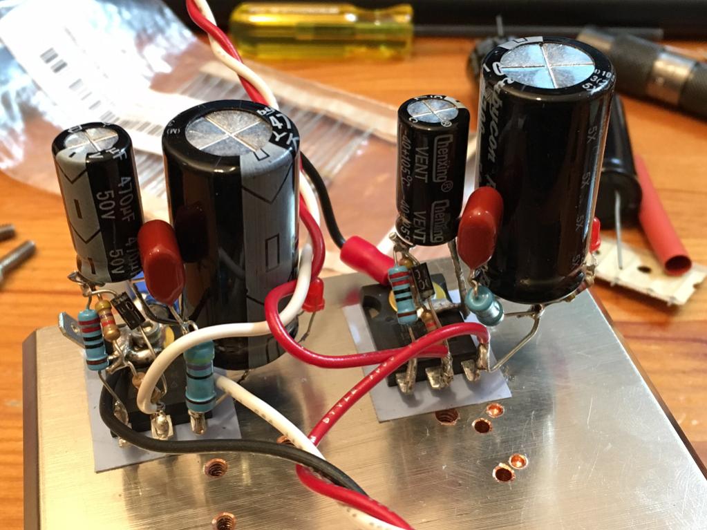

I redid my Juma cap multiplier with 50v caps and increased the 220uF to 470uF. 1N4007 diode and snubber is 4.7R vs 1.5R. Here are some closeups of the stereo setup on one heatsink.
With 44vdc rails input, I get about 39v output with about 400mA quiescent current. The ripple measured with AC volts is 0mV.
Currently using with my CFH9 amp.
