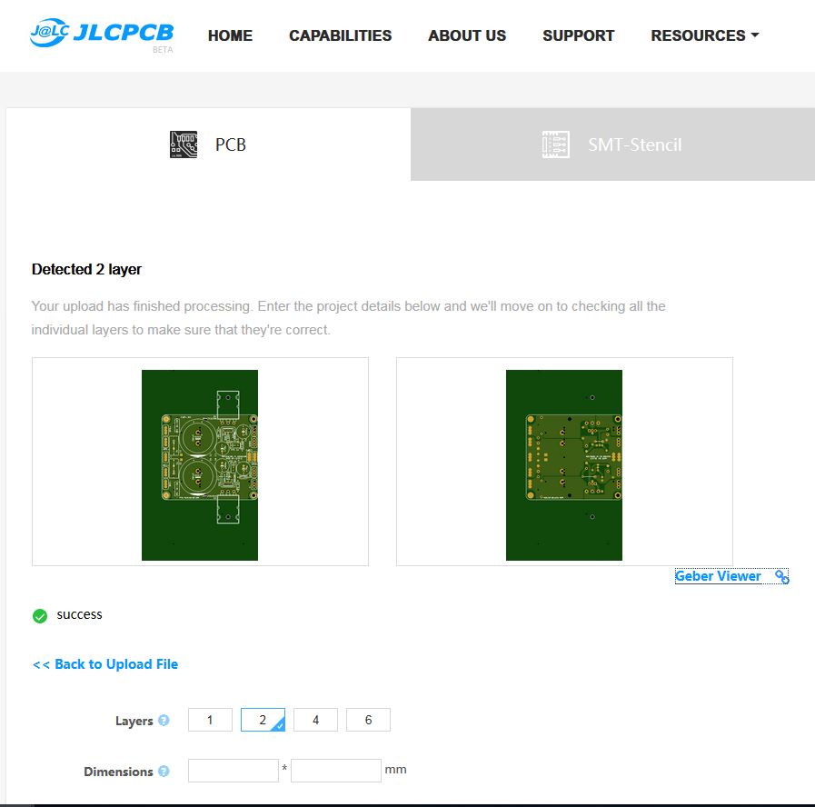

I manually placed the drill file in the same directory before re-zipping it. Then used that to upload to JLCPCB. $2 for 10 is quite the deal if an "add-on" to another order that you already have and that takes care of shipping. Under 100mm square board Gerbers are great to have on hand as add-on orders.

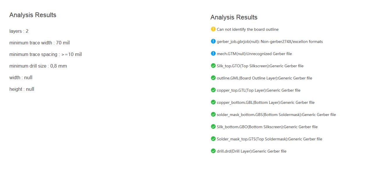

Hello X,
is it possible to upload your Gerbers, you have sent to JLCPCB? If i do the same, as you did, i get an error on JLCPCB, says missing board outline. In the zip file it is present.
BR
Günni

Not sure why you are having so many problems. I just went to post #512, downloaded the file there, and submitted to JLCPCB - and it accepted it no problem. The Gerber viewer shows the board correctly. I also uploaded it to Online Gerber Viewer and checked there and it works too.
So here is the link to the tested Gerber file: https://www.diyaudio.com/forums/att...plier-cap-mx-gtose-mjohnson_r1_2018-08-31-zip
You might try renaming the extension of the drill file from .txt to .drd and place in same directory - this is done in the attached file below and it works well in Gerber viewer.

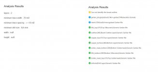

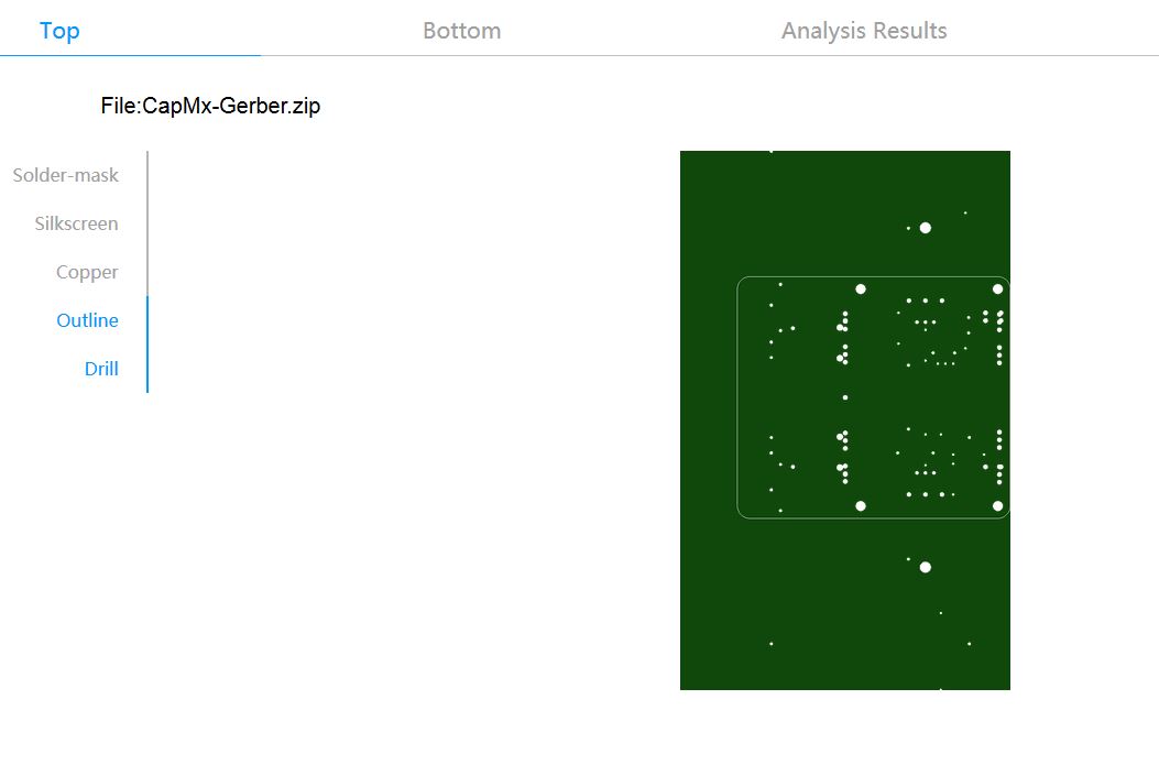

Hi X,
Thanks, but i have no problem with that. Attached you see, what the Gerber viewer from JLCPCB made out of your uploaded file;).
See also the analysis results (2) and the automatic detection of size not works (3).
All other layers are ok.
BR
Günni

It could be due to jlcpcb software for / rendering of gerbers may be faulty or there is a bug in the online viewer.
I would believe manufactured PCBs rather than some online viewer.
Like I said before, gerberlogix is quite mature and gives correct view of layers. My experience.
Regards
Prasi
