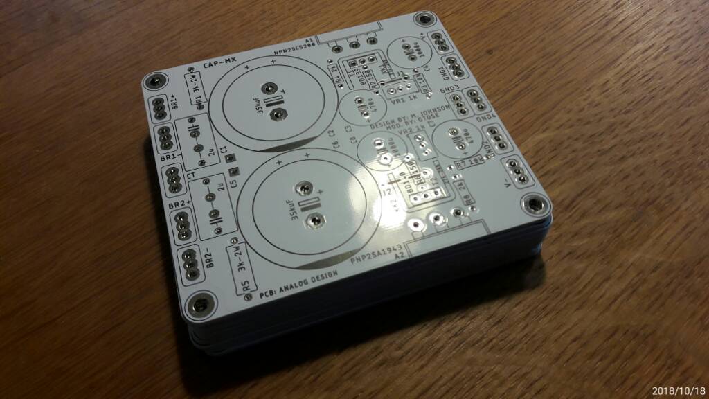

It could be due to jlcpcb software for / rendering of gerbers may be faulty or there is a bug in the online viewer.
I would believe manufactured PCBs rather than some online viewer.
Like I said before, gerberlogix is quite mature and gives correct view of layers. My experience.

Hi prasi,
this morning i received an email from Sophia, with the answer all is ok with your files. The bug must be on their online viewer, and internally they check the designs with gerbv 2.6.2.
Usually the offered online viewer from JLCPCB should work, because when sending files for production, i don't like to start discussion with them.
i like the straight way
Create files- check them, send them , produce PCB and receive PCB.
BR
Günni

Got some nice thingies today :) Thanks a lot the creators!
I have been fighting to get my boards through the JLCPCB review process. The first 2 attempts were rejected, because of the drill file. I first uploaded the gerber from post #512. The second time I changed the Drill file to .DRD and it still said that it needed a drill file. I uploaded X's gerber, but it said it needed the board size, so I entered 80mmx90mm. It took it, but will need to wait to see if it gets approved.
I really want to try these boards in my next build, a M2 and Alpha 20.
Aha, #YouToo? :D
here are the gerbers that have been zipped in a single folder. they look perfect in gerberlogix viewer as did earlier gerbers. Only a slight change with the way outline layer is generated.
If JLCPCB can't handle these gerbers, I would suggest to use some other boardhouse like, pcbway, elecrow, etc.
