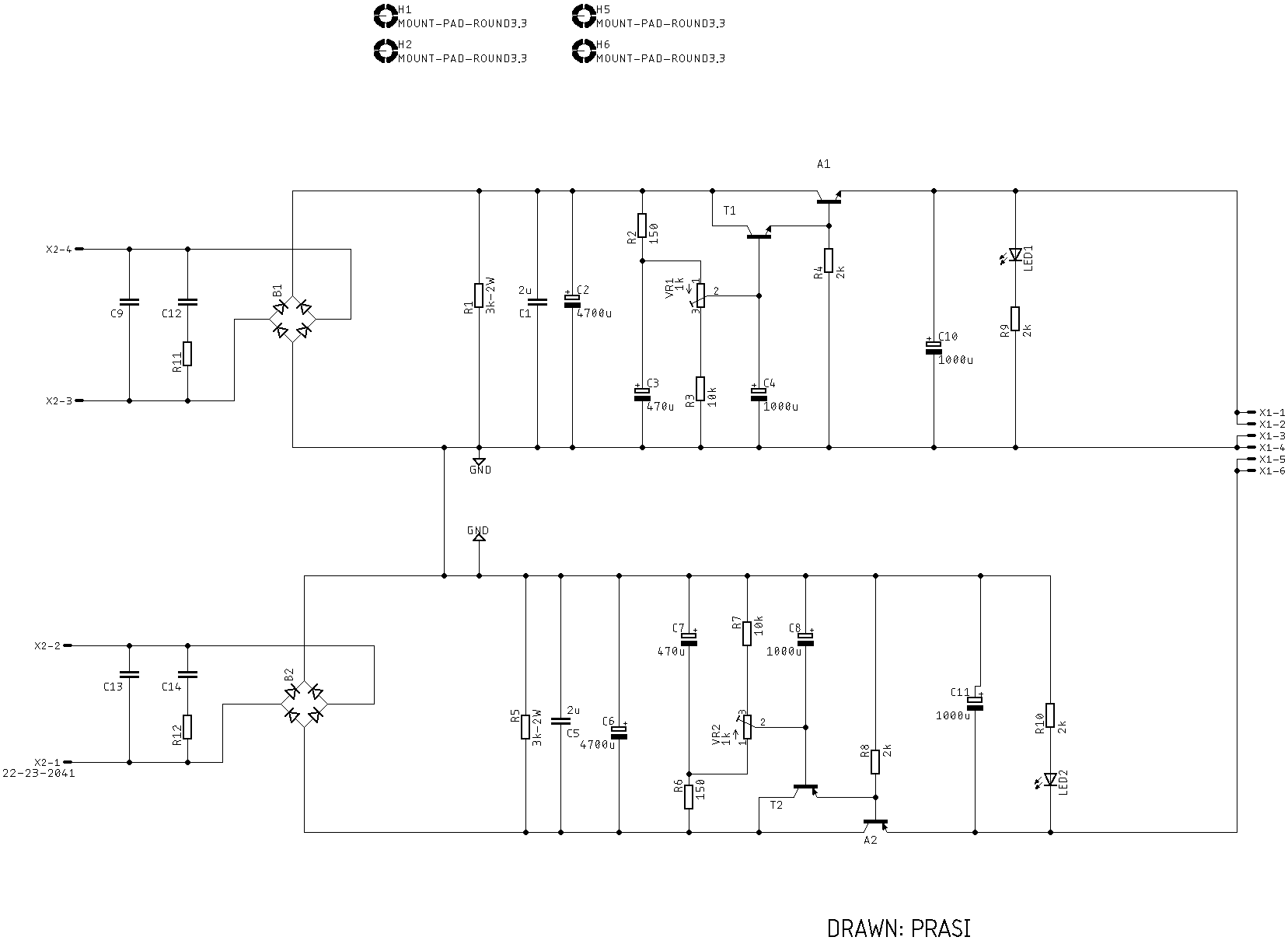

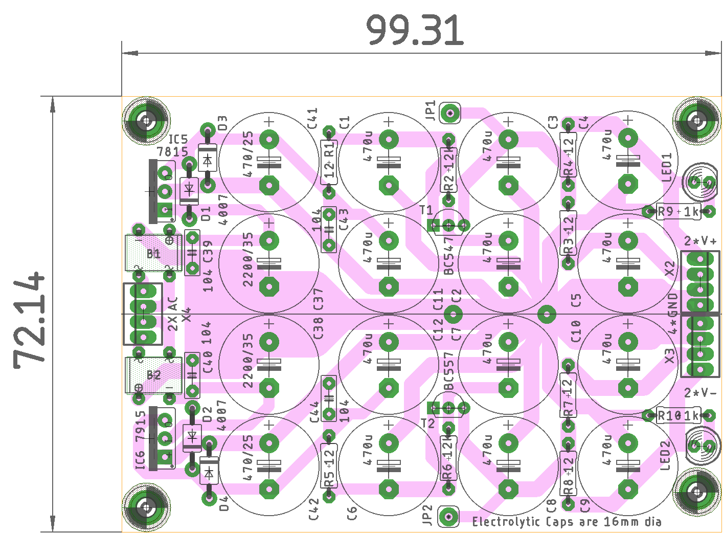

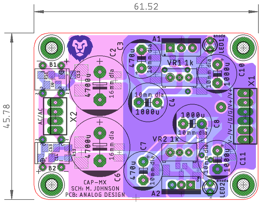

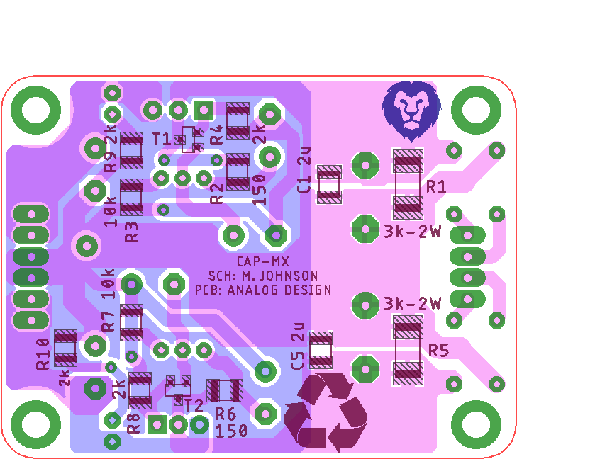

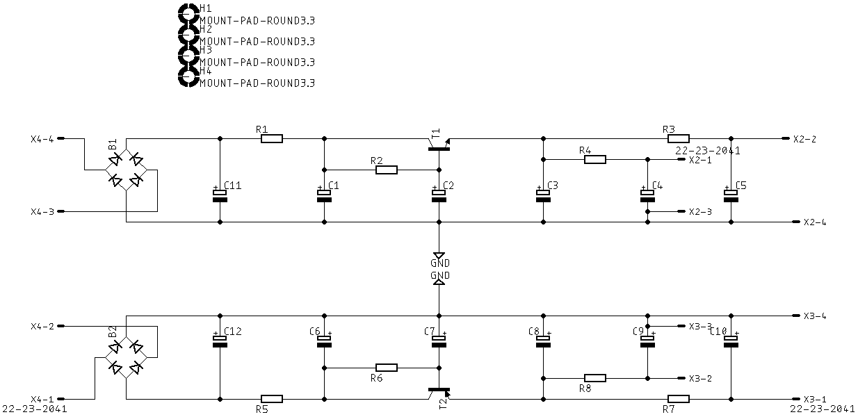

Here are the Gerbers for the small Mark Johnson/Gtose BJT cap multiplier by Prasi. Thank you, Prasi!
Design can use pinouts compatible with TO-220 using TIP41/42 and BC850/860 for SOT23’s. Small resistors are 1210 and 2512 for the cap bleed-off resistors.
Note that this is untested.

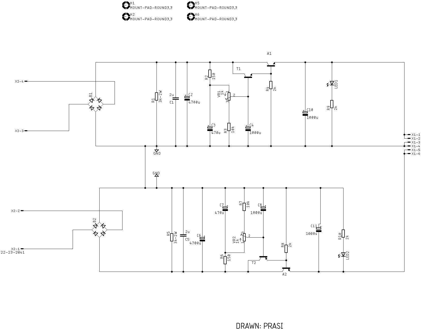

An update in the smd design...
The R1/R5 pads didnt have solder mask opening in the earlier gerber files as per post # 625.. it was brought to my notice by pcbway via the order placed by e_fortier.
Such great is their customer service and technical capability. They check each order very very carefully, no matter how small the order amount is.
Sorry for the omission, my mistake. So I am posting revised gerber files.
I have also added transformer snubbers for the ac, albeit its slightly cramped.
regards
Prasi

Be sure to check the emitters of T1 and T2 with an oscilloscope, looking for unwanted excess ripple when delivering the maximum permitted output current. This circuit's behavior gets worse and worse as you increase the output current, so: check it and double check it at MAX current.
You may need to adjust the values of R2 and R6 to find a compromise between (A: total voltage drop from in to out) and (B: ripple), that you can accept. Post #35 says more about this.
R2 = infinity gives the least ripple and the largest (total voltage drop from in to out)
R2 = zero gives the most ripple and the smallest (total voltage drop from in to out)

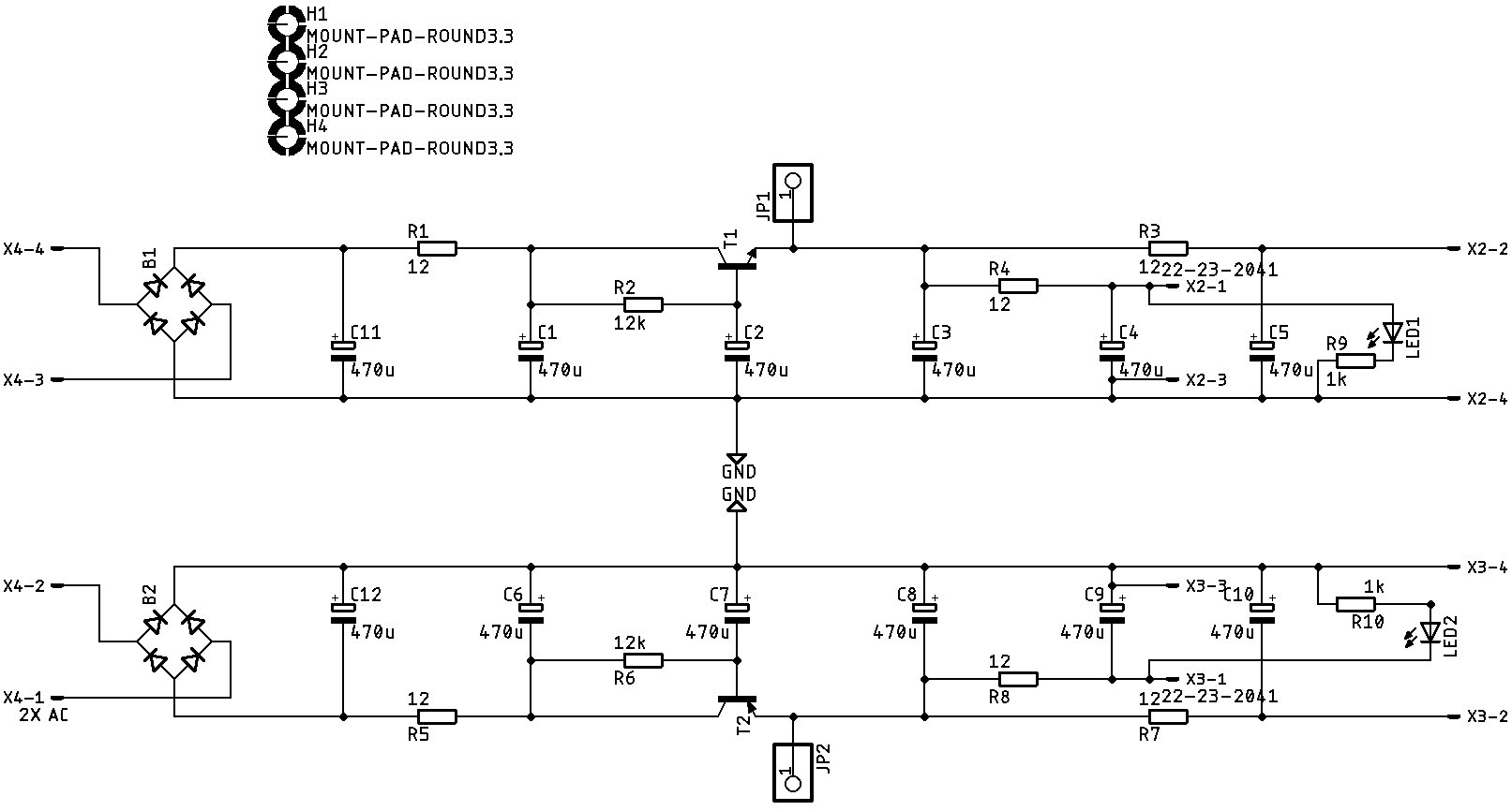

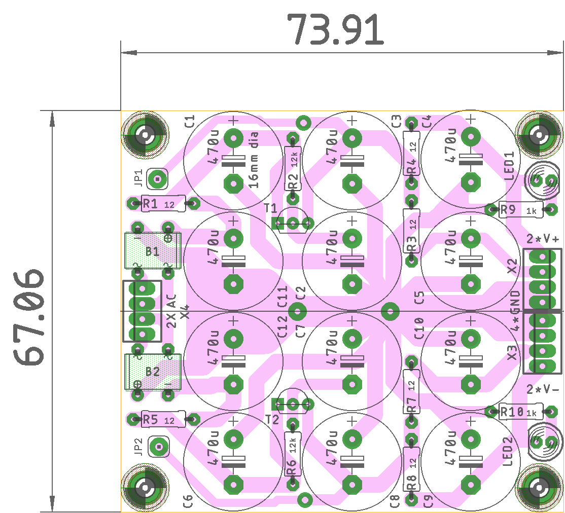

previously you mentioned that you were going to use the cap multiplier that you have beautifully developed for the Mofo powered with a SMPS.
I am in the same condition and I intend to adopt the result of your work. In a nutshell ..... introducing these cap multipliers have you noticed significant improvements in the sound?
Founder of XSA-Labs
Joined 2012
Biggest improvemt is lower dropout voltage so the BJT is more power efficient. However, you lose the nice 10 second long soft start voltage ramp up that prevents speaker turn on thump. The ripple reduction for both is about the same around -50dB. Jhofland has designed a new BJT version that uses a CFP (vs Darlington of the Gtose cap Mx) topology and should have even better ripple reduction performance and a slight 0.7 second ramp up time that just might be enough to prevent thump. I will be testing that design as soon as I order some test boards in the next few days.
