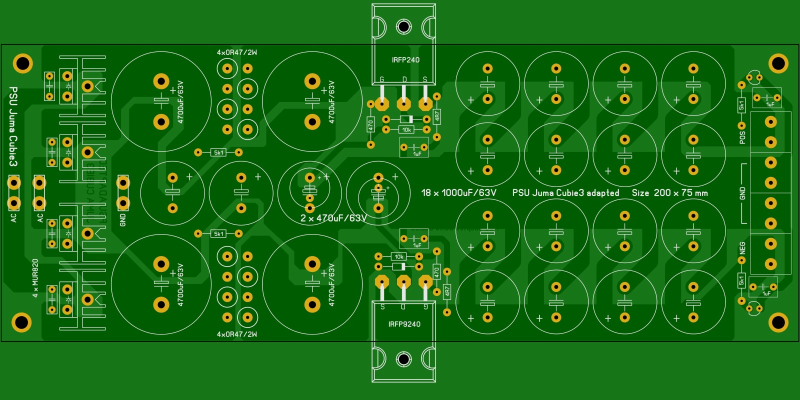

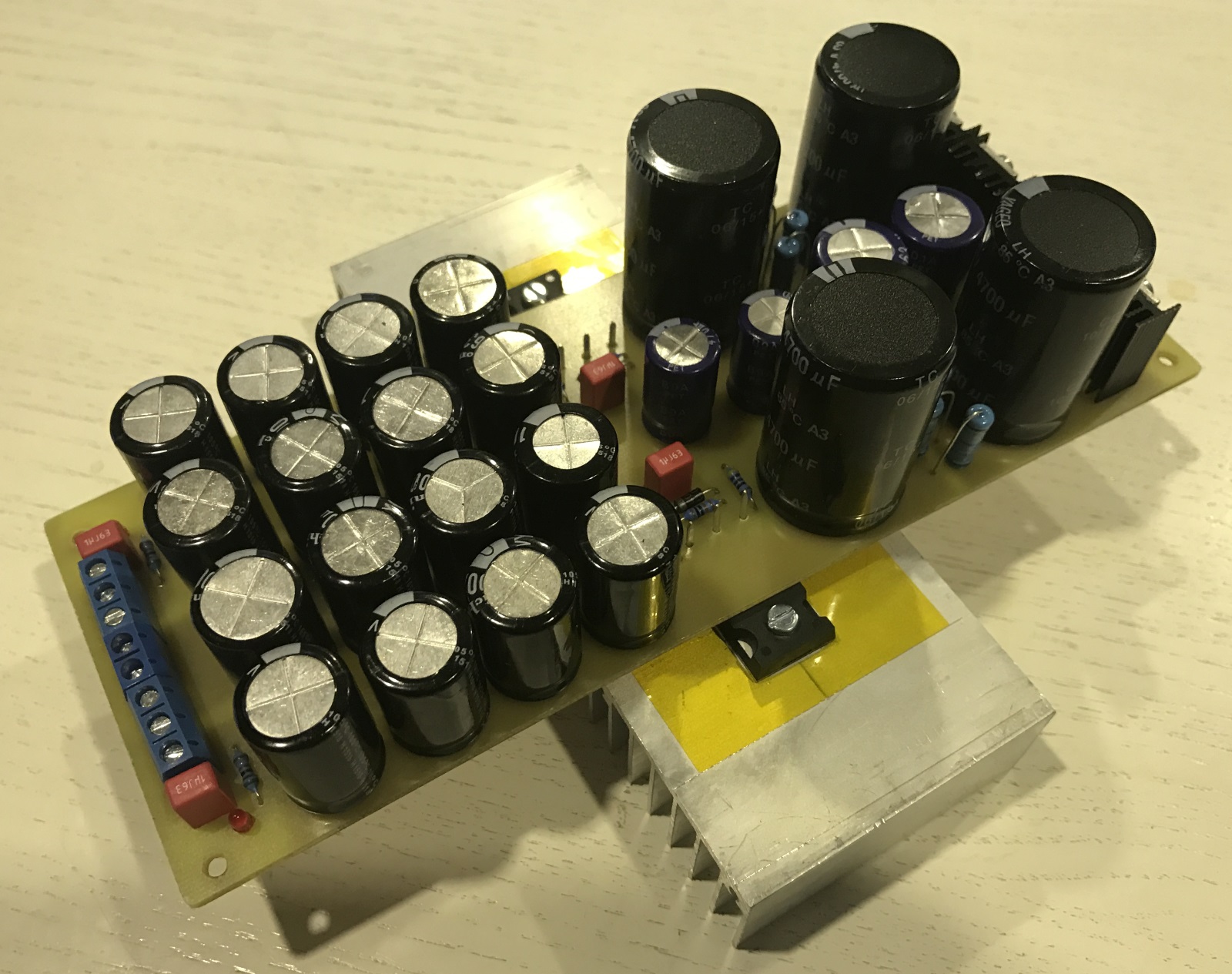

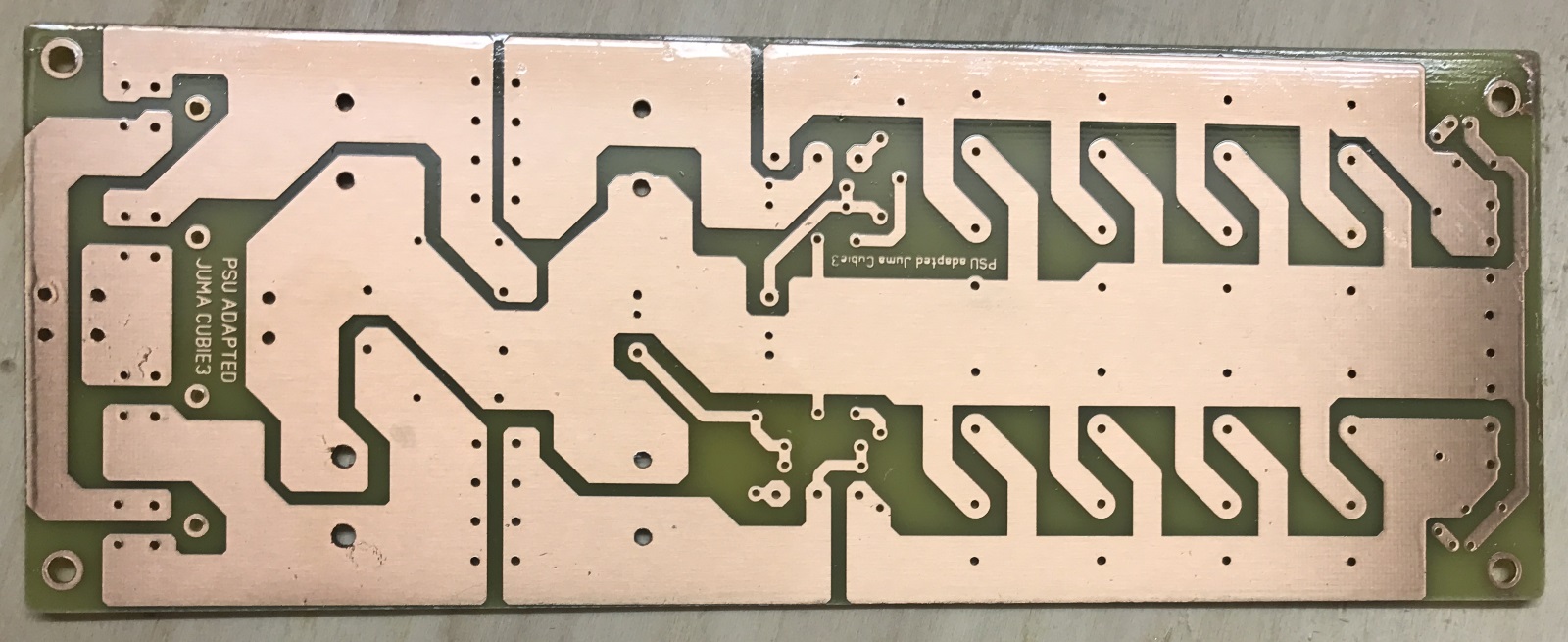

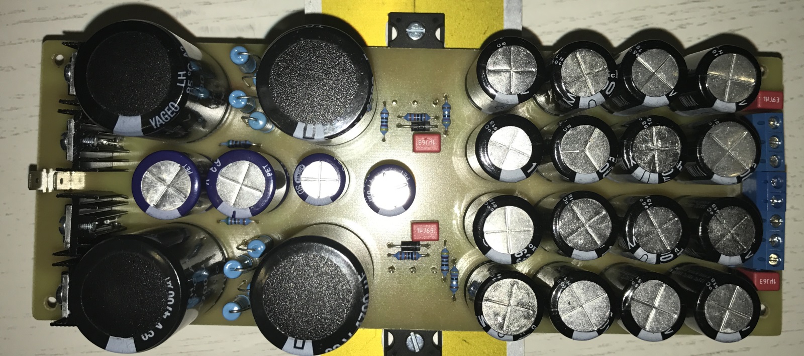

Hi, I have built a PSU free according to the Schematic which X has published in Post No. 95 with the parts I had on the shelf.
Will be tested next days or weekend. Looks good so far, not yet the optimal layout, but will developed. Just a few pictures for the entertainment
regards Olaf

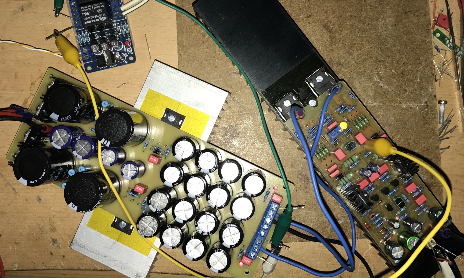

Hi, now I have built the second module with a few small changes. Great surprise - the measurements are the same (also AC on positive rail
). So everything with the Oszikkoskop checked - no AC
(will check my meter later). Soundcheck with an amplifier: Very nice! At least as good as with a regulated PSU (compared with Apex PSU for SR100), subjectively even better. Without a signal the loudspeaker is absolutely silent. No hum, no noise. 7 ... 8V drop is no problem with the result. I'm very satisfied.
Sprint file and PDF's will follow later.
regards Olaf
