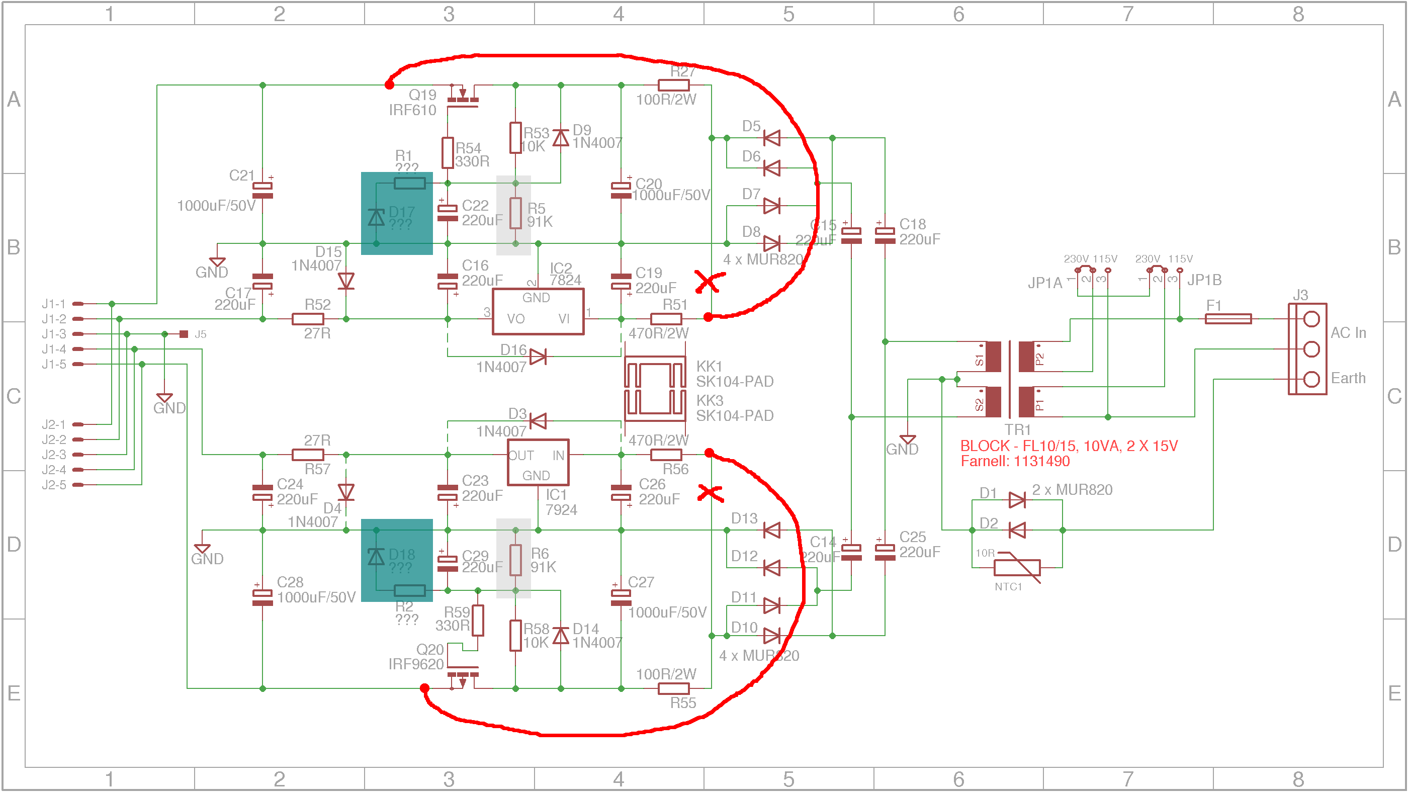

I tried to add actually two resistor to came down to +/-24 and +/-33V with 2x15V 10VA transformer. Check schematic below.
Dissipation of 2K resistor is around 500mW, and 240R around 1.3W.
Is this a special case or is this in general?

It's in general with small transformer with considerable no load voltage factor like models suggested in BOM. Before you connect single channel preamp PCB just check if you have around +/-33V for input stage and +/-24V for buffer section. Especially pay attention on -24V because if input voltage is over -40V it's possible that it cannot provide correct output voltage. I didn't notice that with positive regulator (7824) which is from another manufacturer.

Add a high value resistor in parallel to C22 and another parallel to C29, to get the cap multipliers working properly.
Try connecting the OUTPUT of the transistors Q19 & Q20 to the input resistors, R51 & R56, to feed a lower and smoothed voltage into the regulators.

How much, in tens or hundreds of kohms, in mohms?
I don't understand this. You mean some resistor, or resistor voltage divider? Could that also help that 24V regulators have below 40V on inputs?

For R53 = 10k try the extra R=90k (actually 91k)How much, in tens or hundreds of kohms, in mohms?
The voltage on the capacitor will be ~90% (91k/[91k+10k]) of the average voltage at the input.
The output voltage will be capacitor voltage minus Vgs of the pass device.
With the larger Vds, the Vgs will vary less with changes in current demand.
This is the big difference between a proper capacitor multiplier and the version in post200.
You can change R53 to any value, to vary the percentage of the input voltage that appears on the capacitor. anywhere from 50% to 99% would be experimental values. Try to stay between 80% and 95% for usable multiplier.
If the pass device is a BJT, the base current has to pass through R53. It must be a much lower value. Try 1k : 10k for a 91%, if the power dissipation is OK.

Tested with approx 90K and it seems like right value with my 2x15V 10VA transformer and two channel connected on single PS board. For one channel that value probably should be much less (40-50K).

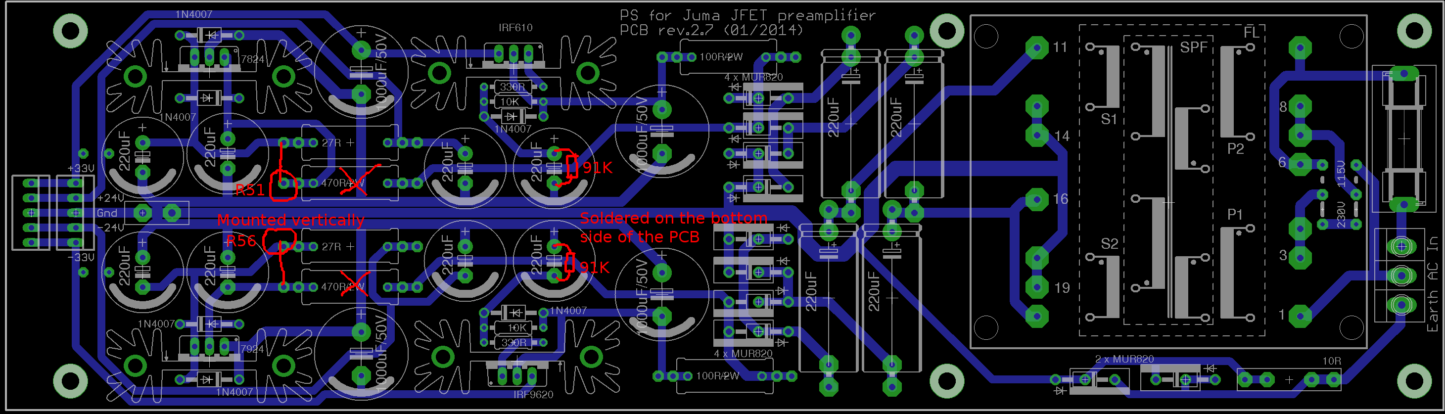

This is also an elegant solution since you just need to solder that resistor on bottom side of the PCB directly to the capacitor pins (C22 and C29). Thanks for this suggestion.
Use the output of the multiplier to feed the regulator.
Oh, now I see. I didn't try that since that will require more surgery on the PCB

Just link the resistor across the two pads.
omitting the resistor in the input to ground series ladder destroys the capacitance multiplier.Tested with approx 90K and it seems like right value with my 2x15V 10VA transformer and two channel connected on single PS board. For one channel that value probably should be much less (40-50K).

Use the tapping point between the two series resistors to define the base/gate voltage of the pass device.
You can also add yet another resistor+diode across that capacitor.
This converts the simple multiplier into a (soft) regulator, if the input voltage goes too high. Experiment with resistor and Zener values to see what can be achieved. I did a spreadsheet way back last century to make the calculations quickly.

I'm enclosing proposed corrections as you suggested (and if I understood you correctly). I didn't add extra R+Zener in parallel with C22, C29 on the PCB drawing (components shaded green on schematic).
