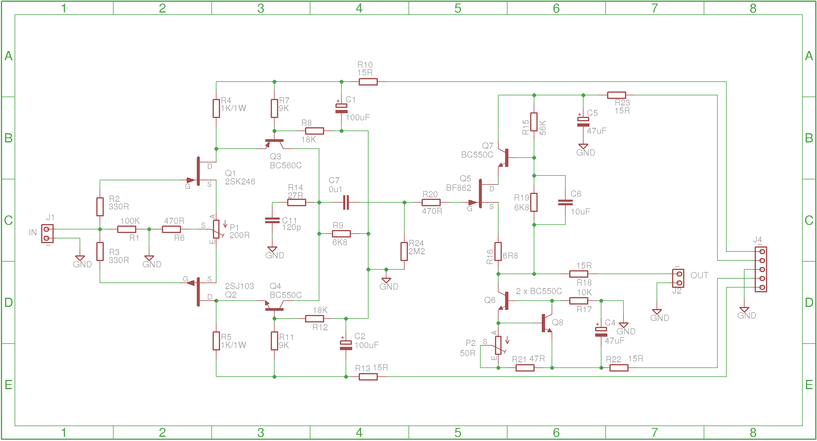

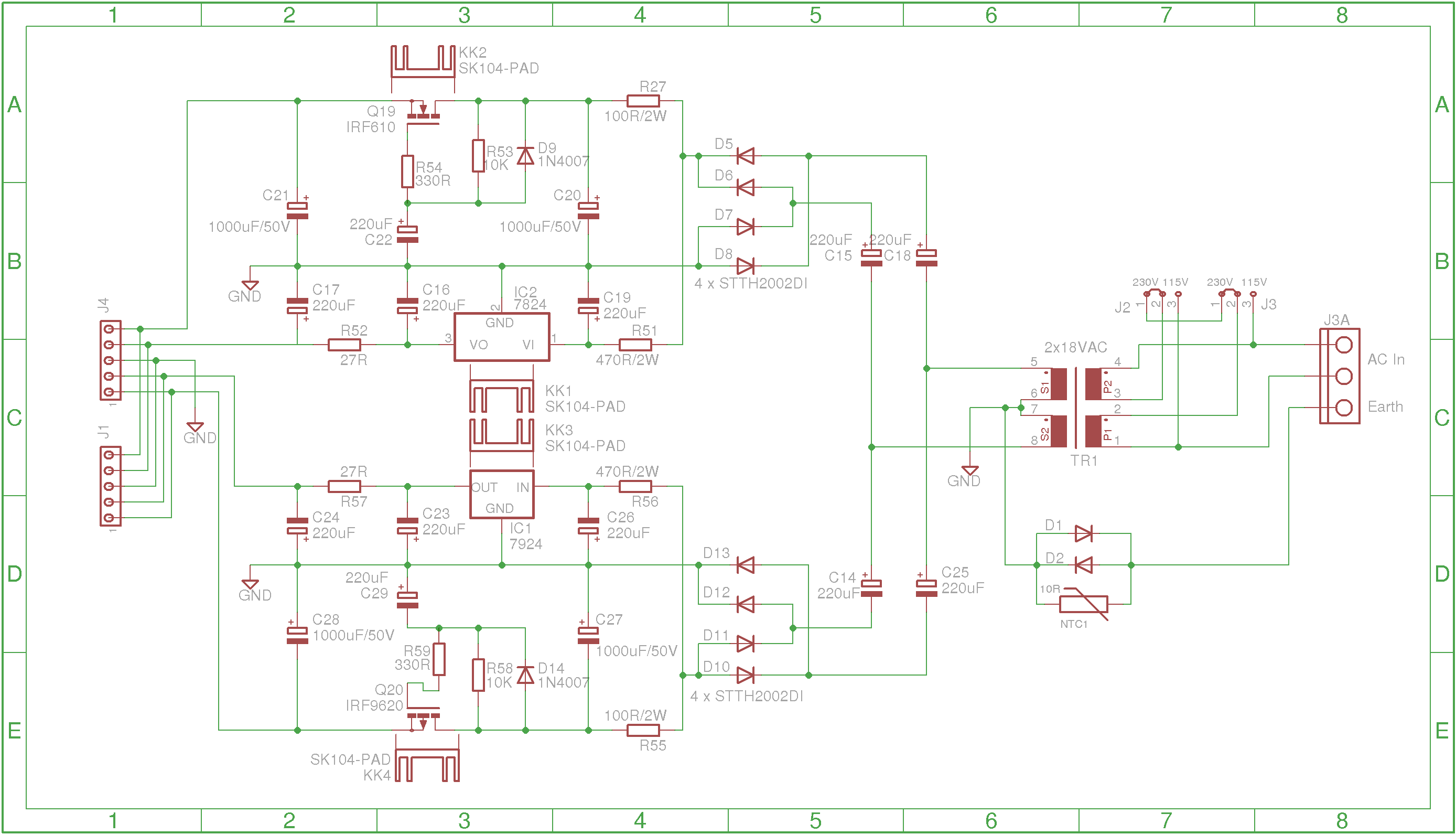

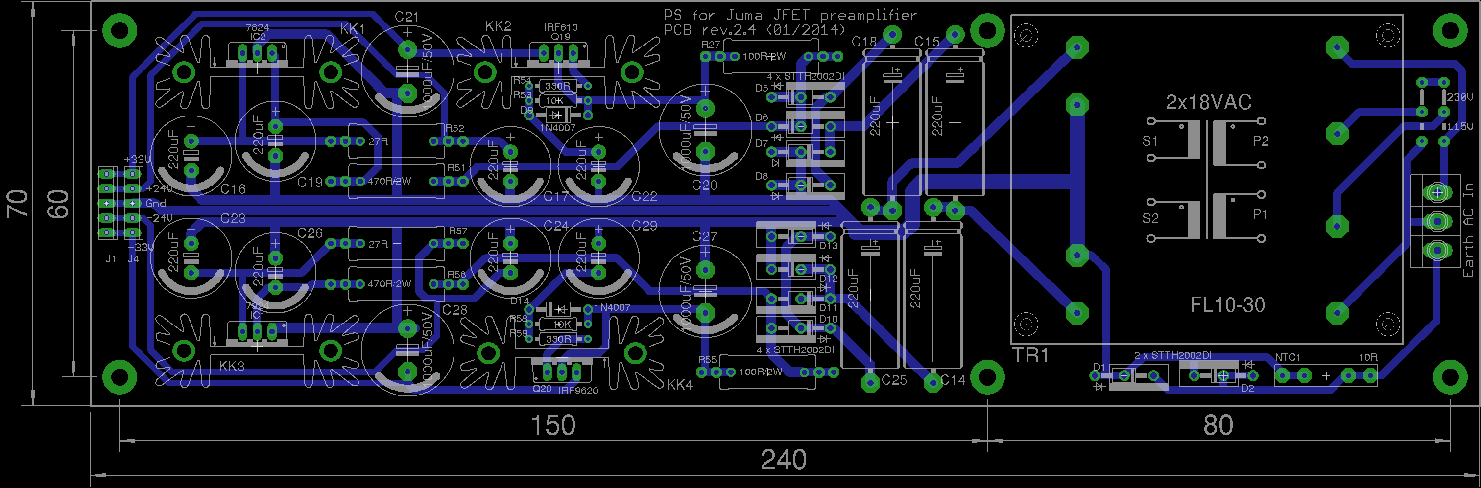

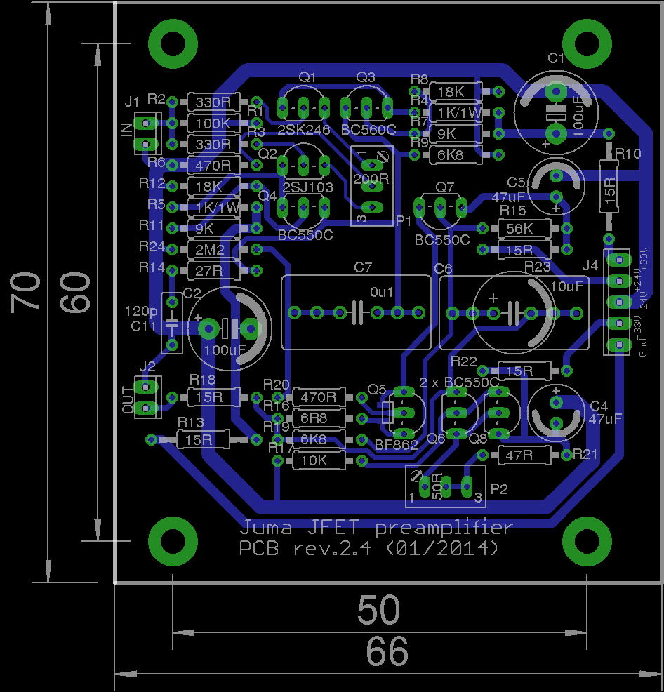

Ok, I remove PS from single channel preamp and add transformer (two primary to address both 115V and 230V regions). I'm not very satisfied with open jumpers for selecting AC voltage so if someone have better idea, please let me know. This layout make obsolete previous single channel version. Dual channel version with PS (without transformer is still actual).

Will the single jfet preamp board be available seperately?
Would it be possible to turn IC2 and Q19, Q20 around to allow them to be screwed to the chassis -- or onto a heatsink "power amp style"? Is IC1 close enough to the side of the board to allow such mounting?

Yes, that's idea, but in pairs.
Hm, hardly possible without introducing jumpers. From other side that heatsinks is not mandatory, Juma said that he do not use it.
Hi prasimax,
a fuse on the transformer primary side ?
Br Walter
There is no room for it, but that give me idea to move voltage selection beneath transformer which is much safer then in current version. Then we'll have enough room for PCB mounted fuse holder with isolation cap.
I forget , possible too use 1000uF/40V for C14 -15 C18 and C24 ?

if seperate power supply board, I suppose preamp will be one stereo board ?
Yes and no, what if someone still want one PS per channel?
I meant seperate stereo preamp curcuit only, without power supply
but maybe I should have said 2x mono
which reminds me
mono power supply boards could also be 'dual', side by side, and breakable
and if some one only want one supply board, you just break one before delivery
but not sure how much different they calculate prices when breakable
so basicly, what I suggest is one preamp board with 2 channels(without power supply)
and one breakable power supply board, with dual mono power supply
In the BOM list you recommended pacificsemi.com to order Toshiba 2SJ74V or 2SK170V TO92-FET. I can tell you there can only selling fakes! I order 2 years ago big QTY all are BJTs , i guess there learn Aafand some guys still remember him?
Huh, this does not sound good
![headbash :headbash: :headbash:](https://files.diyaudio.com/forums/images/smilies/headbash.gif)
Yes, I put pacificsemi since I found there required jfet. Do you have any other source to recommend?
