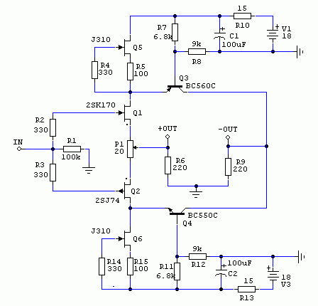

Prasimix,
I intend to use the circuit as a phase splitter at the input to bridge tied amps. I was to use the attached schematic which Juma published on F4 thread . I did not see the CCSs in your schematic, only the simpler resistor solution there.
>Is there a chance you could still provide that option on your pcbs (J310s)? I would much appreciate it. If so, I would be interested in 4 mono (single) versions. postage to ON, Canada.
p.s. I assume there is also a neat way to jump the buffer if not needed?

Hi koja, do you think that additional fets should be mandatory or just optional if someone wants to use it as phase splitter?

Prasimix, those are not limited to phase splitter use. everybody would benefit from them. this is if one does not mind matching the CCS transistors (they need to be matched). if someone does find that inconvenient, they can always opt to leave them out and go with a simple resistor.

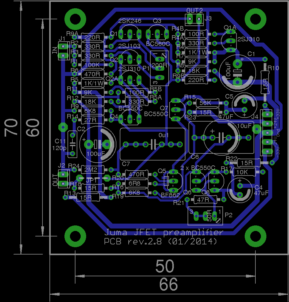

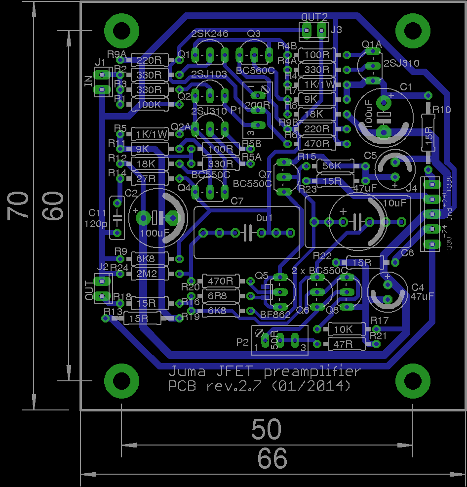

Yes, prasimix, that looking "more separated"! (for want of a better term!)
Had a bit of another look at your single gain stage version pcb again -
You know what, despite my reluctance, I'd be a bit inclined to simply run a copper link from near the centre pin of the J4 strip across the board to adjacent the R24 ground track point - could run the link underneath with an insulated sleeve, etc (replaces that long signal gnd track right around the outside)
Now, the last thing I'd like to see is the three ends of R12, R8 and R9 all together (I think R9 better going to a 'power gnd' rather than 'signal gnd', despite my earlier suggestion - sorry) to a clean GND point - let's see ..
Now that R24 is out of the way and R14 is closer to the Q4 and R9, it might be possible to move R12 directly below that same Q4 and get the neg rail to it by turning the C2 around 180* and slipping that GND track between the R13 if you lower it a bit ...
Don't know if you can tie the ends together to R8, R9 and a clean GND point - I've suddenly lost the plot a bit here, but it does seem 'do-able'! Again, not sure if it will make any difference at all, but I 'have a feeling' (!) that it will!
Oh, can move that R24 down below the C11 and move the C2 up a bit to make room (or move J2 and R18 down a bit) - while you're in that area, you can move the R14 towards the centre of the board above C7 and move C11 to be horizontal - gets a bit more room to play with a reduces stray currents around this area a bit, IMO.
jameshillj, I move R9 down close to out connector and connect it instead of power gnd to signal gnd where I think it belongs. If that is wrong we can simply connect it again to power gnd. R24 is also now closer to out connector.

Koja, please check schematic. I marked CCS and output section which is terminated on OUT2 connector. Personally I don't like its place on PCB but that's only what I find that is close to board edge. Maybe there is another possibility to put it somewhere above Q7 in the middle of the PCB. If someone wants to "jump the buffer" he need to put jumper on R9A position and use OUT2 connector. Another possibility is to introduce place for the jumper to use OUT connector.
If new changes is ok, I can try to add it in dual channel layout together with jameshillj suggestion for moving main gnd point.

It's getting quite crowded in there Prasimix!
I hope you don't mind my 'spouting off' about your pcb design - rev.2.6 and rev.2.7 are coming along nicely, IMO.
If you don't mind a bit more 'nit-picking' ....
I would shift R6 back over to it's old position below R1 and just use the extra length of the resistor lead to jump across to the pot P1 mid pin - maybe a bit of sleeve, and simple!
I do like the new position of R9 - you could maybe move it up between R12 and R14 to gain a bit of room and reduce tracking - not much in it tho.
If you move R22 to the right and connect it to the -24 volt pin of J4 outside of the -33v track, this allows you to straighten the track to C4 and you could move R17 up below R22 - this gives a bit more room to shift R21 to the right and makes the tracks to P2a bit simpler - will need to move those transistor down a bit and this also allows room to move R19 above Q5.
That's about it - perhaps you might add a single donut near the 0volt pin of the J4 and another one near the grd track adjacent C11 for me, if you would (for a direct copper link across the board!) ....

I like simple circuits and as it seems that the LSKpre will work just fine with the F5 without buffer, I will go this route. The more simple this "buffer bypass" can be done, the better (for me):)
Added room for JP1 close to OUT connector.

Not at all! Please just continue with your effort. I'd like at the end to have better solution and your and other members suggestions is more then welcome.
I think that we have now almost everything on right place. :)
The caps C6 and C7 are about 9 x 18mm, yes? What type of caps did you have in mind for these?
Please check attached BOM. I found one 10uF small enough.

If that is more or less everything for single channel layout, I can try to do the same on the dual channel and also publish latest revision of PS.
