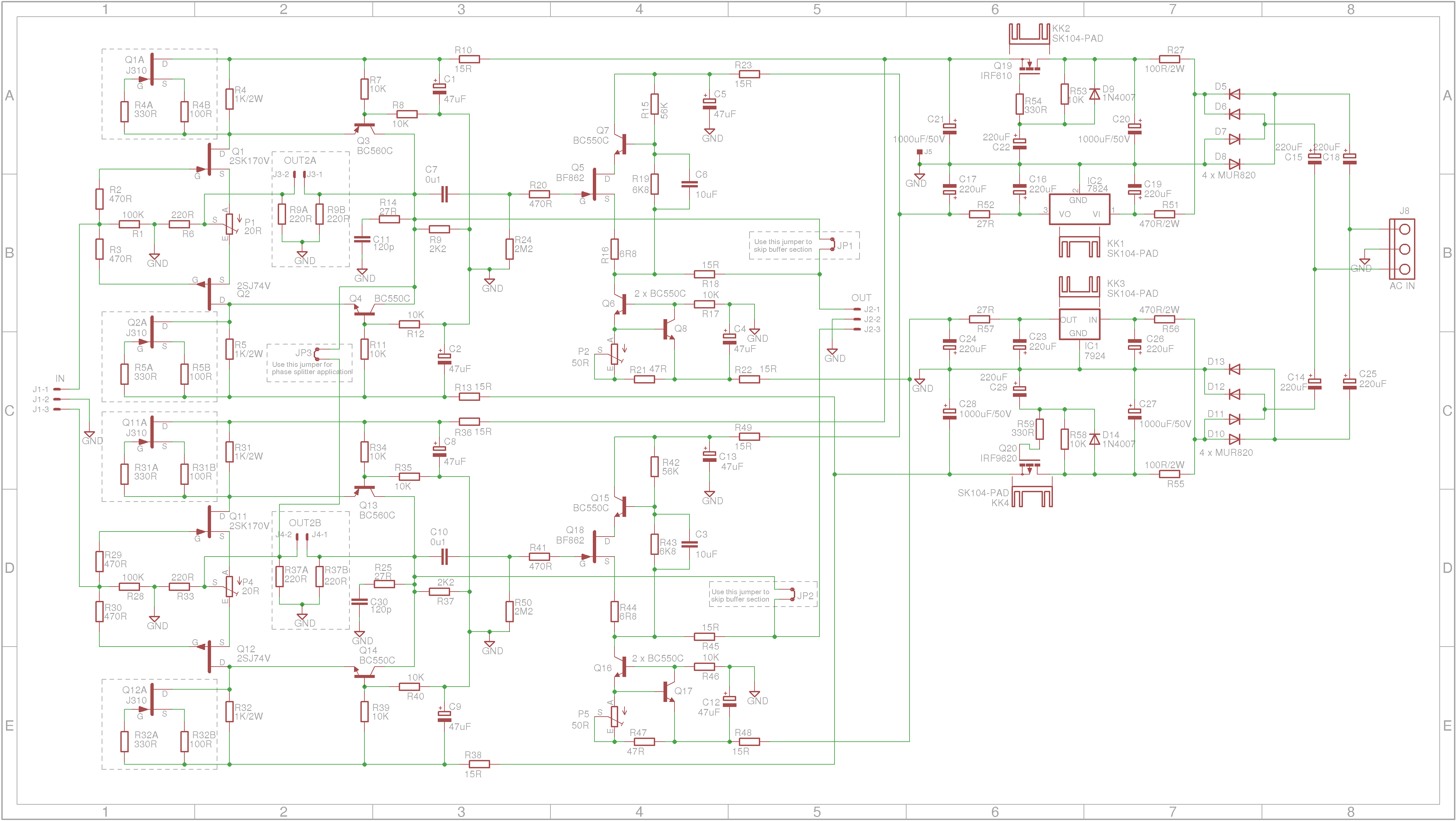

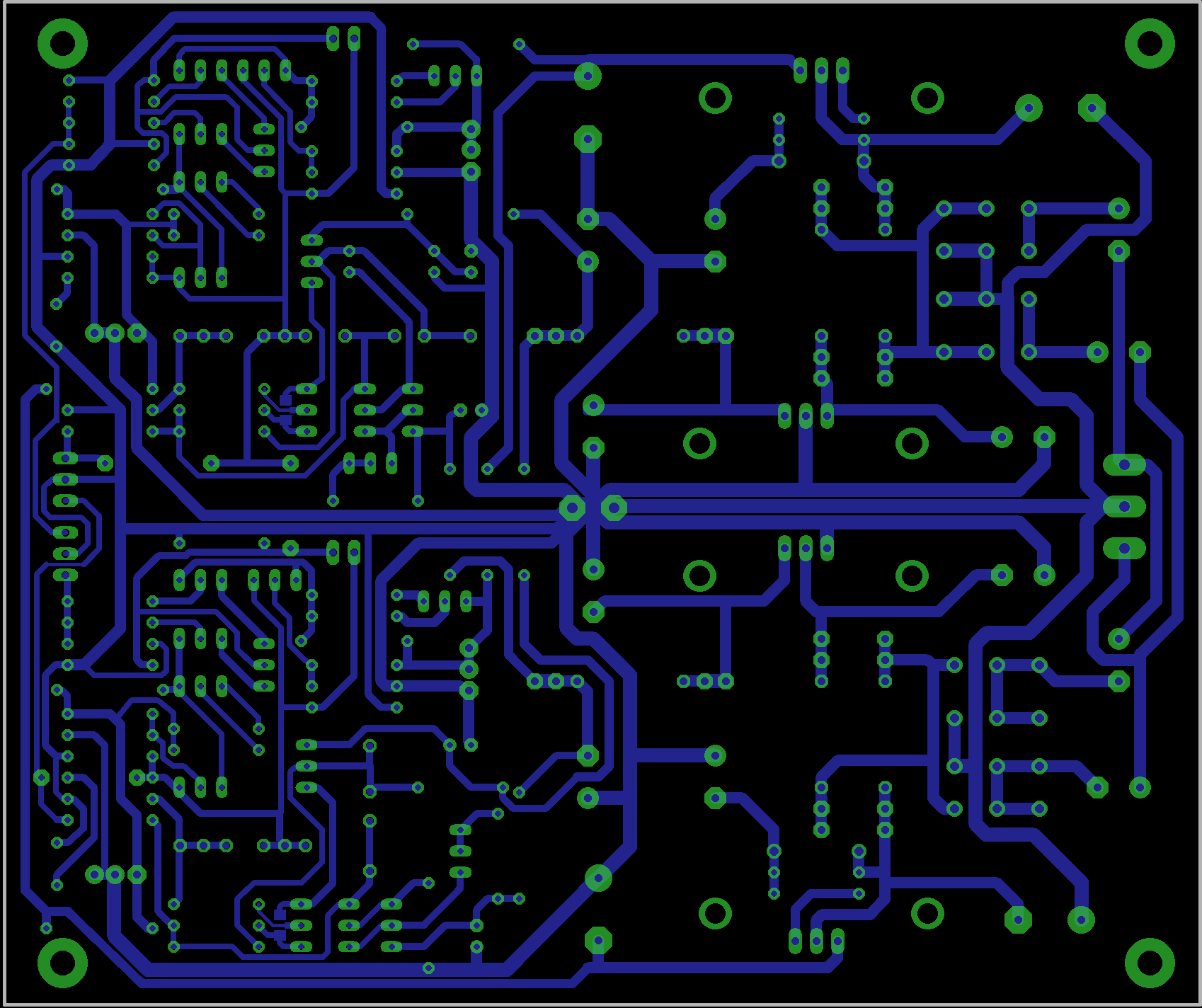

Prasimix,
since you know I will use the board to bridge amps I wanted to throw in an added explanation: I will likely use one LSK channel as the phase splitter, then take Out+ and Out- signals each to its own buffer (so one LSK channel followed by two buffers). Can you please check if the board provides for a reasonably neat way to make this connection? thanks.
p.s.> btw I am likely to take 5 dual channel (stereo version) boards. Thanks. (this is up from 3 which i said last time
Prasimix,
Prasimix,
p.s.> btw I am likely to take 5 dual channel (stereo version) boards. Thanks. (this is up from 3 which i said last time.
I think that could be a very simple task. Let's assume that you'll use "upper" channel from your dual channel PCB as phase splitter (schematic in post #89). "Upper" buffer is already connected to one half of the splitter. Another half you can bring to other buffer from OUT2A pin #1 to OUT2B pin #2. That's all.
EDIT: On existing dual channel PCB it's possible to introduce one optional jumper to make above mentioned connection.

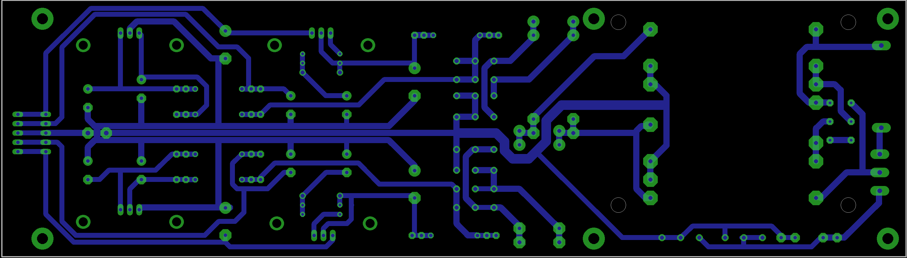

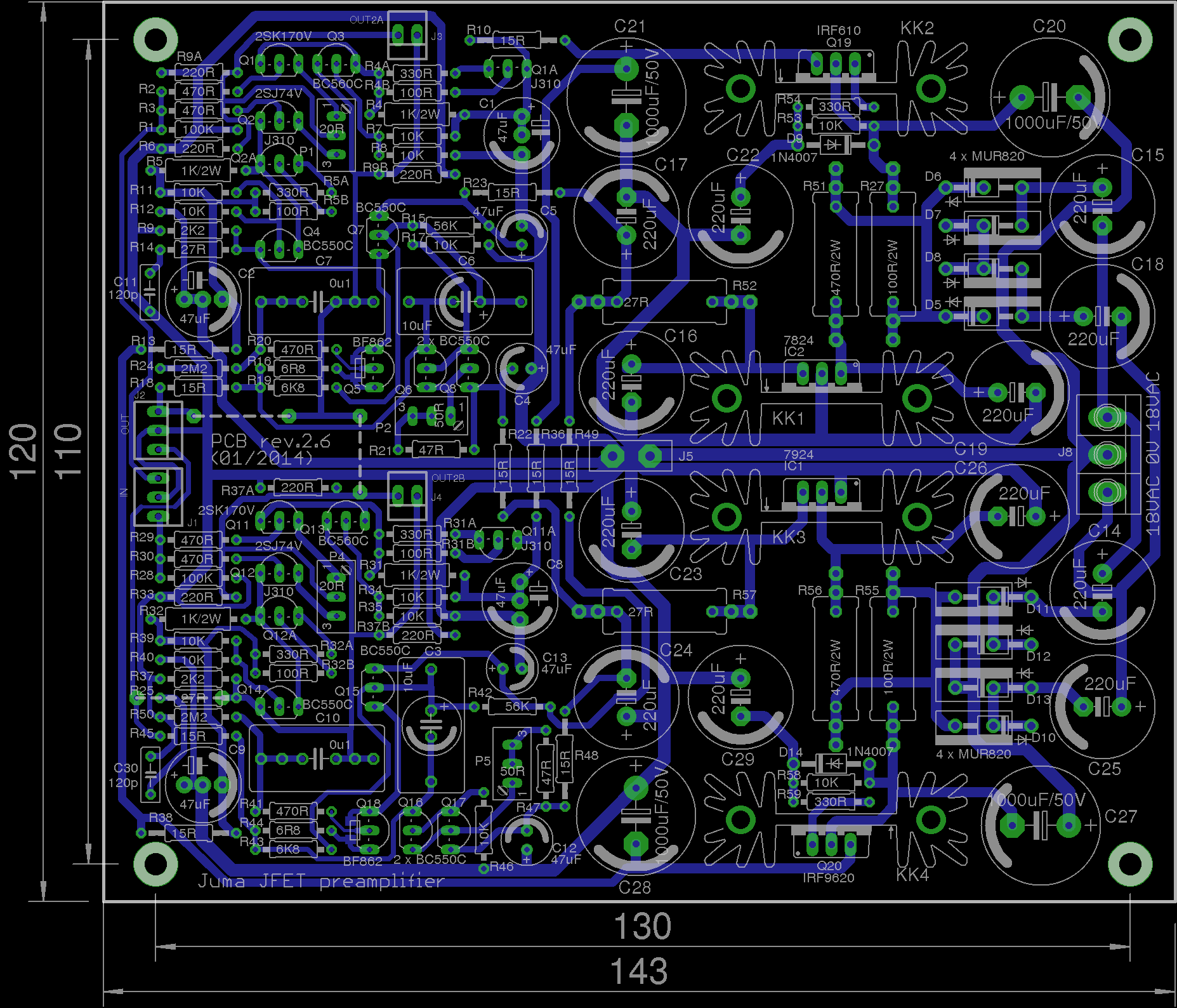

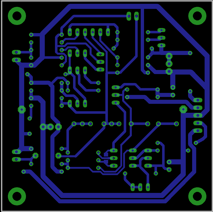

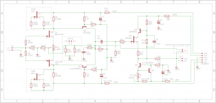

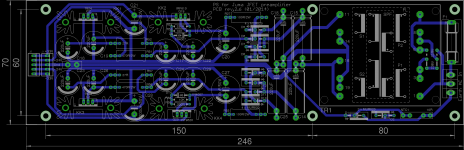

Here is I hope the final layouts of all three PCBs. I'll leave then for couple of days and if nothing new is popped up, I think that's the time for send it to the production.

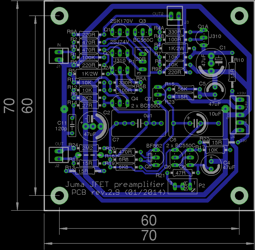

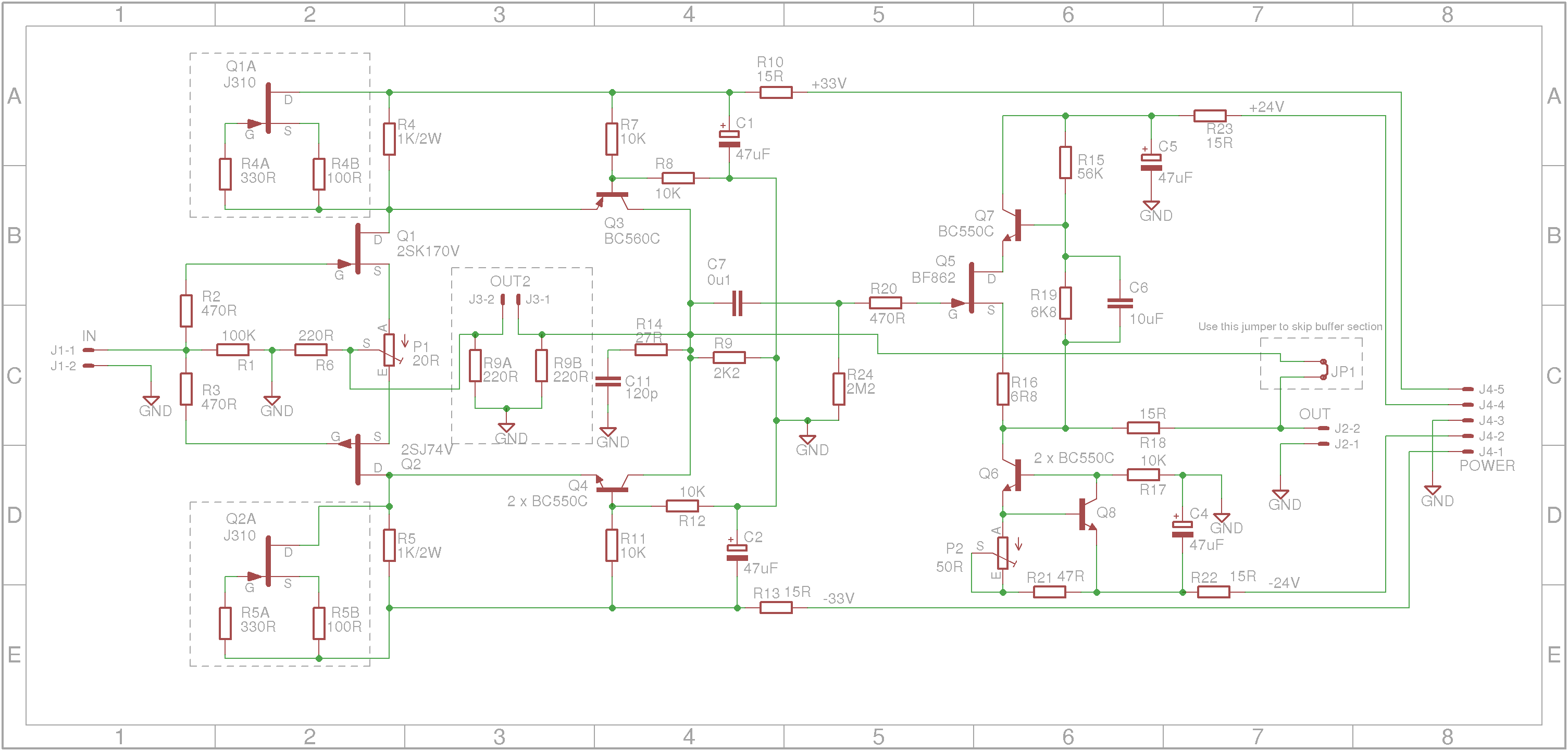

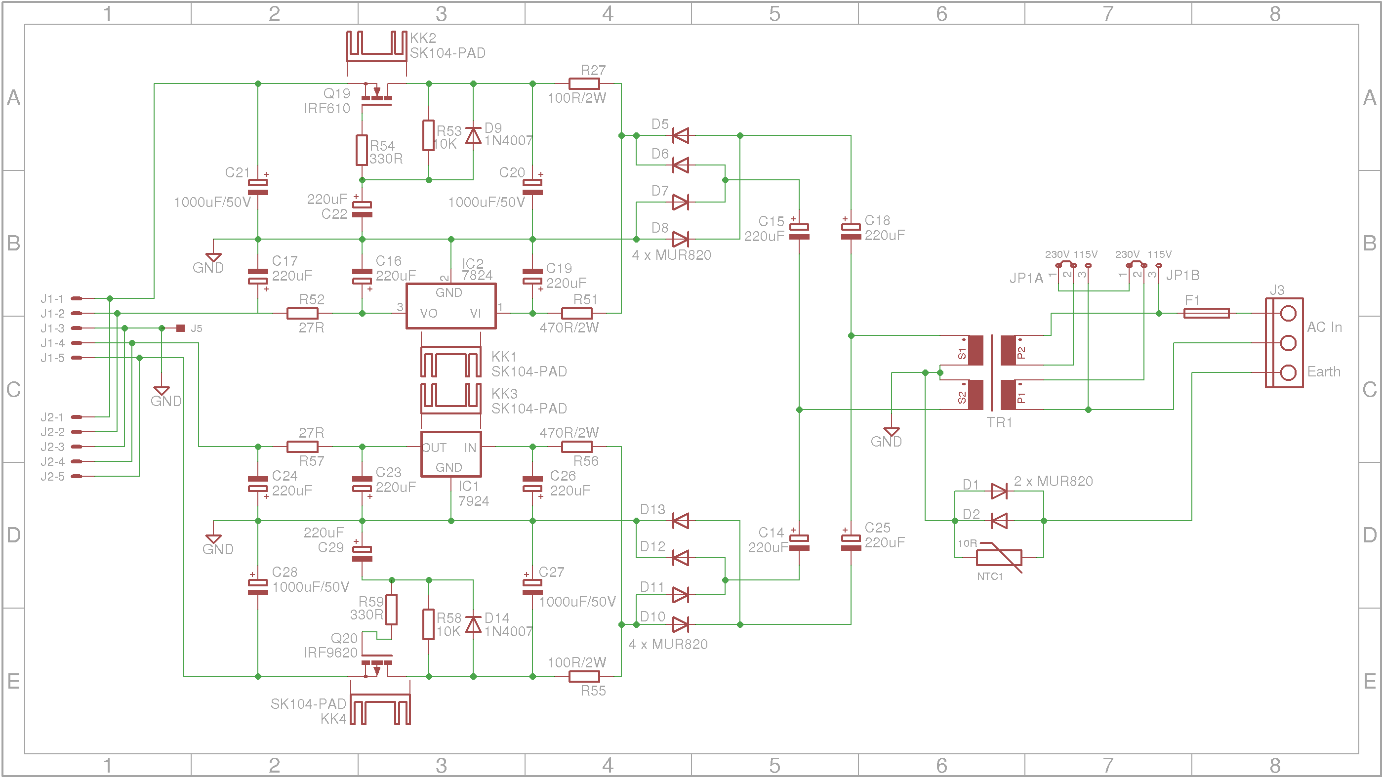

I was curious to see that you have sorted out the sizes of the pcbs so that 2 of the gain stage pcbs can fit on top/below the single power supply board - might need a bit of a bracket for the mounting holes near the vertical IRF610/9610 heatsinks, but not very difficult - very neat bit of design.
I know it's a bit late in the day for any more mods but perhaps, as there is mains power on the board anyway, that perhaps it could be possible to extend the end of the board to include a series NTC in the mains input active line - keeps things a lot simpler for mains wiring.
I won't say anything more about extras but the inclusion of a mains dc trap comes to mind altho the primary winding impedance makes it nearly unnecessary (again, IMO).
Tried to add it but there is simply no more space for it, sorry.
