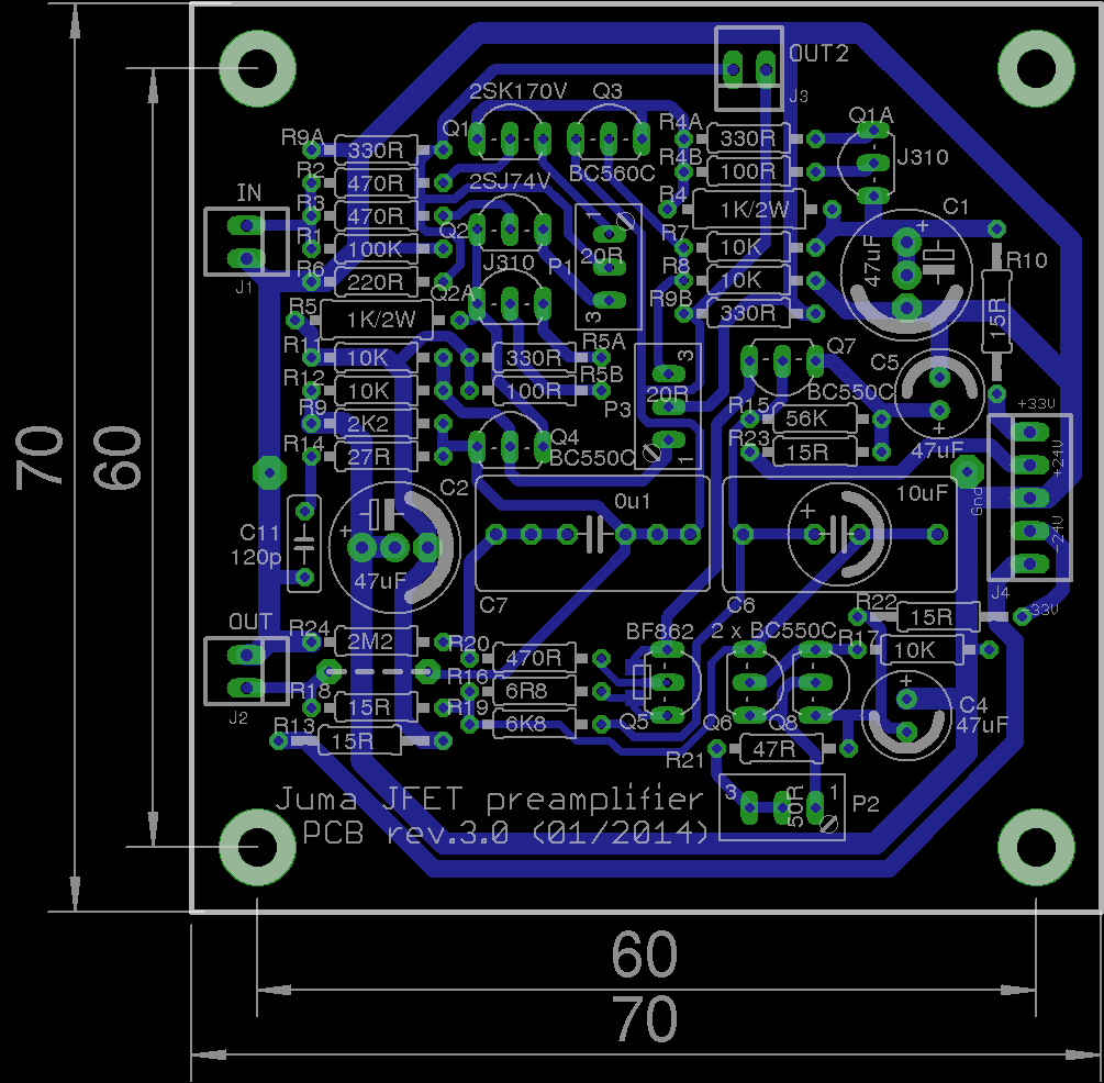

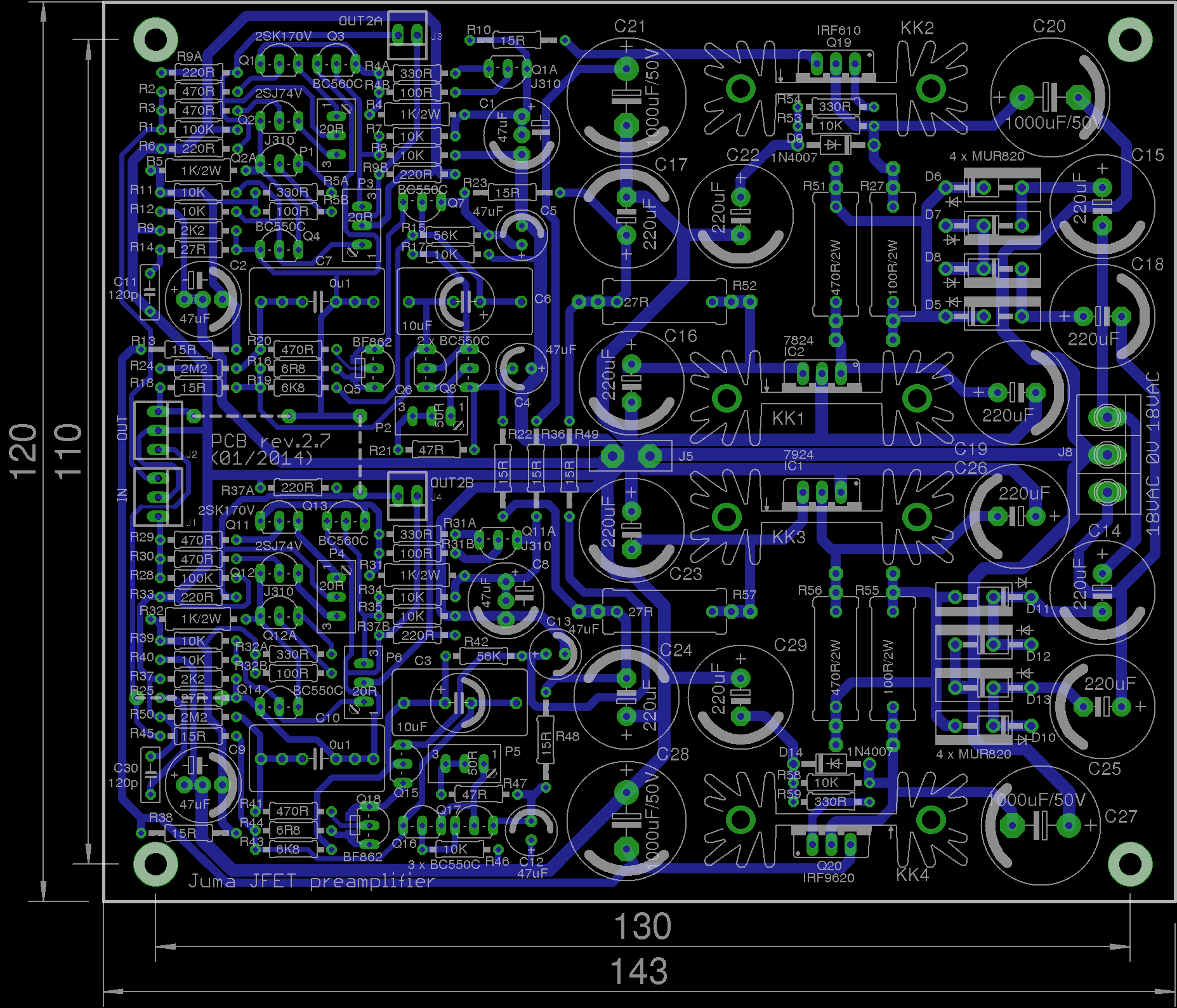

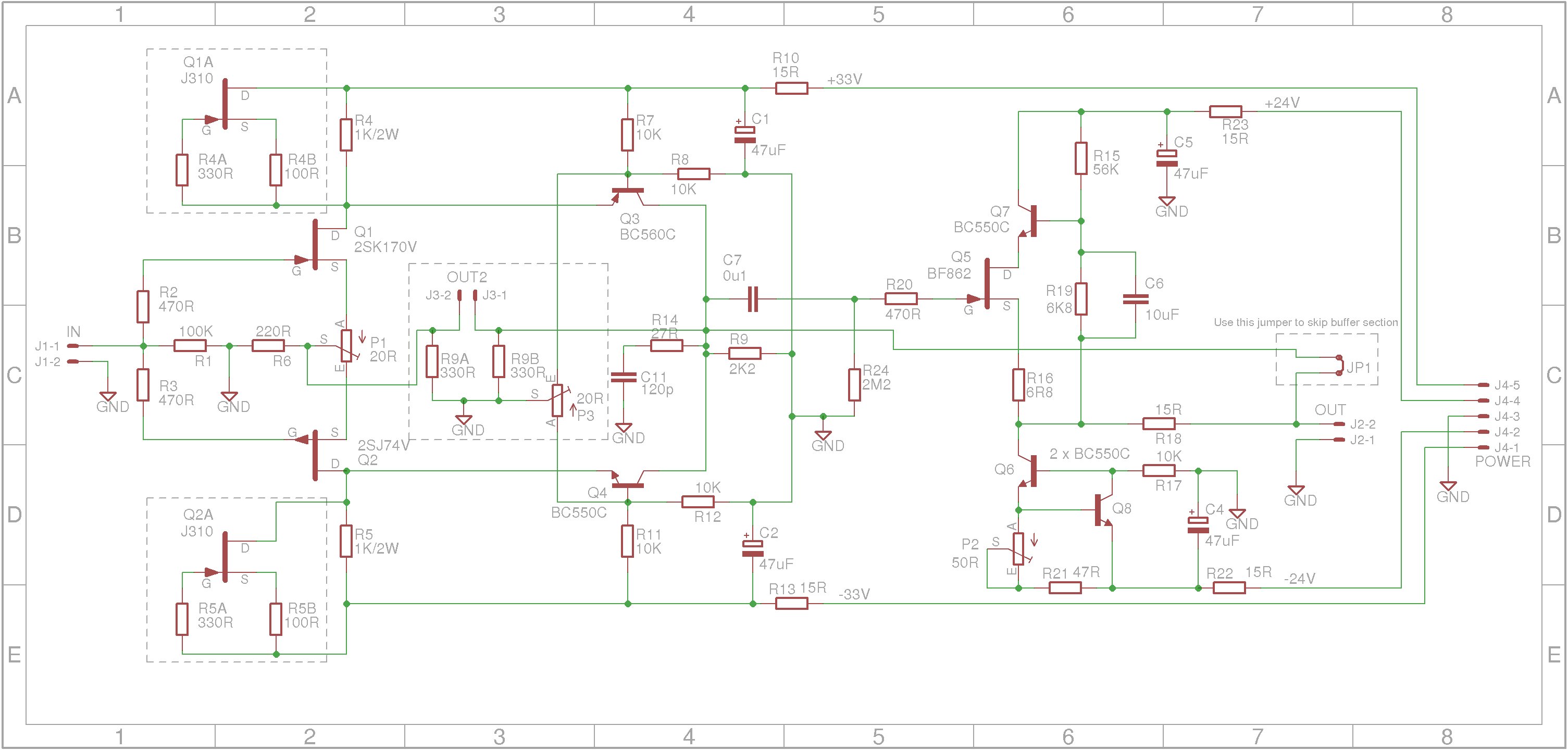

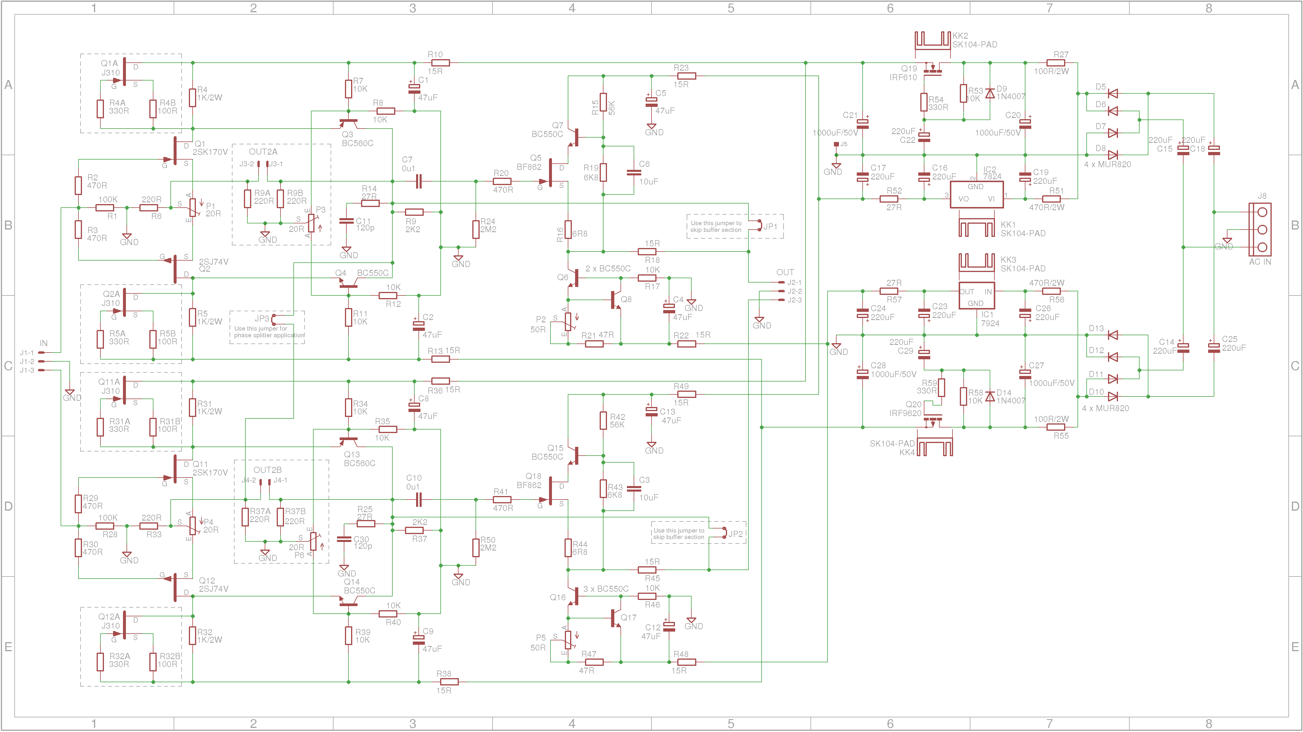

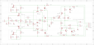

Please find latest revision that include few small changes in accordance with Juma's suggestion for Phase splitter for Koja and others that wants to use PCB for such purpose (PS for single channel boards is not changed, so the latest revision can be found in post #103).
In Monday I'm going to production. Thanks everyone for payment and hope that I didn't missed anyone who already paid when filled out column 'Confirmed' in Zoho sheet.

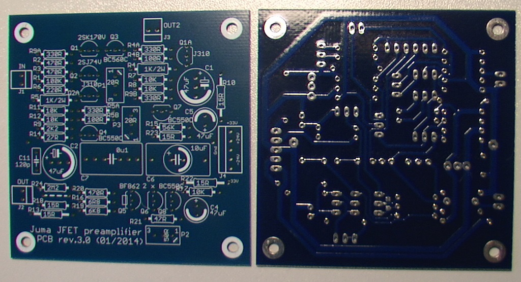

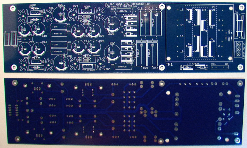

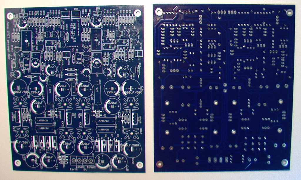

PCBs arrived as scheduled. I tried to make some pictures of them just that you got some idea how they look like.
I'll try to organize shipment in following days and inform you about progress.
Please note that I succeed in adding ground loop breaker on dual PCB in the last minute (as suggested jameshillj in post #106).
