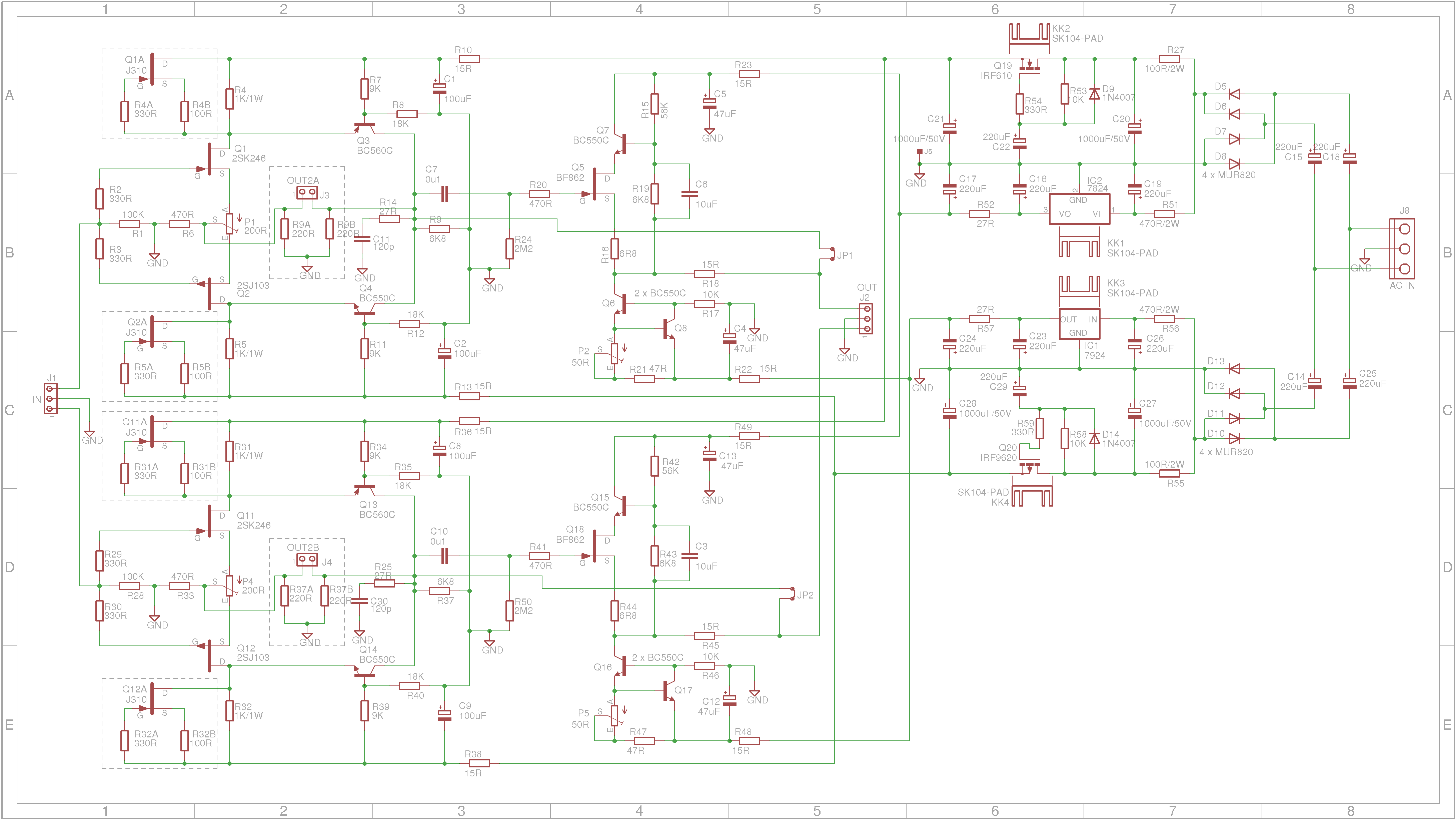

btw, the optional feature to 'steal' the signal between input pre and output buffer may offer several interesting alternative uses
might be used for signal splitting, but maybe also for summing/mixing a signal![scratch2 :scratch2: :scratch2:](https://files.diyaudio.com/forums/images/smilies/scratch2.gif)

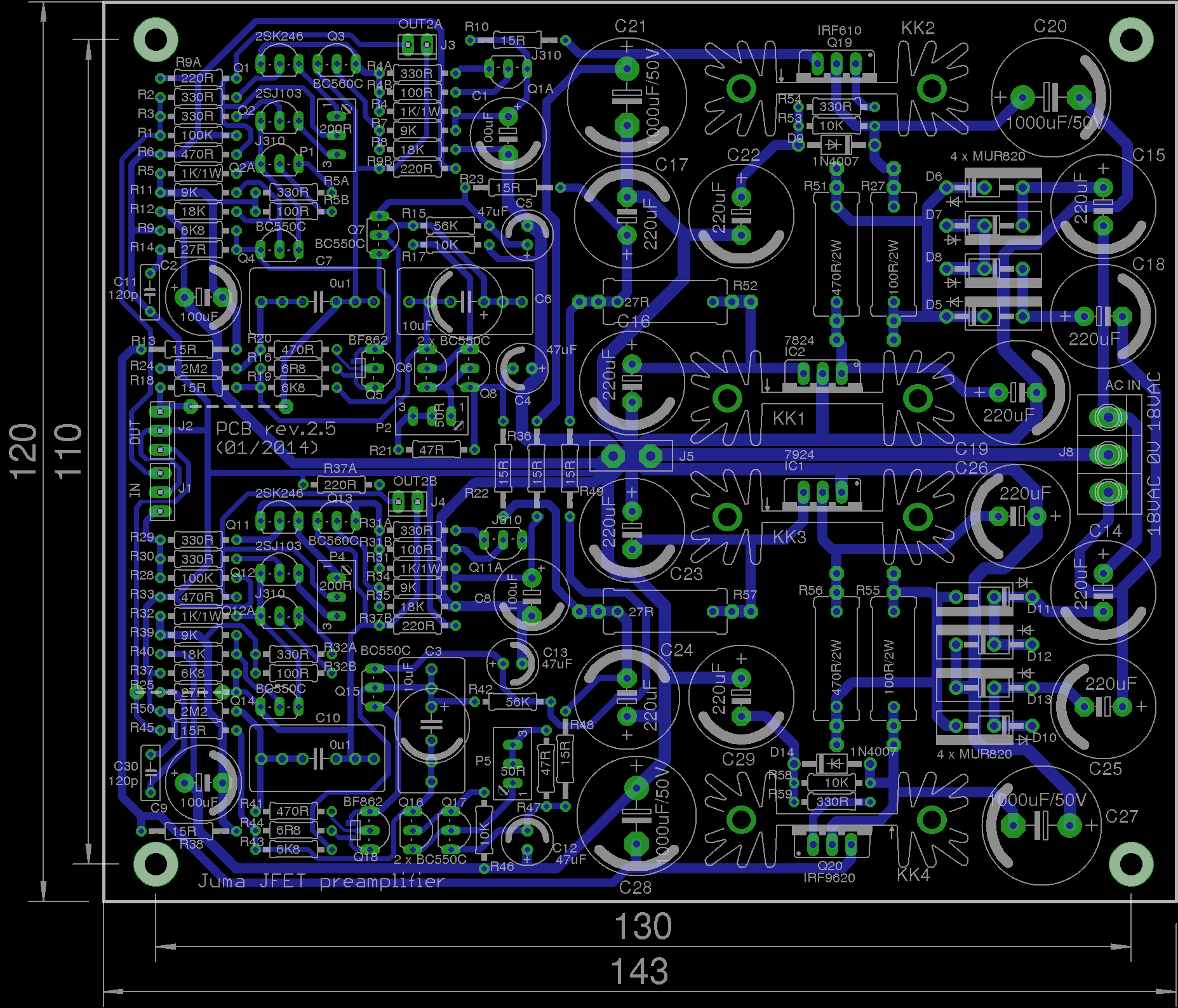

I think we'd better look for a different supplier of those caps as Farnell prices for these are pretty high, particularly the Au$18 asked for the 10uF ones and the Au$13 for the 0.1uF MKT1837s (good caps tho) - the Welwyn resistors look good
I think I can squeeze the slightly larger Nichicon KZ electros into the spaces - the 100uFs are 12.5mm dia (designed Pana Fc's are 10mm dia @ 5cc) - similar with the 47uFs where the KZs are 10mm dia @ 5 cct (designed Pana FC are 7mm dia @ 2.5 cc) - can raise them up a bit with a rubber standoff, I guess or maybe on their sides on the bottom of the boards with taller support posts - similar thing with larger sized C7 options.

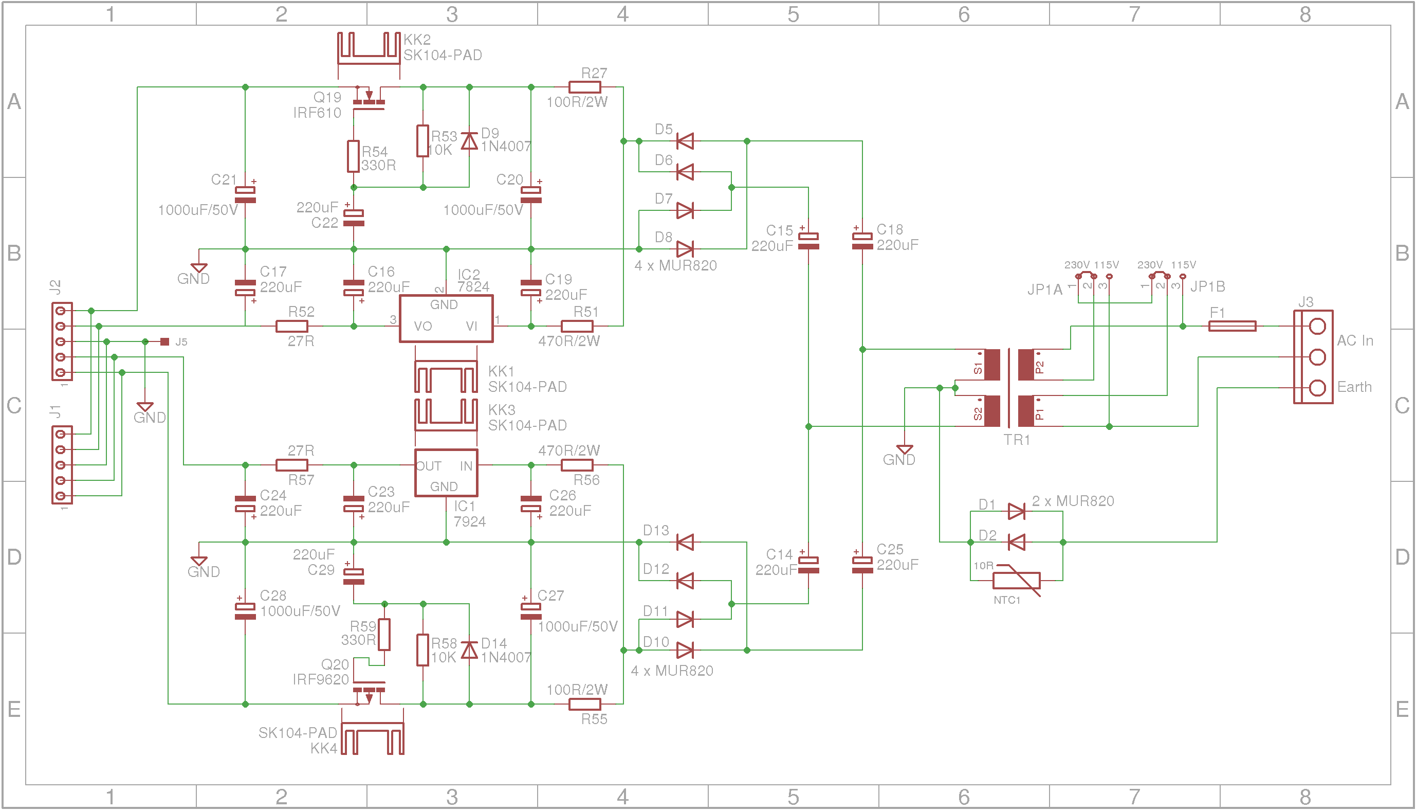

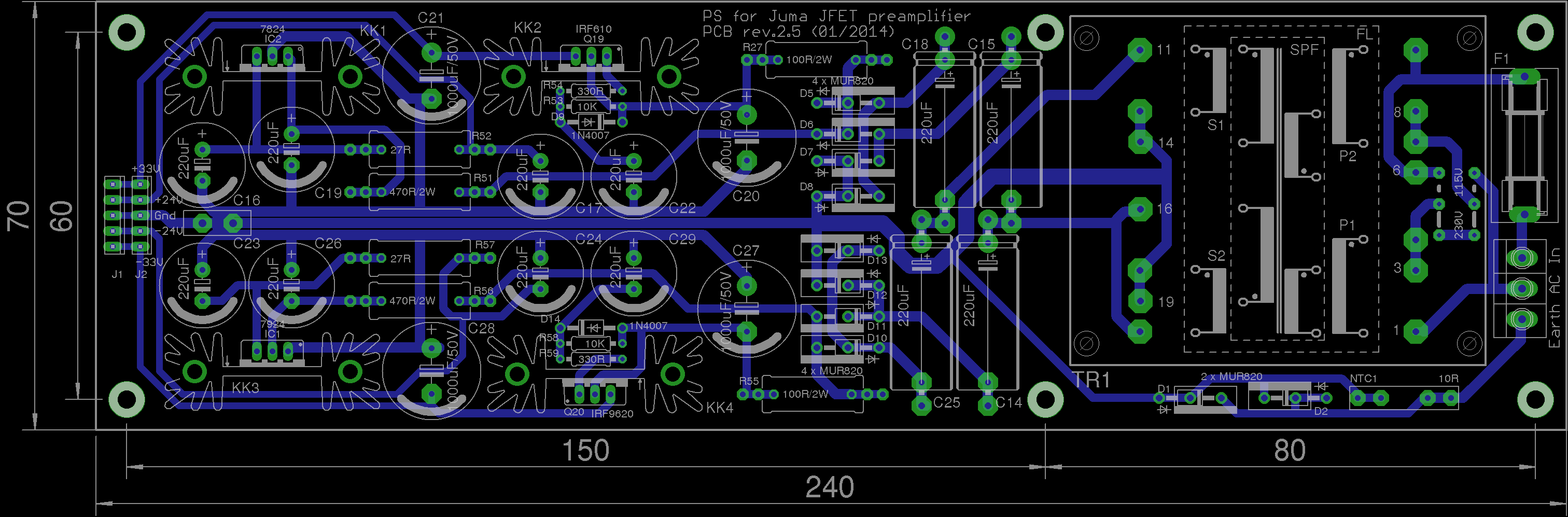

Here is I hope final version of dual channel PCB and PS for powering single channel PCBs.
Please if someone can make a double check of all jfets pinouts.
New BOM is now broken into sections and include all variations on one place.

That's about it, Prasimix - I can play around with pcb design forever as I find it 'kind of' relaxing in a way!
For people that are a bit 'anal' about ground tracks (like me!), we can easily cut the grnd tracks next to C19 and C26 and just link this point directly to the J8 terminal - an easy option.

Huh, that was mine intention, but for some reason it disappeared in the meantime. Don't worry, it's already included in rev.2.6 together with some other minor improvements and corrections.
