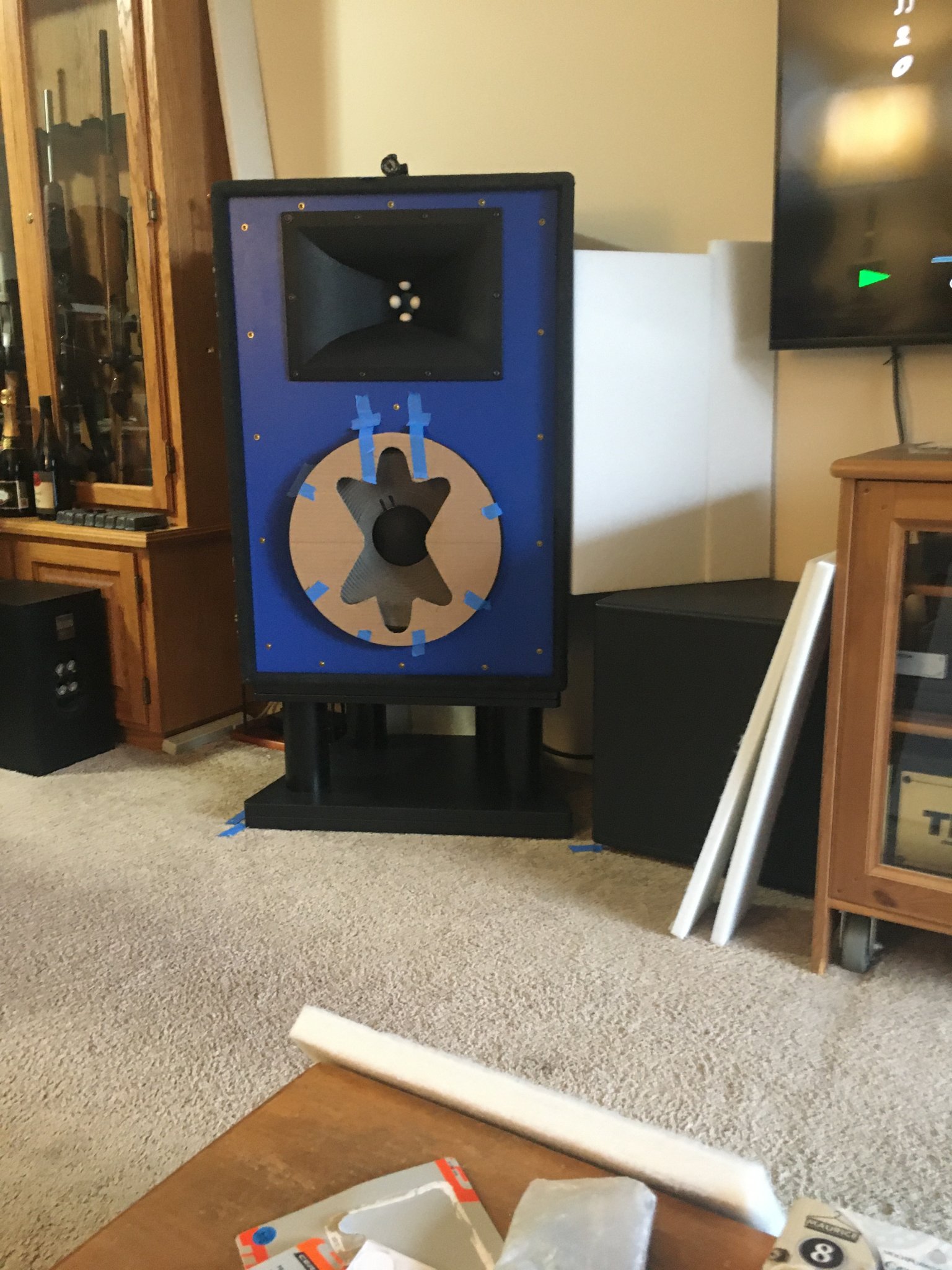

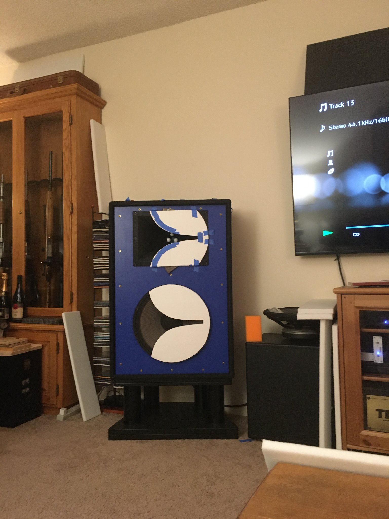

here is a photo of a modified JBL SR 4726a. I am posting so others can take a look at some other possibilities. I have been making these modified Karlson tapers which open up much more rapidly than the standard Karlson radial taper. I find this eliminates the strange vocal resonance that often results. You can see the tweeter horn also uses taper with the same profile as used on the woofer.my friend made some nice 8" drivermidboxes for me to compare with K8MR

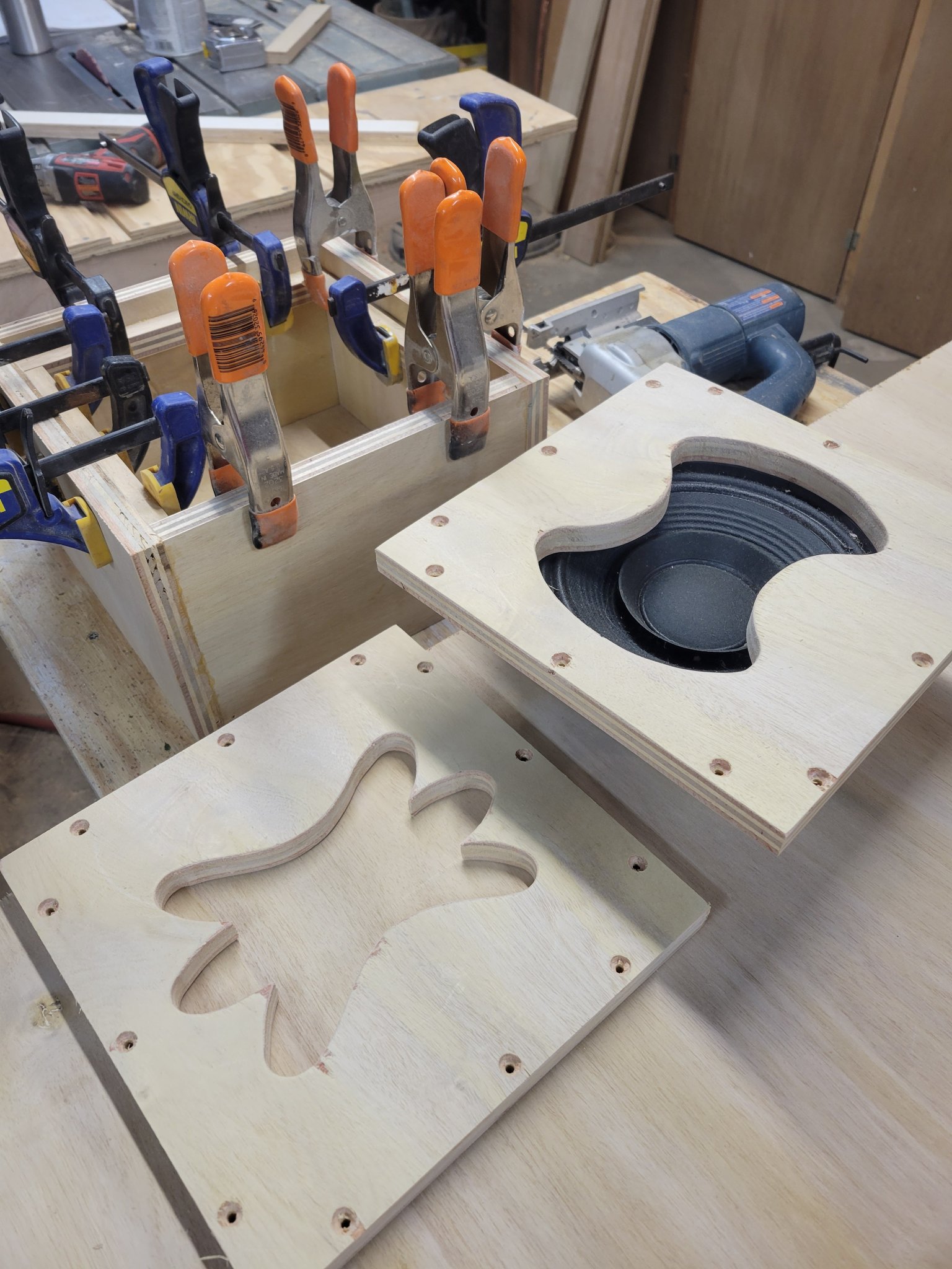

No "Lemon (R-J)) not rectangular slot. This is all J

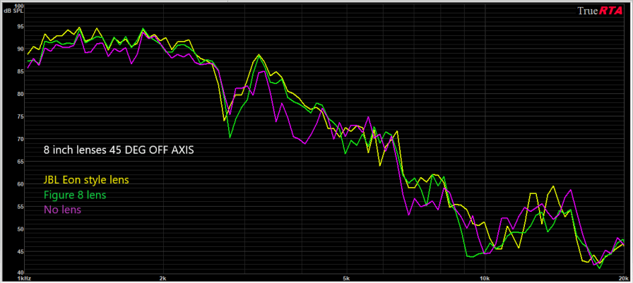

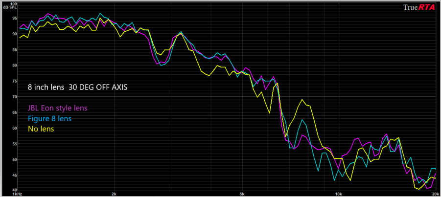

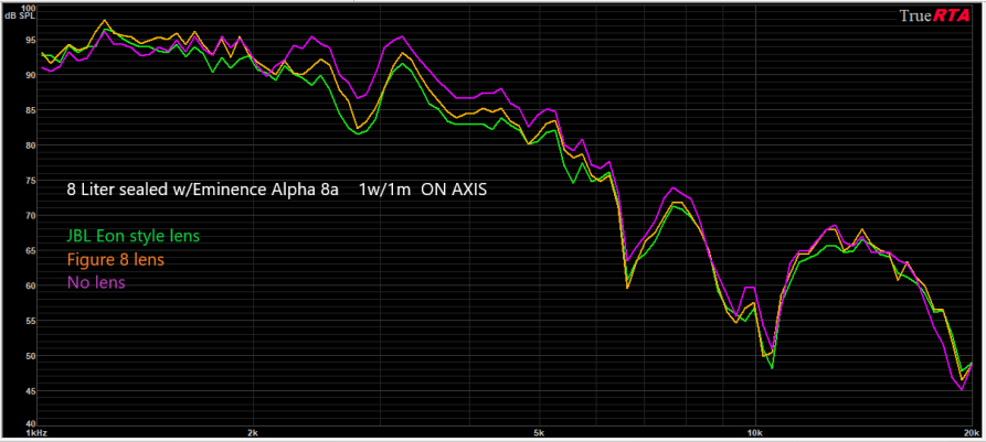

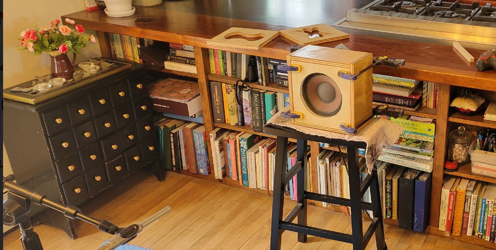

ohn Lapaie's work for me and he made the graphs too.. I think but am not sure tha his driver for the tests was an Eminence Alpha 8 and the whizzer cone driver shown with an aperture a Sammi 8 inch.
Subjectively" speaking, John preferred NO Lens to the ones tested.
Graph wise - I like the scaled EON aperture. John thought it sounded 'the most colored".
Here's how those two apertures graphed at 0- 30 off and 45 off vs no aperture.

Hey Restel thanks for the post and question. When I was typing I somehow hit post before I was ready to. I tried to edit but could not and I had to go out so I left it be the way it was. I had wanted to add that the orientation of the tapers I built which you see in the photo is not the final position which was decided upon. In the end the tapers were in a more or less standard configuration set up with the small gap facing up big gap facing down. I spent a good chunk of a week listening to many different positions for the tapers. With the wide end of the tapers facing to the left and right you send more low frequency in the direction of the wide opening. Position within the room will have an impact on what orientation will sound best. I recommend folks try an assortment of taper positions to see how different they can sound. I even had the woofer taper opening up toward the tweeter taper.I noticed that you orient the Karlson style slots [tapers] horizontally, do you find that orientation favorable?
The two tapers shown are not exactly the same, the taper on the horn extends to a smaller gap size than the one on the woofer this was done to obtain a better balance between the two since I don't want extended response from the woofer. I also built a flat JBL Eon style lens which while sounding good did not win out over the modified taper profile I like. I hope this helps and encouraged others to experiment.

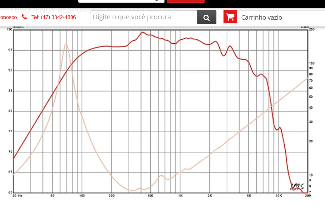

do you have a measured response of this driver (Delta Pro8) in your Karlson cabinet?I've got a pair of Eminence Delta Pro8a

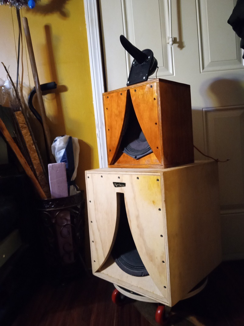

Freddie the best idea I can come up with is to use a sealed box for the mid driver and then use an external Karlson taper as I did on the JBL speakers I just posted about. This would take some cut and try time to get the response you want however.How would you make a really good K-midrange speaker to be used in a multi-way K-ish system?

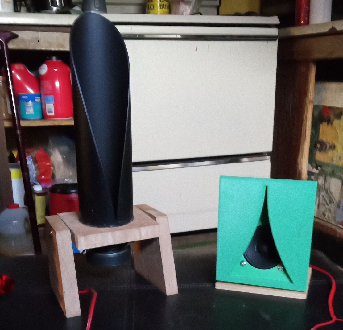

Why not a K slotted tube, like the tweeter, only bigger? If it can broaden the spectrum of a jet aircraft exhaust, why not 300 - 3K from a speaker?How would you make a really good K-midrange speaker to be used in a multi-way K-ish system?
That may work - I don't even have materials to try it. IMO having a difraction slot closer to the cone will result in wider dispersion. The aperture on the green lens could be tighter. Both have 3FE35 I think. An on axis rise would be useful for tweeters. A good compression driver on a K-tube will beat the little fullrange on cymbal reproduction.
This K-tube was made for me by Stephen Merryweather ("Suntiger")
my 3-way with a B&C 8pl21 k-midrange and no attenuation of mid nor tweeter plays pretty well. It could measure better as the mid cabinet has a notch whether the K-aperture is in place or not - a simple damped stub at the top of the cabinet would smooth response. Something like this stack and a good clean subwoofer could make a fun and punchy system.
Obviously, with a fullrange driver, the treble comes from the area of the dustcap and/or the whizzer cone. This is where the dispersion of an acoustic lens is relevant, yet you'd need a very narrow slot indeed to actually affect the very high frequencies. So that EON lens looks really wide open to be effective in those high frequencies. And a Karlson slot would seem to have its narrowest part off center, away from dustcap and whizzer cone.

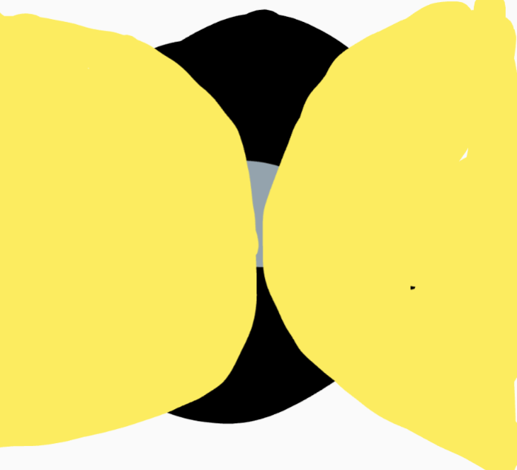

So how about two karlson slots, vertically mirrored? With the narrow ends centered in the middle and the wide ends pointing outwards/up and down?
that would work for a wide range driver or a dual concentric driver if you rotated it 90 degrees but I do not think for a two way.Like this?
Moray - I was surprised by John Lapaire's recordings of the short K
-lens vs no lens and vs a scaled JBLEON lens as the K sounded very even on vs off. (I think John's driver was an Alopha 8A by Eminence)
