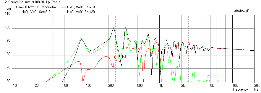

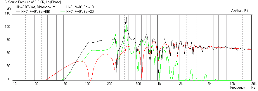

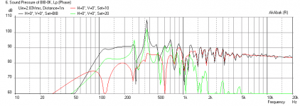

Effect of Karlson-like Holes on BIB
I am trying to get a feel for the effect of the Karlson aperture on existing speaker designs. I know some folks have tried adding a Karlson slot to the edges of their BIBs. I am trying to model the Karlson slot approximated as a series of holes of increasing diameter along the length of a speaker cabinet that has a horn or TL terminus. My fist model test case is a BIB using the small 3.5 in Vifa TC9FD. The first plot is the simulation of the plain BIB as prescribed by GM's BIB calculator (6 in wide x 8 in deep x 27 in tall with driver at 11.7 in from top) doesn't look too good with a pretty big dip at 125 Hz and two big sharp peaks at 250 and 350 Hz. The next simulation, I included 6 holes located as follows: 0.50 in dia at 23 in from the terminus, 0.6 in dia at 17 in from terminus, 0.75 in dia at 14 in from terminus, 1.0 in at 12 in from terminus, 2 in dia at 8 in from terminus, and 3.5 in dia at 5 in from terminus. These hole diameters are not following any prescribed "Karlson" exponential profile but hand selected to start small and located at convenient locations and slowly expanding at first and quickly expanding at the end. The point is you can infinitely "hand tune" these hole diameter and locations in real life with a hole saw and drill. The second plot shows a much improved flatter freq response, albeit you give up bass extension as expected. There is still a sharp peak at 350 Hz, which can probably be removed with more tweaking and adding holes to the speaker, and/or use of damping. The point is, the addition of swiss cheese holes can smooth the speaker response and knowing that bass extension is reduced, one just needs to start with a longer cabinet. Being able to model this before test drilling is a big plus. I am a believer in Karlson slots though - based on this exercise. I will try to model a K-slot speaker next.

The exact profile of a K-slot might not be very critical when it is used to gradually terminate a long pipe. This series of holes is probably just a good. It is another story in the Karlson bass enclosure where the slot also acts upon the front radiation of the driver. The slot probably needs to be of a certain dimension to do something helpful. I would not expect an 8" long by 4" wide slot to do much at the very end of a 80" pipe for example, at least nothing better than an equivalent sized rectangular slot. I'm guessing one probably wants the slot to cover some anti-node points of the higher pipe modes (5/4, 7/4, 9/4...) to de-Q these.

Thanks IG. I will see if putting holes at the 5/4, 7/4, 9/4 etc anti-nodes has any effect on spoiling the Q of these cavity modes. The specific targeted drilling of holes to spoil the Q of undesirable modes may produce a more efficient speaker than just a a general Karlson aperture which is aimed at being smooth. But really, cavity modes are integer numbers and quantized, not continuous functions. So much may be lost in terms of acoustic power by making a long arc slot. I am surprised by how much SPL I can still retain at the lower freq by drilling holes.
