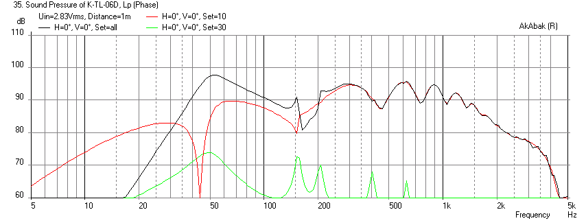

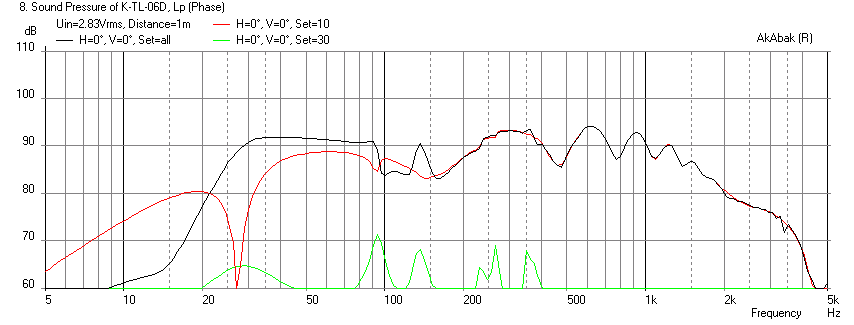

Here is a sim of the KEF with a stock Karlsonator in plot 1 - it has a very high bass peak that may cause "boominess". Second plot is the Karlsonator scaled by 18/15 in height and depth and by 10/12 in width followed by 1.5x in the upper vent cross sectional gap - seems to be flatter and tuning freq is about 33 Hz. The third plot is the impedance with the modified cabinet, the fourth plot is the cone excursion with the modified cabinet. All sims were with speaker placed with back 12 in from wall and 2.83v input measured at 1 m.
Thank you, you are fast
Second graph looks better but still is not flat enough, I would say. Especially at cut off region.
I don't understand your scaling system. What does mean "18/15 in height and depth"? I understand scaling factors like 1:2, or 1:25, or 2:1.5, or similar. Would you like to explain?

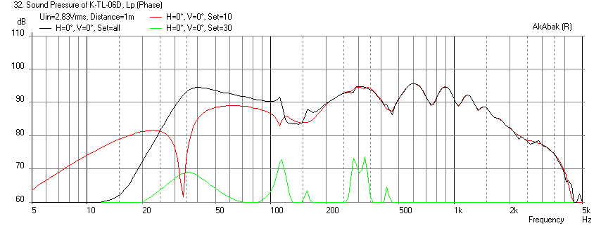

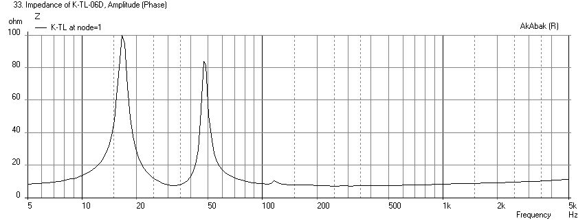

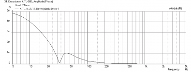

Thinking about why the KEF driver is behaving the way it does, I decided to try really changing the fs of the cabinet in a big way to get it to be closer to the driver fs which is very low. So I made the vertical and depth scale of 1.9X and the width scaled by 0.75X, and after the above scales are applied, scale the vent height by 2.3X - you get a flat response. I also added a 3 ohm + 1.2 mH coil in parallel as a BSC to tame the high end to balance it with the bass. The dip at 120 Hz is room placement dependent. Hope this looks better but it says you will have a very large speaker nearly 5 ft tall! 30 Hz to 100 Hz bass shelf is not bad - this speaker can sound really nice - you will need a tweeter crossed at say 1.25 kHz to make it whole though. Is this something worth trying or is the cabinet too big?

this new sim looks nice but 5 ft tall box is probihitive. I would go up to 1m, maybe 1.2 m if cabinet is not too wide. driver is 21 cm x 30 cm so if box could accommodate driver in portrait orientation that would be perfect.
on top of kef I would like to place Fountek FE85 and cross it @ 300Hz or so.
bass does not need to be 30 Hz deep, f3 around 38 Hz would be very nice, even 40 Hz is ok, but the curve should be as flat as possible, something like your last sim. that is one nice looking fr plot
if you can cook something like that I would be very happy and build it.
