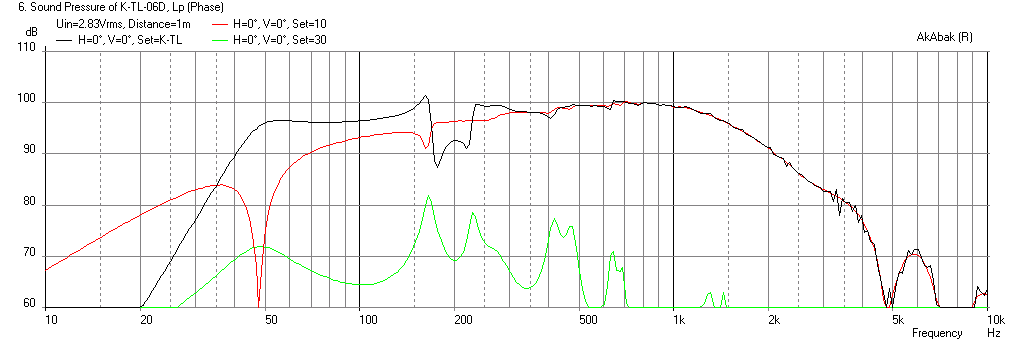

Has anyone ever tried the Karlsonator with an Eminence Beta 10CX PA driver? This is a really nice powerful driver that seems attractively priced. It will need the coaxial CD for the built in horn, or add a K-tube CD externally. I ran a simulation and adjusted the top channel by increasing it by 1.3X to get more bass amplitude to balance it out a bit. The f3 is 39 Hz (95.6 dB at 1 watt 1 meter), not too bad. If I were to build a full scale K'nator, I think I might go with this driver for a bang for the buck consideration.
First plot is freq response at 1 m, second is impedance, third is cone displacement (well controlled), fourth is impulse response (very clean).
The flat bass shelf on this combo can't be beat (IMO).
I'd like to try this with the coaxial CD, but I'm not sure how to go about increasing the top channel by 1.3x. Raise the roof or lower the inside bit?

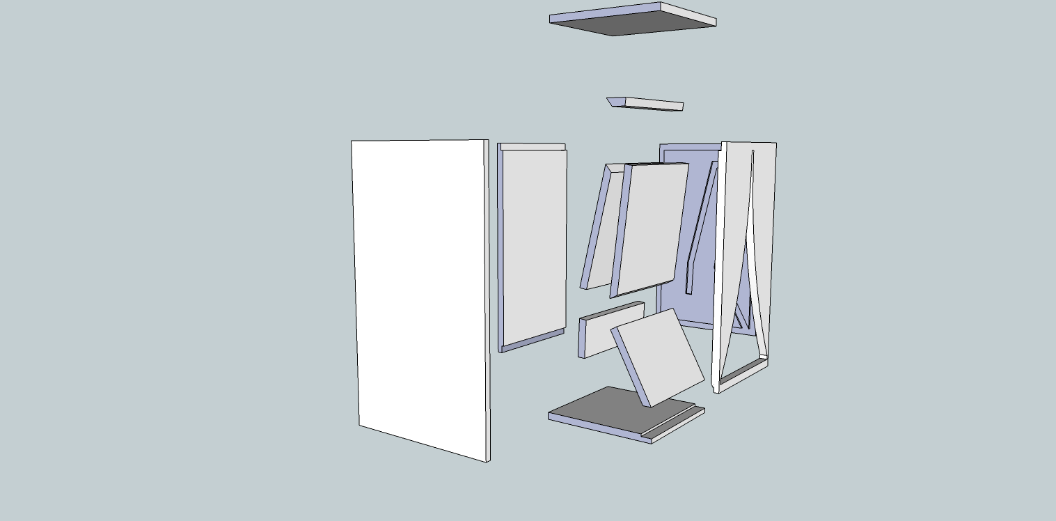

I'll certainly consider cutting some of these for the folks here. Let me take a step back and 3D model the K-6 in Sketchup to be sure I don't miss anything. I've done this before with other items I have built and then I know all fits once I get done machining the parts.
Once the K-6 is done, I can do the K-8 and K-12 also. Mods to these (especially width) would be easy...
So in the next few days when I get a chance I'll do a 3D sketchup with exploded parts of the K-6... and post it here.

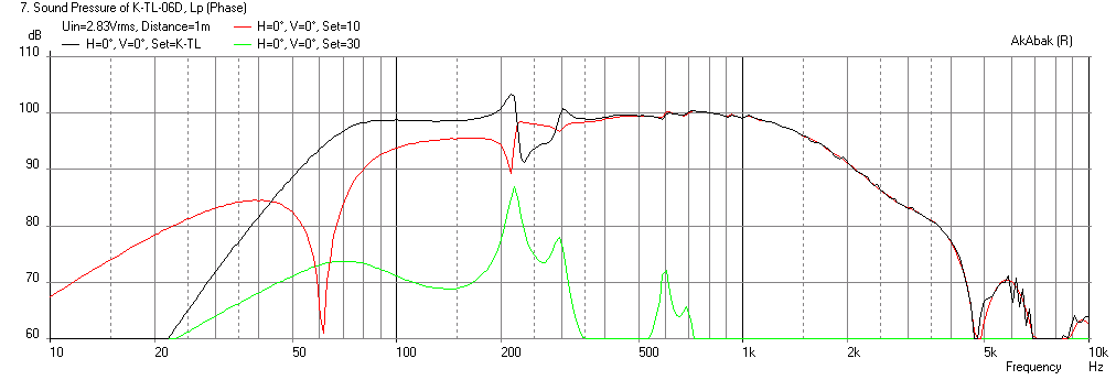

A Beta 10CX should be used in a full size Karlsonator (15 in). It will work in a 10/15 scaled one but at the expense of bass extension. Although you gain some efficiency. These sims are with a wall far away so you are not getting the added bass extension from a back wall.
Full Size
10/12 Scale

F10 `50Hz for the 10/12 Karlsonator seems an acceptable tradeoff - how about Beta 10CX versus Kappa 12A in GB's Karlsonator 12? - a pair of Karlsonator 8s should be nice too - dunno if the stock Karlsonator8 would match a Tangband 1772 - ? (also have Beta8cx and Nirvana stamped frame Super 8s) FE206EN had the most punch/attack for an 8" FR in a regular Karlson K12. Beta 10cx is a good high-value driver.

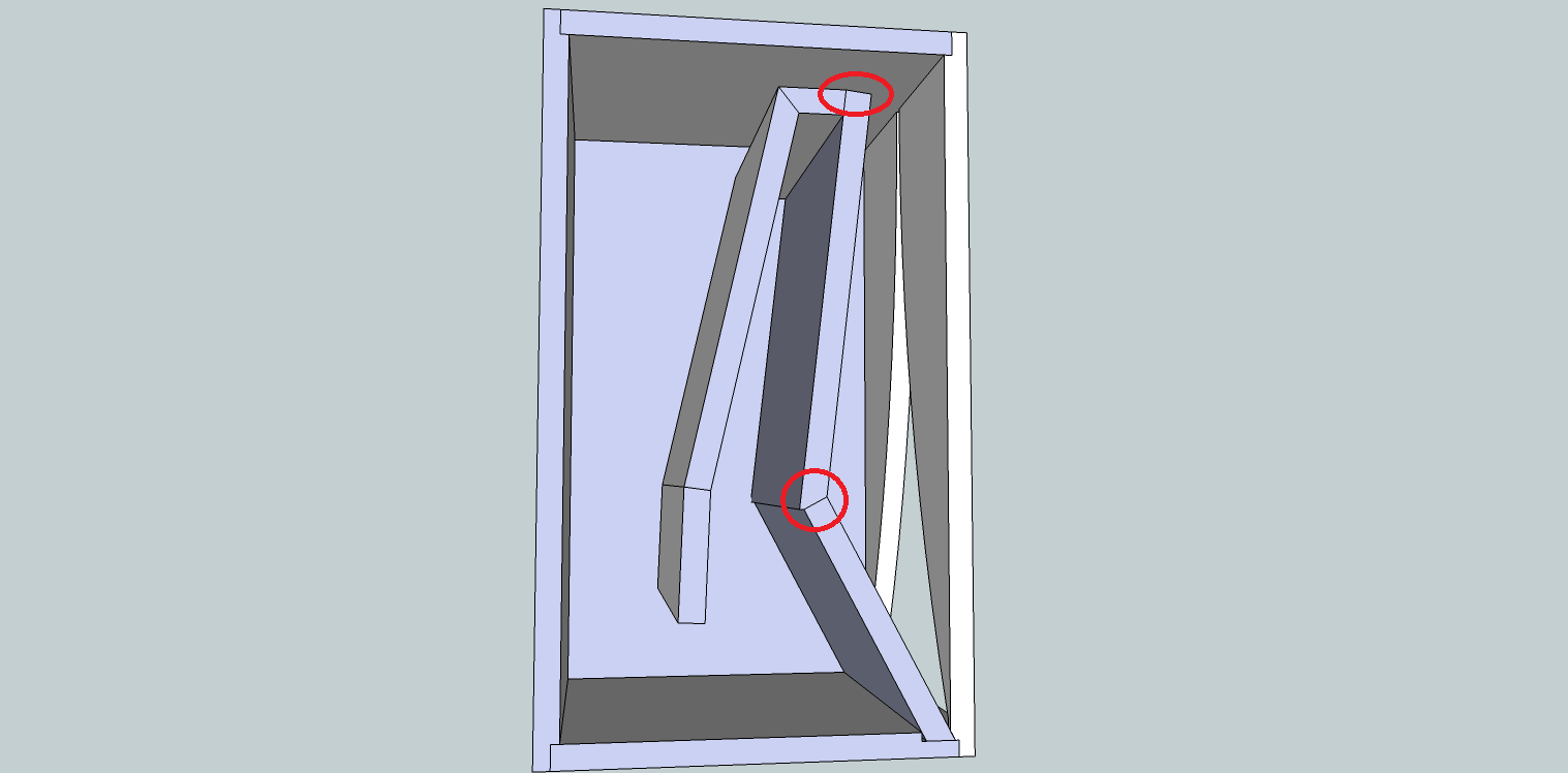

Karlsonator 6 3D sketchup model done. Note "discontinuities" circled in red. Those are because I can't undercut on the CNC nor do I want to (although it can be done carefully) flip the piece to machine it from the other side. I could manually (gasp) sand off the protruding part I guess...
Next step, lay out the pieces in 2D for cutting. Also cut holes for speaker and terminal as well as drill mounting holes for those also. I *hate* having to cut holes after-the-fact.

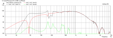

below is a comparison of the XK8 full width vent tuning versus the Karlsonator 8 venting in the same box
- you can see the TQW venting tunes lower for similar vent arear. In practice, I had to truncate XK8's vent area.
