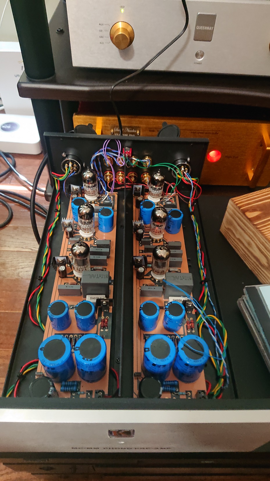

After a month of playing, I can report that this is a more than beautiful tube phono preamp, highly recommended !!

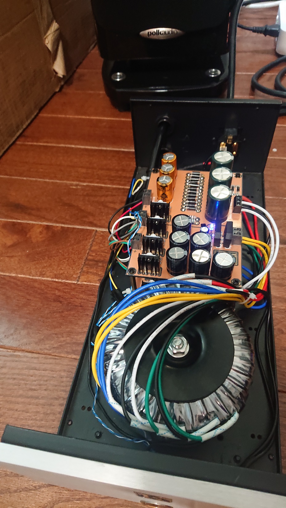

Did you figure out the transformer secondaries configuration? Each channel needs a 250-0-250 and a 0-8V? So you need 5 wires for each channel?
I did, I had the wrong tranny and ordered a different one with the correct leads. Turned out the one I had ordered was for the tube power supply I think. Anyway the correct one arrived a couple weeks ago with the final few capacitors and I got it all together and turned it on and... nothing, it worked just fine! No explosions or anything! lol
And I have been listening to so many albums over again as this phono-pre is unbelievable at extracting new detail, space and air I have never heard before. I highly recommend this kit amp for an upgrade to a system!

Hi Kingsley,
I bought the BRZ phono preamp 2nd hand including the already mounted Mundorf Supreme caps so I cannot give an opinion in comparison with the standard mounted caps.
The tubes that I have put in are the Electro-Harmonix 6922 / E88CC Gold and the Philips 12AT7WC ECC81 JAN NOS Balanced, I also want to look for a replacement for the 6Z4 rectifier tube but that will be something of a 6X4 tube with a 6Z4 to 6X4 converter, or I am going to change the print track connections so that a 6X4 tube can go directly in.
As for the power cord, I use a regenerator with DIY Alpha shielded wire to the turntable, I haven't tried anything else.
