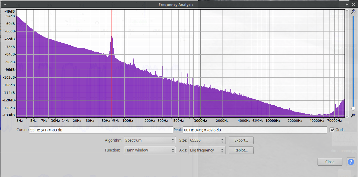

Has anyone made noise measurements in MM and MC mode, or taken a noise spectrum snapshot using, e.g., a PC soundcard and software like Audacity?

Hello all,
Can someone with the BRZHifi Klimo clone please measure the noise and/or show the noise spectrum in MC and MM? Maybe just plug into a PC sound card then use Audacity or similar to measure the spectrum, preferably at 192KHz/24bit? I'm interested to see how it stacks up against my current, MM-only Paragon System E preamp (spectrum analysis of line out, phono pre, unterminated inputs, from Audacity attached.)

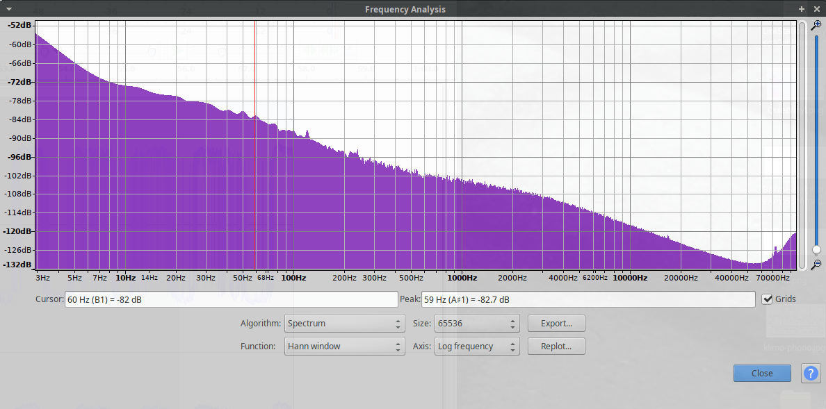

Noise analysis of a MM or MC preamp (or any amplifier) is pretty meaningless without the correct impedance on the inputs - in fact for MM your noise performance may depend mainly on the cartridge inductance interacting with the input current noise of the preamp.spectrum analysis of line out, phono pre, unterminated inputs,
Good point. In the case of the Paragon, profiles are similar, overall a little lower except for 60Hz leakage from an imperfectly shielded/grounded tonearm. I'm still interested to see how it compares to the BRZHifi Klimo clone.Noise analysis of a MM or MC preamp (or any amplifier) is pretty meaningless without the correct impedance on the inputs - in fact for MM your noise performance may depend mainly on the cartridge inductance interacting with the input current noise of the preamp.

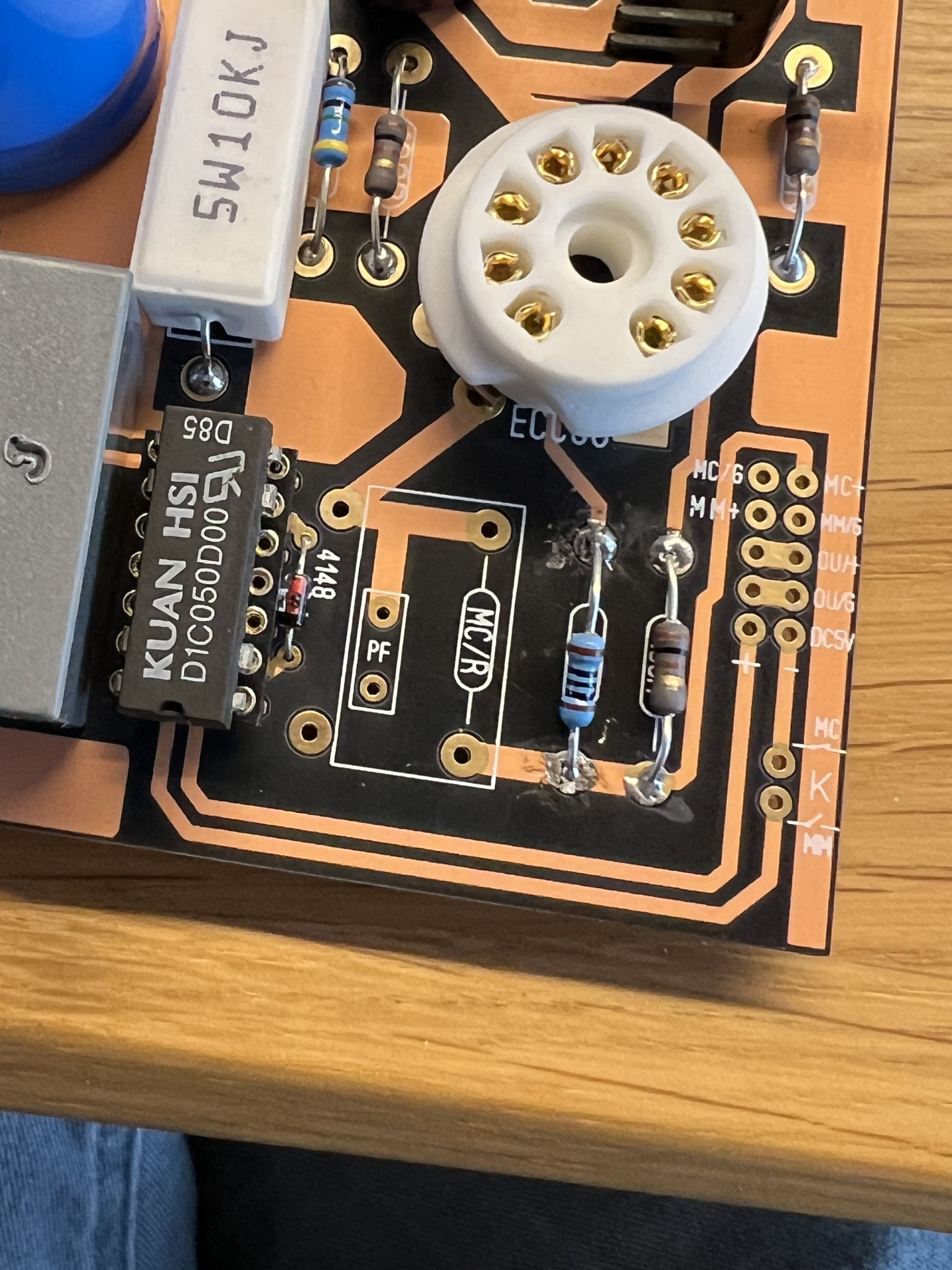

I'm thinking about building the Klimo LAR clone. Looking online, I found numerous AE sellers that offer either a 'gold' (ie tube rectifier) or transistor PSU. The pictures are not great, and they appear to differ from the schematic, which was posted here as well. Also, based on the photos, not everything seems connected. As an example, the capacitors in the filament section are not all connected.
Are there more picures of the bare PCBs? Either the tube rectifier board, solid state rectifier board, or phono stage?
