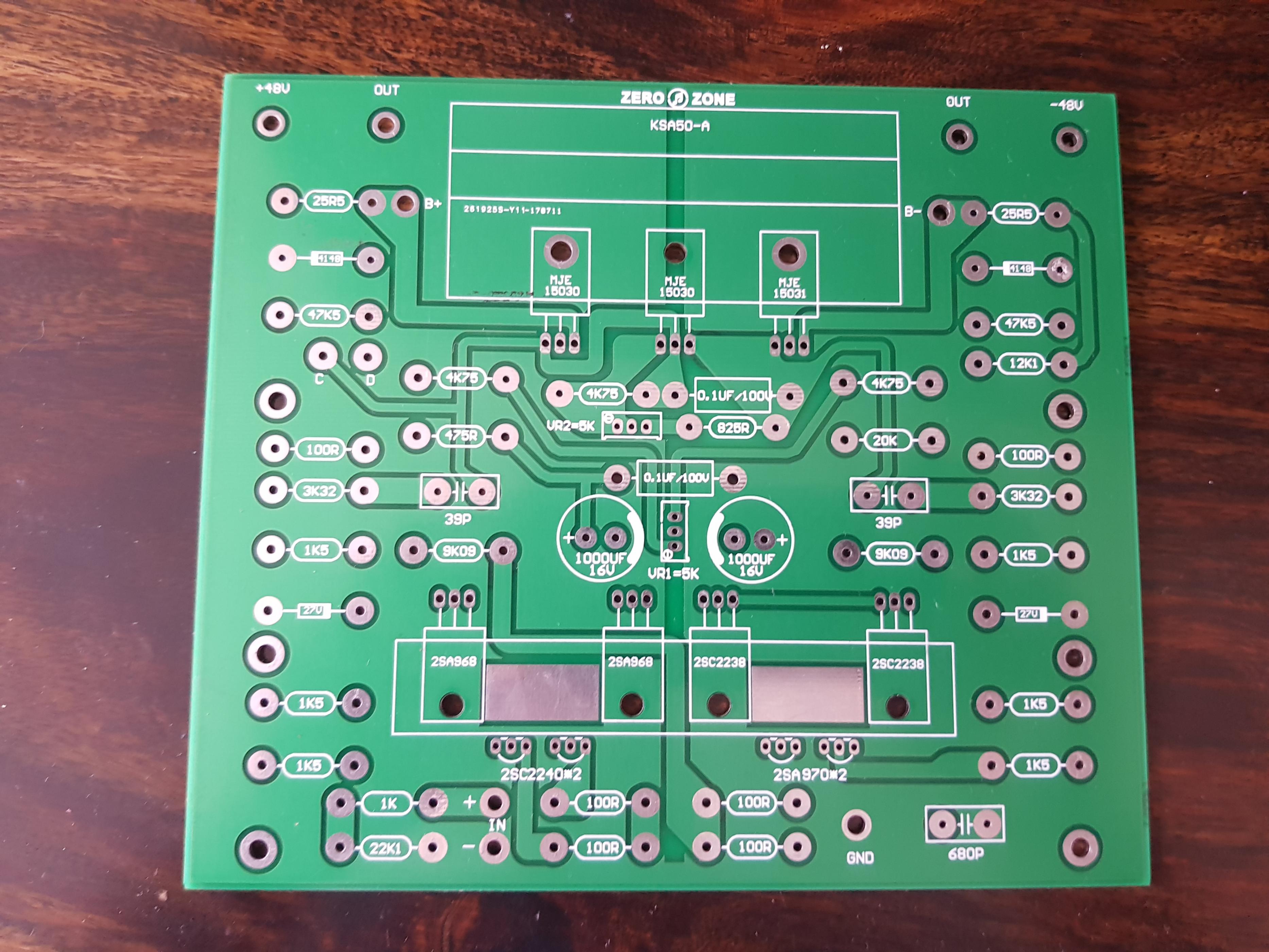

Hi gaborbela my pcb has printed on it krell ksa mk2 -48v +48v.
I have looked at images of krell ksa 100 and its a differant pcb it has extra transistors.
This pcb looks exactly like genuine krell ksa 50 mk2 pcbs.
I would like to make my amp with same voltages as genuine krell ksa 50 mk2 as I only need 50w a channel but would like 50w of class A like original amp.

That is not the KSA50!
With that high voltage, I am sure that is a higher power, Krell.
They had an 80W version or 75W, I am not sure exactly.
You should go to ZeroZone site to find out more about your PCB.

Yes, you can use your PC boards for KSA50 (It is advertised KSA50II) but it is not fully Class A biassed at 48V rail voltage.
I read some KSA50 and KSA100 restoration and KSA50 uses about 26V transformers.
If you want 48V rail voltage full Class A bias you will need like 1KVA transformers per channel. If You want to build a 50W please you do not use 48V rail voltage because you will need higher V power supply caps etc, it will cost you more.

Alan, ksa50 is NOT fully biased class A amplifier, simple as that. Dan obvious had his reasons why he put higher rail voltage in later versions instead of lower rail voltage on earlier amps. Higher voltage seems to be more important to him than full bias. Sound quality and ability to drive more demanding speakers perhaps? Between two of my Krells one with higher rail voltage is a true winner.
Btw., two pair of output devices will not survive full bias for 50 W class A on 48V DC rails.

Thank you this explains a lot so KSA 50 MK2 was not full class A but sounds best.
Reviews I have read say that MK2 sounded better than original KSA 50 but it looks like there is a few different versions of this amp.
KSA 50 with pcb that looks more like delta pcb then pcb that looks like my pcb without dale resistors then the one with dale resistors.

In that case go for the higher voltage version, Dave. After all, you listened to it and you liked it 🙂
Just a thought---- supply the PCB with the +-48V to satisfy the opinion that running at this voltage sounds better and supply the output stage with say 37 V as per the original. That way you could bias to run 50W class A with still manageable heat dissipation. Any opinions,or is is nonsense.
