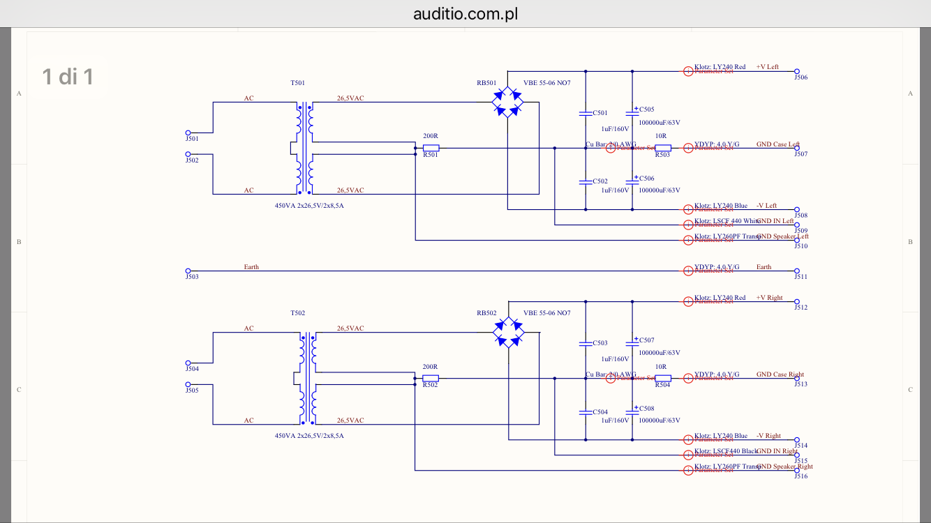

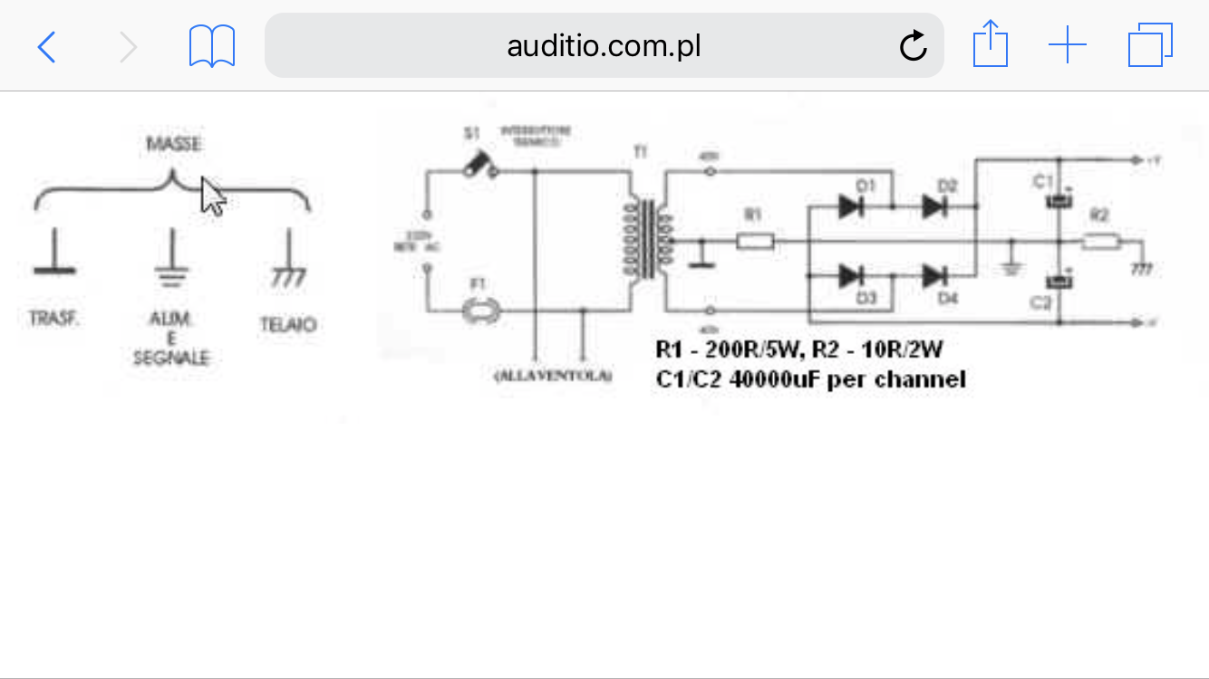

I have two schematics for Ground disposition, which is the correct?
Right theorical original
Left clone krell
Left clone krell
The both might be right (I mean technically correct) and original/clone Krell but the schematics below is better though low resolution. Correct values you may find in the accompanying text. There is a three part article on that subject - the best I have seen untill now.I have two schematics for Ground disposition, which is the correct?
Left clone krell

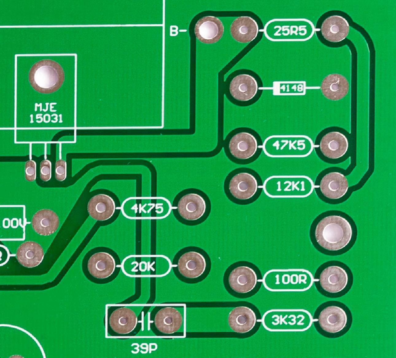

Hy , Pleese one information , i have Delta audio circuit , For d201 and d202 1n4148 is correct diode? Thank’ s
Look at the upper right corner of the image below: the diode is 1N4148. It really looks small 😱 but is large enough. I have actually used 1N5408. Just zoom in >>the image <<< in my post on previous page to see how it compares by size to other elements, 🙂Hy , Pleese one information , i have Delta audio circuit , For d201 and d202 1n4148 is correct diode? Thank’ s
I followed the advice on the TNT audio article and ended up with this..I added the bleed resistors 🙂
