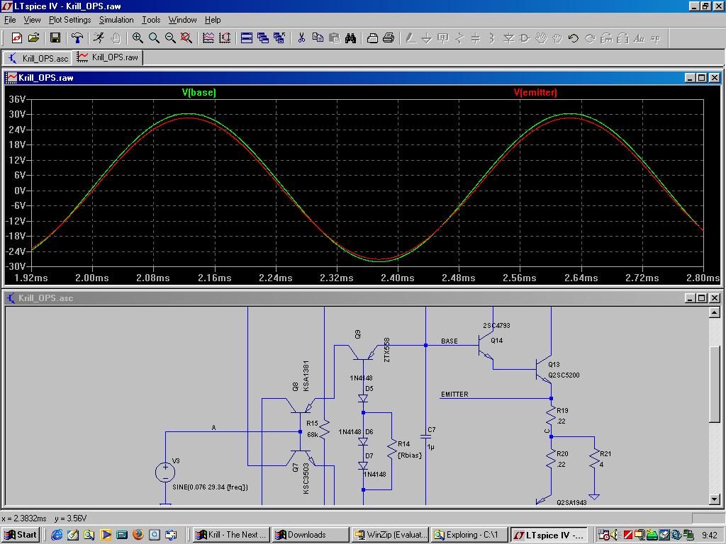

Yes, I'm sure that was it. As far as the operation of this circuit goes there really is nothing to add to what Andy said in post 7 and showed quite clearly in his subsequent simulation plots.
And can't believe those who think this scheme works are still sticking that big cap between the driver bases, which absolutely guarantees reverse bias of the driver+output device b-e junctions at all but the lowest audio frequencies. Unreal! :rolleyes:

andy_c said:
So, which one is correct?
No contradiction there.
Here is a run of the sim file posted by Andy in post 11:
http://www.diyaudio.com/forums/solid-state/151295-krill-next-generation-2.html#post1918262
I'm showing something different this time - the voltage at the base of the NPN driver along with the voltage at the emitter of the NPN output device, at 2kHz with a 4 ohm load.
On negative swings the B-E junctions are reverse biased, exactly as theory predicts.
If you look at the Vbe of just the output device by itself though, it ends up being forward-biased when one might expect reverse bias. But its base when in that state is essentially open-circuited (except for strays), since the Vbe of its corresponding driver has a hard reverse bias. So the output device is kind of hanging in the breeze there. Its Vbe is forward biased, but only due to stored charge.
