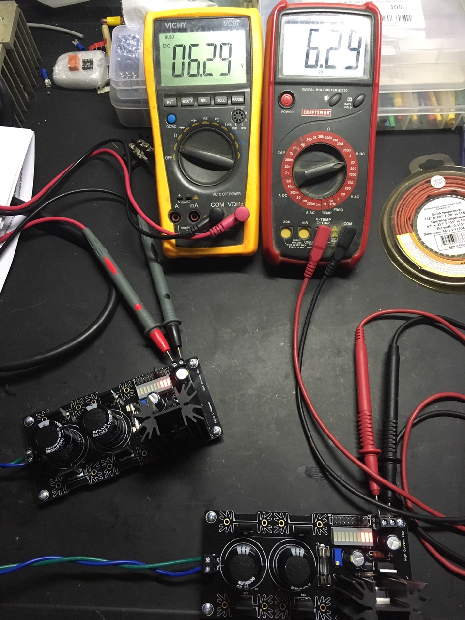

I was setting up my own L adapter.
My test transformer secondary is 15Vac (I damaged this transformer so only one pair of 15V secondary winding is working; good for abusive experiment). No load.
Turned on and I saw LED lights and the output Vdc was about 19.9Vdc without adjusting anything yet.
As I switched jumper position, the output Vdc difference is only between 17.xVdc and 19.x Vdc.
Q1: It is supposed to be like this?
And I adjusted the trimpot too quickly and it went down to 7-6-5Vdc etc; both trimpot and LED array unit became extremely hot; then the LED array unit popped.
Q2: What is the relationship between trimpot and jumper setting?
my ultimate goal is to power RPI3...of course.
I got my new transformer-secondary is 2x12Vac.
I will adjust L adapter down to 8Vdc to power the secondary regulatorsx3 (5.1V, 3.3V & 1.8V.)
For the sake of curiosity, I replaced the LED array unit with 10 regular individual LEDs and they worked (leftovers from hotrodded DCB1, good quality clear yellow LEDs from mouser).
Q3: Can the individual LEDs be used in place of the LED array unit?

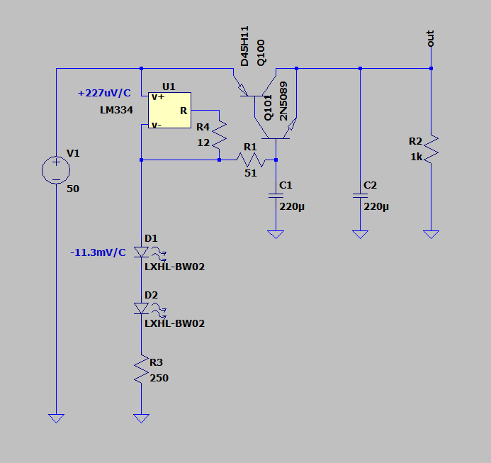

A1. No it is not supposed to be like this. It should be able to make about 1.75V distance jumps with each deselected LED from all lit highest Vo to very low when only one LED is lit without getting them hot. Confirm about 5mA produced by the current source 334 chip feeding the LEDS and the trimpot. There should only be 64-67mV across R2 if its OK. Check the transistors Vbe to be about 0.6V each. Hot popped parts means excessive current in their circuit branch. Recheck your design's connections against the schematic. Check for the LED bar's beveled orientation corner, it can be tricky to see. Replace any broken parts.
Another precaution is C2 can hold the voltage of a higher setting for a while if there isn't a path to ground (when both unloaded & R1 bleeder is not installed).
A2. The voltage level base are the LEDS. If you set the trimmer to zero it contributes no voltage to the LEDS chain. Expect about 17.5V Vout with all LEDS engaged when trimmer is at zero. So 5mA*500 Ohm means 2.5V max trimmer adjust contribution. That makes for 20V output max if your transformer can support it. Say some 18VAC one. With lower transformer / Vout goal not all LEDS will be able to light up anyway.
Vout as comprised by any chosen lit LEDS number plus whatever extra coming from the trimmer for your adjustment convenience, eventually equals C1's voltage level - 0.6V.
A3. Yes no problem.
