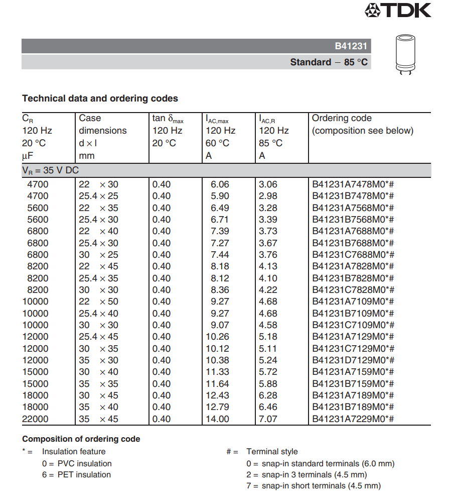

So larger capacitance to avoid too high ripple with higher current load (and AFAIU for "cruising current load", peak current is something else), is the capacitor current ripple spec of any interest? I understand that //ing 2 caps helps here, is it made on purpose? Or maybe I answered myself and their ripple current feeds the peak demand?
diyAudio Chief Moderator
Joined 2002
The capacitors ripple current spec should allow for the max AC current needed in the rectification recharge cycle to replenish them for a heavy load. Two capacitors are doubling that when their size and uF are kept smaller than having a comparable IAC max rating from a larger single.
See an example datasheet. Even 2x6800uF have bit more combined ripple current than the 22000uF alone. With 2x10000uF almost 33% more.

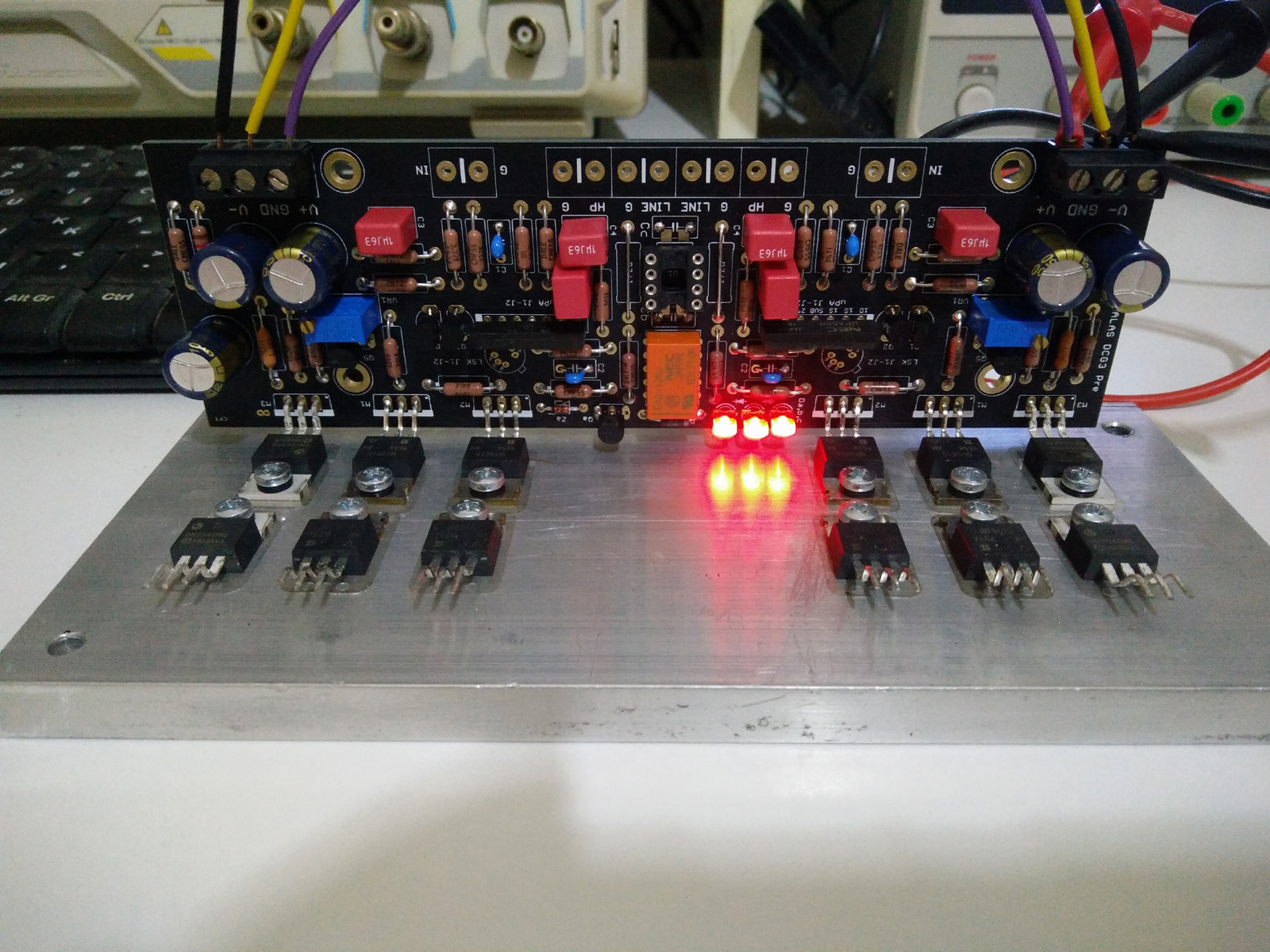

Good info and nice results. Thanks. I will be helping a friend finish a balanced XLR doubled up DCG3 soon. Including a motorized Khozmo 4X pot and remote control. Combining a 2X500W @ 4Ω Cubed line Bryston amp and PMC IB2i transmission line speakers. He has done the efforts on the chassis department but he is not confident about doing the electronics alone.
