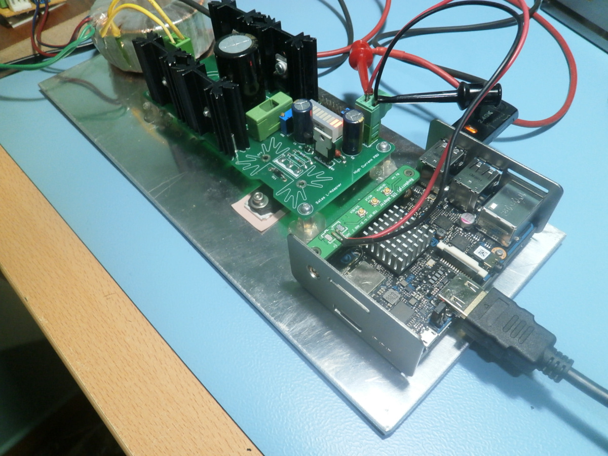

Leds are bright all the time and transformer is a little warm. I must point out that as far as consumption goes since I have 8 VAC secondary (25 VA winding) resulting 9-9.5 VDC (fluctuation I get) there are some watt wasted. A better pair would be a 7 VAC (in the future someone could test if going above 2.5 VDC Nick suggested would be of any benefit)

Measuring DC across the diode located in front of the big transistor, while the computer revs up at its most, tells how much DC remains at peak consumption when watching for that 2.5V minimum threshold.

Yep, you mentioned it before, there it's the right place to measure the difference in voltage in and out. Mine is 4 - 4.5 VDC and the aluminium plate is just warm. If I was gonna use the in-board heatsink I would certainly have aimed for 2.5 - 3 VDC (summer is hot here)
With just few mVolts above 5 VDC, it worked for hours without problem, so I will leave it there for Volumio testing. As I've mentioned the only problem was with the cable. Raspberry could be less demanding but I'd suggest to take extra care for this, so you don't run in wrong conclusion if you run into problems

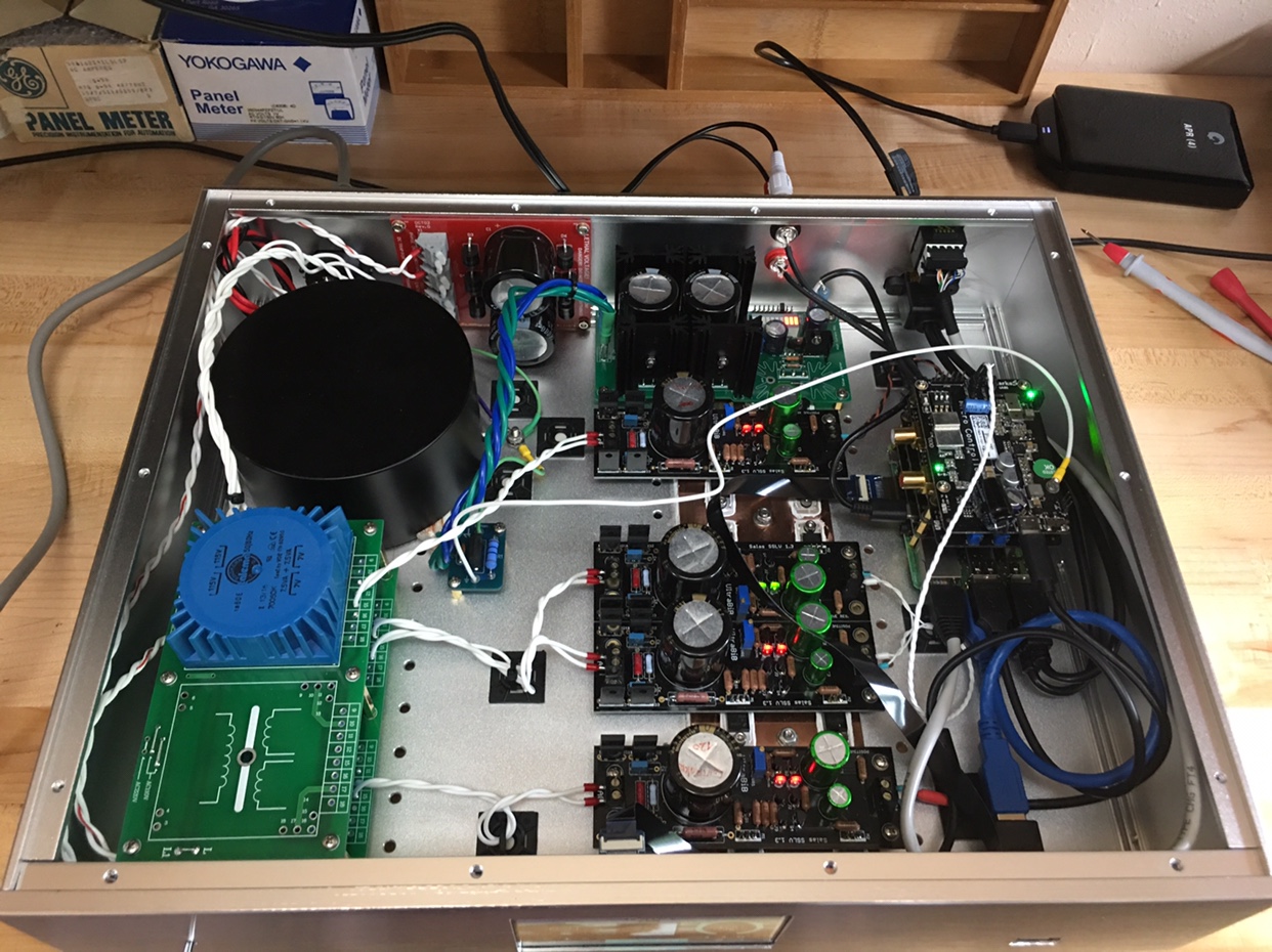

I will use 2 Salas Ultrabib's (5v) for Katana's Dac and Controler, 2 ultrabib for 15v+- for Katana's Opamp, and 1 L adapter (5v) for Isolator (Pi).
