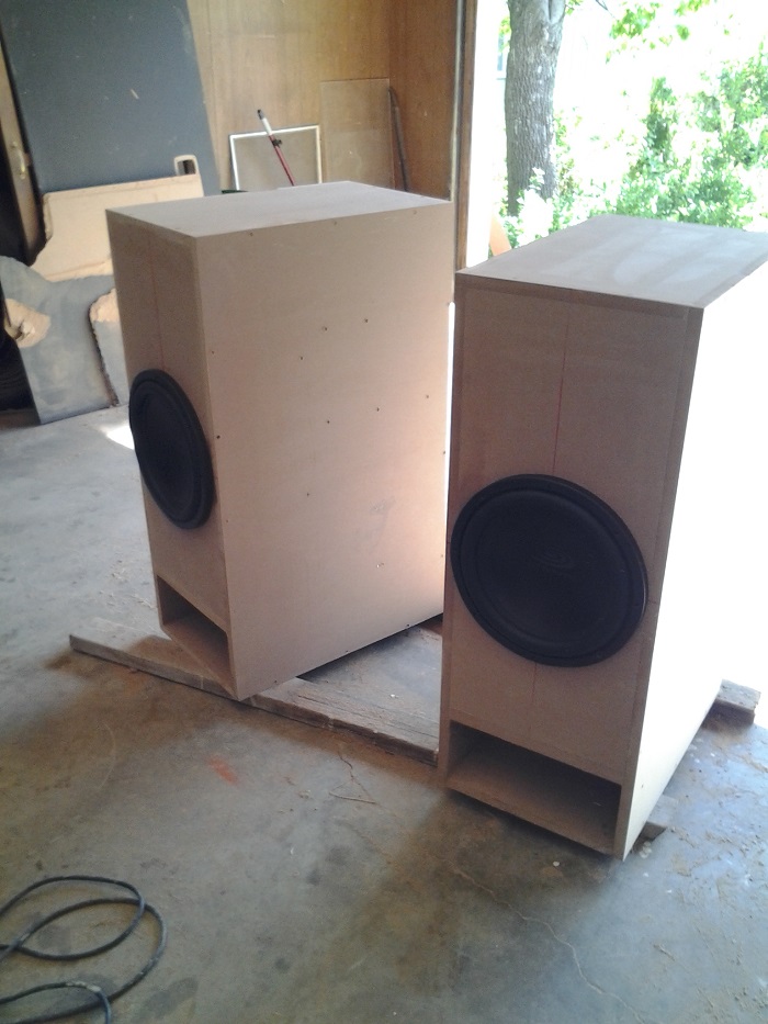

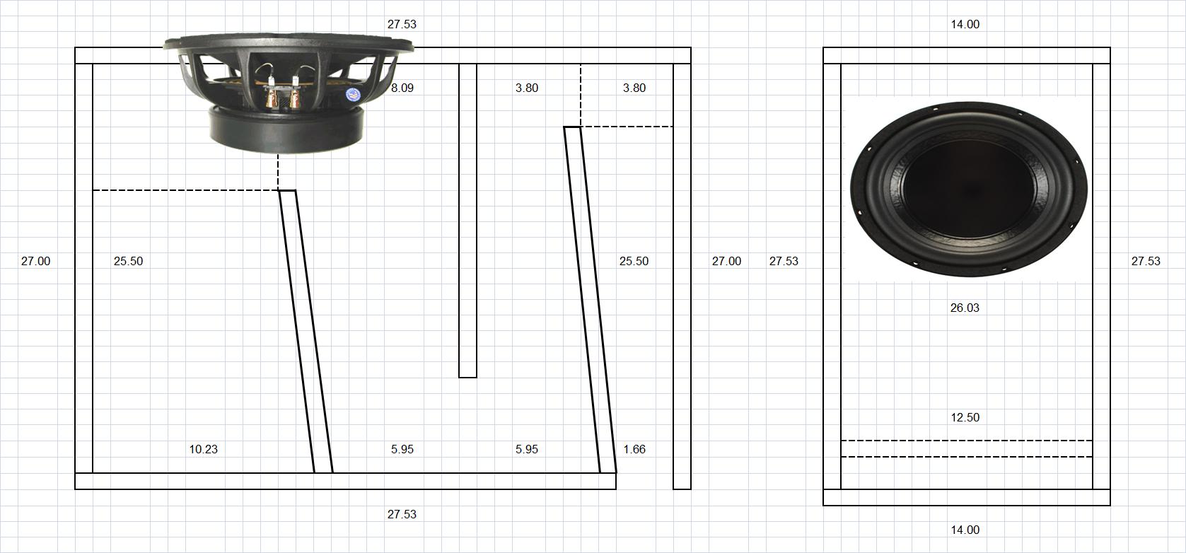

I'm not smart enough to figure out a single fold, let alone double fold.:confused:
348572d1368525546t-lab-12-based-offset-driver-mass-loaded-transmission-line-od-ml-tl-design-bj-od-tl_tb46_nwcgrad-folding-attempt-2.jpg
That is a single fold! A double fold might get the port to exit the same side as the speaker.
Those enclosures look good!
Thanks :) Yeah, they're pretty stout, it takes pretty much everything I've got to lift one and move it.

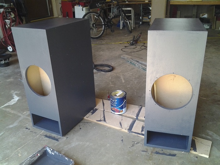

It's such a nice day today, perfect for some paint! :cool:

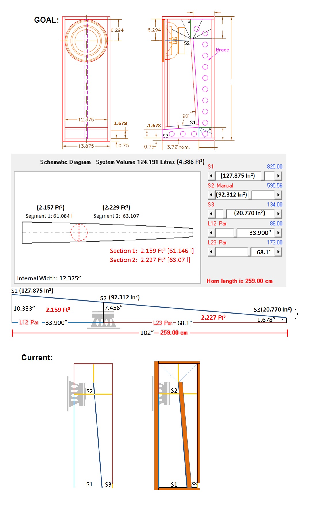

Those are looking really good. I need to make scale renderings of this design along with the two folding options for the OD-TL by tb46. Lots of options. I may build four of whichever design I end up using for a distributed approach to smooth in room response with minimal EQ. Second set would probably use the Epic 12 drivers.

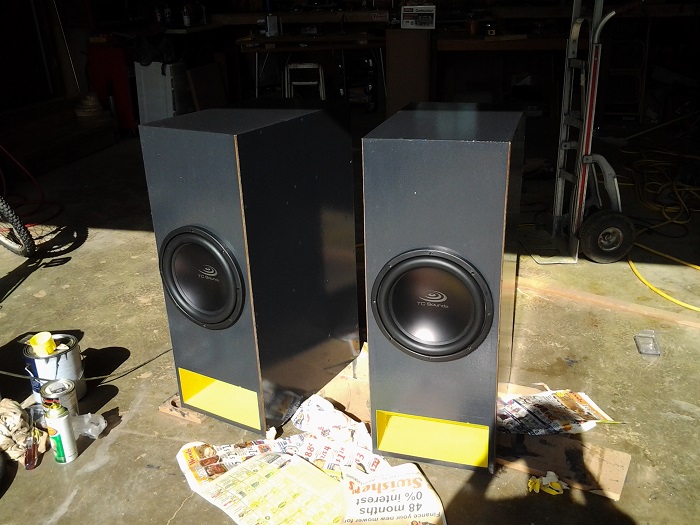

On the ODMLTL topic, I've decided to do a little fancy fluorescent paint in the vent, ala volvotreter. Hopefully I'll get em looking good enough to get some decent pics by the end of the day...and if the rain holds out, some outdoor measurements.

Here's a pic of what state the OD-ML-TLs are in now, the paint looks a lot more orange-peel in the pictures than it does when you look at it, camera phones be damned.
