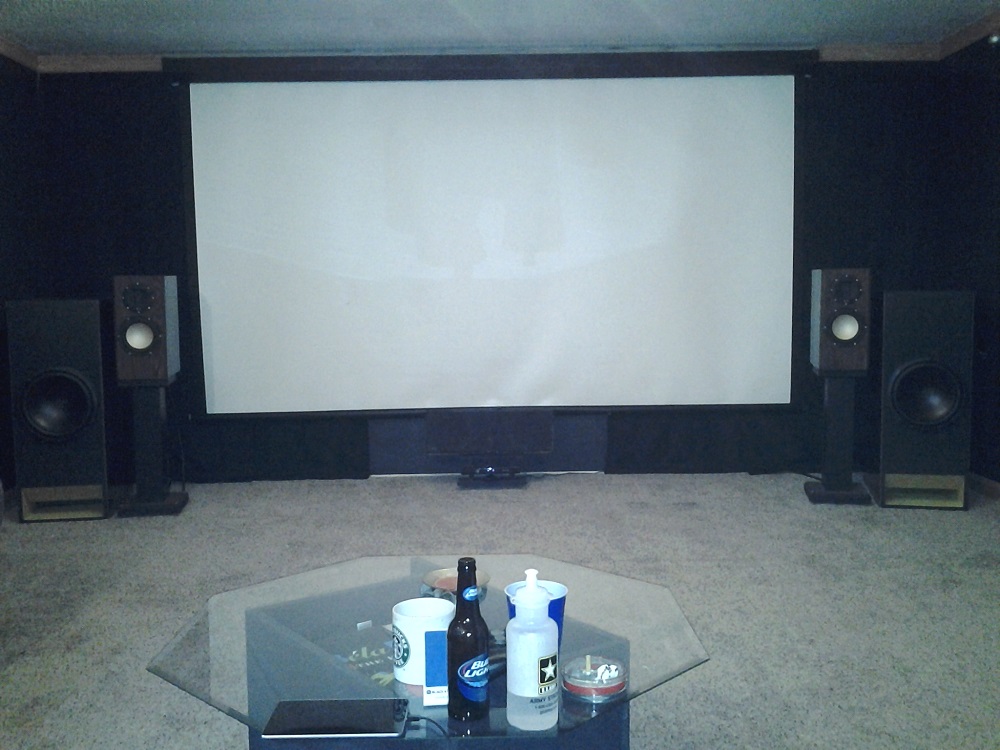

Last one, here they are in their spots, pics are a bit grainy, it's dark in this room.

🙂 Yeah, I love the color, I think I might do some accent pieces on my mains the same way, but I have to be careful, the mains are close to the screen and I think brash colors might be distracting.

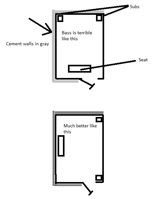

One thing I wanted to run past everyone here, but I've really been trying to find a position up front for the subs, but of all the designs I've had, I always end up with them at the back of the room. They seem way more even back there, but it's easy to tell where they are and I've been trying to get away from that sensation...which seems a lot like in a car, you can always tell the sub is in the trunk 😛
For fun today, I tried turning the subs and the listening position 90 degrees, so that the listening position was along a long wall and the speakers were along the other long wall. The bass seems much, much better like this.
I'm wondering, is it because of the cement walls?
I've been wrestling with this issue in this room for a while, I wonder if anyone has an opinion on it.
In the first pic both subs boost the "long" standing wave (with wavelength 2 times the length of the long wall). They also cancel the standing wave between the oposing long walls (wavelength 2 times the length of the short wall), because by the time the sound of one sub reaches the other, the last one is out of phase.
In the second pic the "short" standing wave between the oposing long walls is boosted, but the "long" one is canceled.
( The same thing happens with all the multiples of the frequencies corresponding to the above wavelengths. But half-frequencies of the boosted ones, are cancelled ).
Depending on the dimensions of your room, you can calculate which frequency is boosted and which one is attenuated in each case, and the explanation will hopefully pop up.
I say "hopefully", because in reality there is much, much, much more into this simplistic story.
Fortunately, coping only with the basic set of the above mentioned frequencies, a reasonable first setup can be achieved in the majority of cases.
If someone wants more, then lots of reading wait for him around the corner 🙂

I considered laying them down flat in the center with the bottoms touching, but I didn't try that yet.
@toulou Yeah, that makes sense. I could calculate some nulls and peaks in the two positions, but should I expect them to be very wide?
For example: This song. With the subs positioned on the short wall, the bass guitar (all of it) is pretty much completely gone, along with the kick drum. I'm not sure a few nulls would cover enough of the spectrum to make it sound almost as if I'd just switched off the amplifier. The very lowest note he plays on the bass is clear and tight, but everything else sounds like someone has their hand on the woofer cone.
Flipped 90 degrees though, every note pops through with a nice ribcage jiggle, like it should.

It's vexing because the room "looks" better the long way..and I've heard many people say that's the best way to arrange things, but I've tried pretty much every conceivable arrangement...subs firmly in the corners, pulled out 2 inches, pulled out 6 inches, pulled out to 25% of the length of the room, angled inward, turned 90 so they face, up on blocks, etc etc..and it all seems to do the same thing.
I'm going to measure it today and see if I can qualify this with something real.

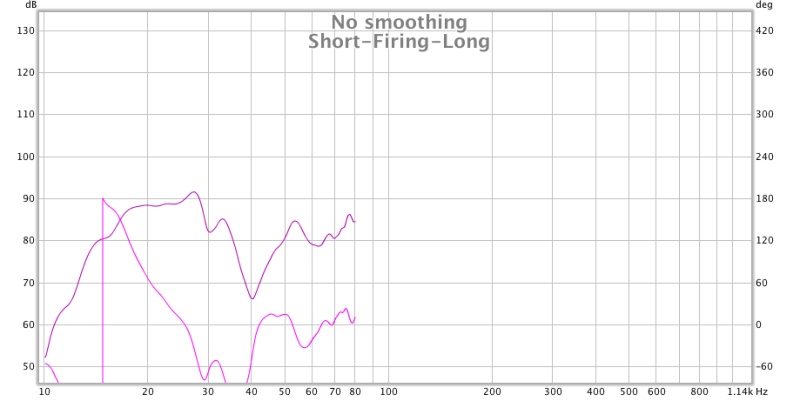

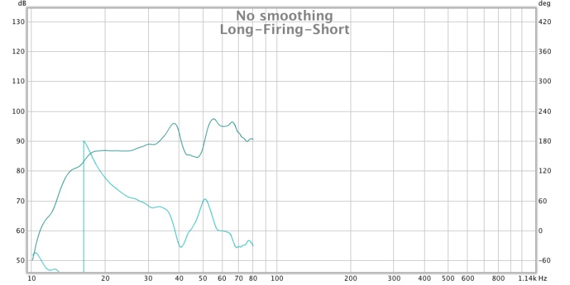

Alright, here we go. With the subs placed along the long wall, there's a bit of a null in the 40's, but I can tame the peaks a little around the edges and fix it up a bit with some EQ.
But take a look at the train wreck of what happens with them placed on the short wall firing longways.

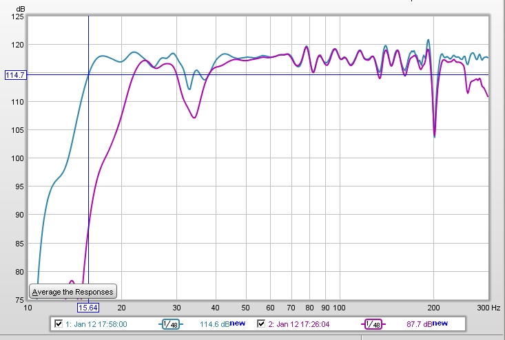

Back in Jan. when I was testing the first OD_ML_TL cabinet that I built, with a 6 ohm Lab 12 in it, I took a 15 Hz to 300 Hz sweep but found a big hole at ~ 34 HZ.
Then I moved the cabinet about 3 or 4 ft. further into the room (8 ft. from the wall instead of 4 ft.) and I got quite different results.
This was with the exact same setup.
I will admit that I was surprised by the apparent F3 of the second sweep which seemed to go down to maybe 16 Hz.
I have a question. If I set the limiter on my Crown XTI-1002 to say 29.0 Volts, would that represent 200 Watts (29^2/4.19) or is the amp limiting to 29 V peak?
I seem to not get all that close to X-Max with 29 V limiter settings which does not agree with HRSP at all.
Anyway, here are 2 sweeps with the only change being the position in the room.
No smoothing, no Eq
