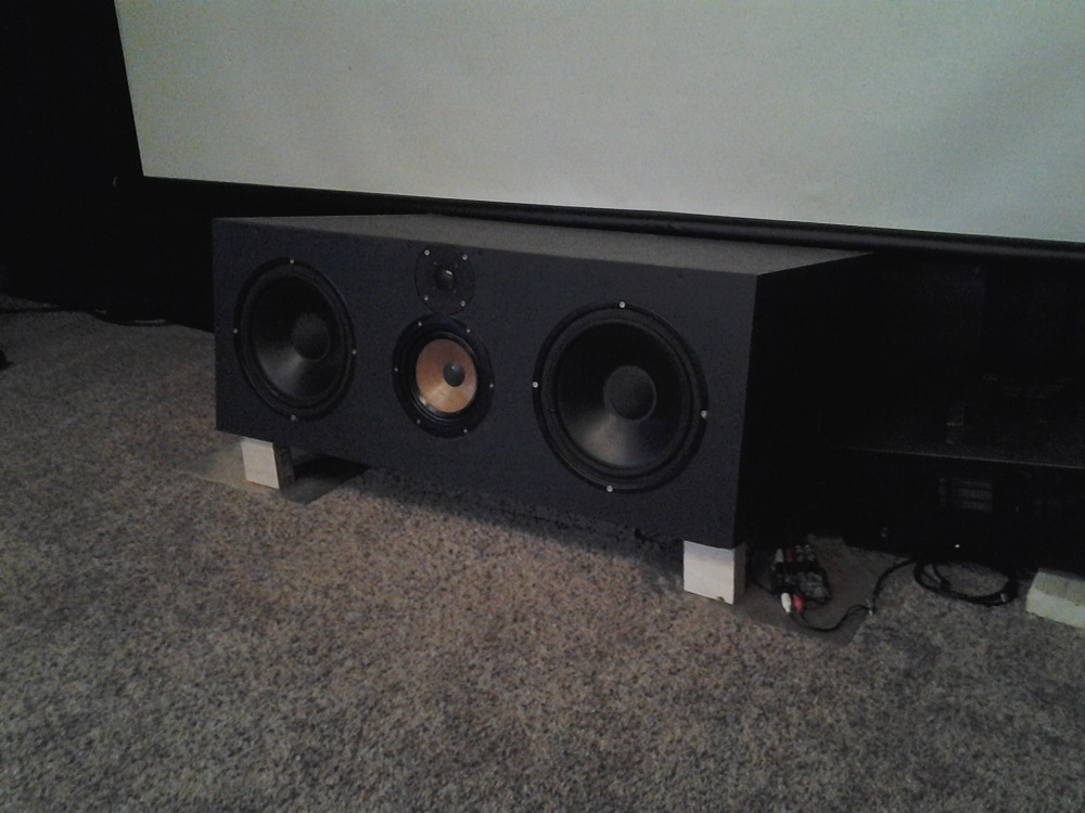

So, then I was considering what to do with the empty prototype cabinet that I punched a bunch of holes through.
Hm, wouldn't that size of cabinet make a really beast center channel?
Why, yes it would. And the crossover was a snap because these subs are relatively flat, so I haven't bothered with the MiniDSP. Makes a dandy crossover for a 3.5 way center.

NICE!!! Way to go on adapting a used enclosure for another function!
I have a habit of reusing cabinets if I can find something interesting for them...I've still got half a dozen empty cabinets kicking around here.
One question, I came across some 1/4 inch glass pieces that are pretty much the perfect size that if mounted in the side of the cabinets of the od-ml-tl would do a pretty fancy job of showing off the driver. Do you guys think a 1/4 thick glass panel that's about 5" x 12" would shatter if I were to route a lip and silicone it in there next to the driver?

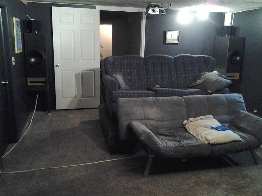

Here's the final spot, and one of how close they are when you're on the couch.
I think I might try to make some woofer porn for youtube later.
Edit: Pardon the "not quite done" look of the room, I'm still working on it off and on.

Now that is a center channel, I bet it can keep up with most any mains. Nice! Glad to see the subs are working out. I have the movers packing my drivers tomorrow for the slow boat back to America, didn't want to keep them in the enclosures because they seemed safer in original packaging.
Ha, yeah, its different from the old one for sure, and it cured a big problem I had with the subs at the back of the room, deep voices rumbled way too much from the back of the room which made it a little bizarre, but I was able to set the center crossover in the htr to 40 hz so that problem is gone.

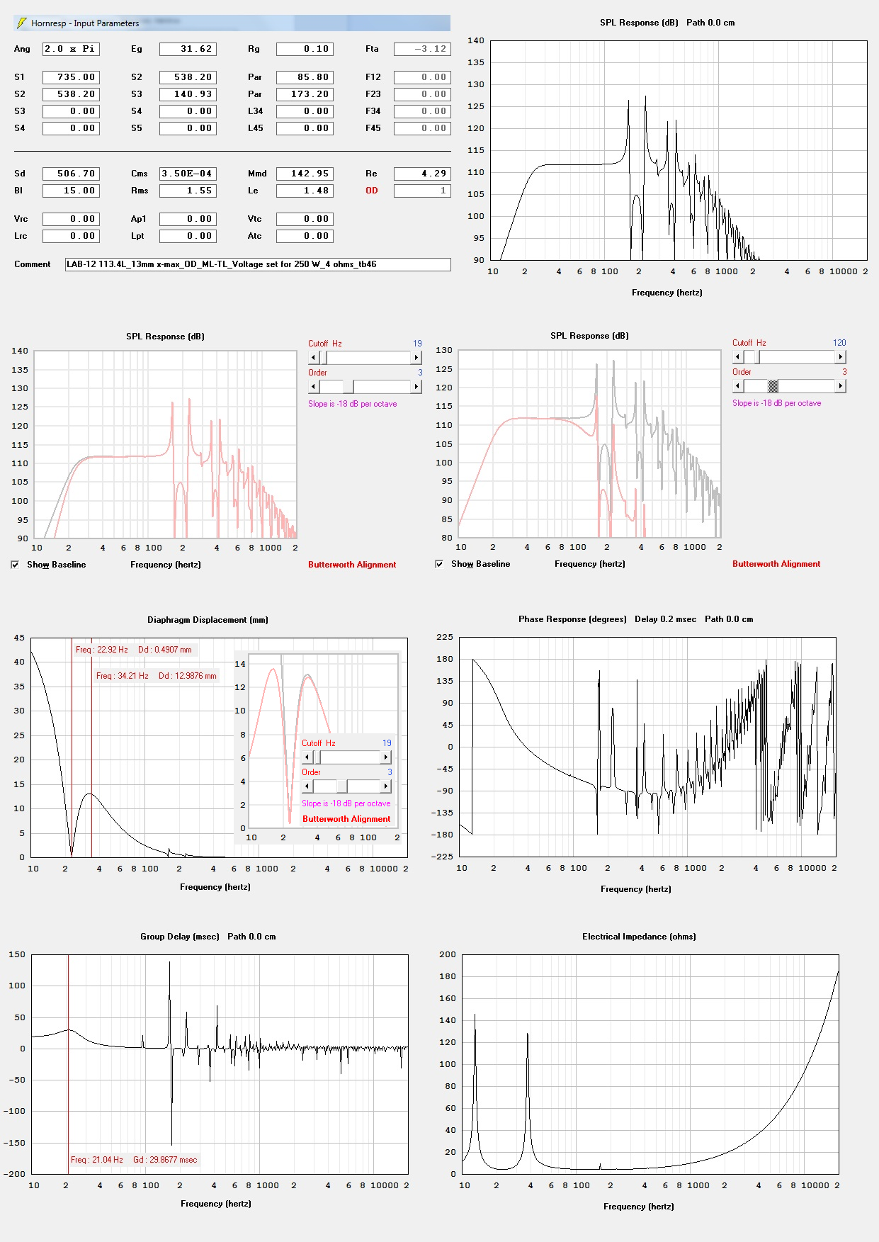

After months of planning, changing directions, and rethinking I am moving forward building a pair of the transmission line subs. tb46 has developed a smaller form factor of his design from a few pages back and is currently finalizing putting the "electron" model into a "wood" plan. I was going to go many different ways as I kept changing my mind, but at the end of the day I wanted to do something different.
Based on latest iteration of the plan, the enclosure will measure 25.5" H x 25.5" D x 16" W. Once finalized I will post and develop the cut sheet. Dual subs will be powered by an Adcom GFA555 amp (for now).
Internal dividers will have around a 3.2 degree angle. I remember reading on one of the tapped horn build threads that when using PL adhesive you don't have to cut the panels to exact degree. Would appreciate any feedback on whether I need to cut the internal dividers at the angle or will the PL adhesive fill the gaps?
I am hoping for an in room response of 115 dB @ 1 M per sub (250 W/4 ohm input). I guess time will tell. I have REW and a calibrated Cross-spectrum Labs calibrated EMM-6 USB microphone. Once subs are built I will try to figure out room measurements.
