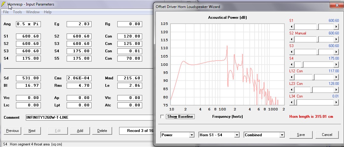

Hi kees52,
Post #292: "...the flares on the gegin and end off that port to minimixe noise and losses can not properly be drawn in hornresp..."
You could use the OD driver arrangement to simulte a OD MLTL w/ a normal straight port, then use the Nd driver arrangement to simulate a standard vented box w/ a similar internal volume and port, and then convert that simulation into a jet port simulation. You could then transfer that jet port design into your drawing for the OD-MLTL. Or you could just go to AkAbak.
I'll attach a Hornresp export file for a jet port example.

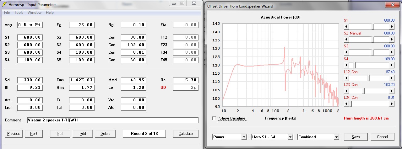

Here a sim with isobaric wsp 25s visaton woofers who already have seen some differend homes, not a problem because she have not to pay rent.

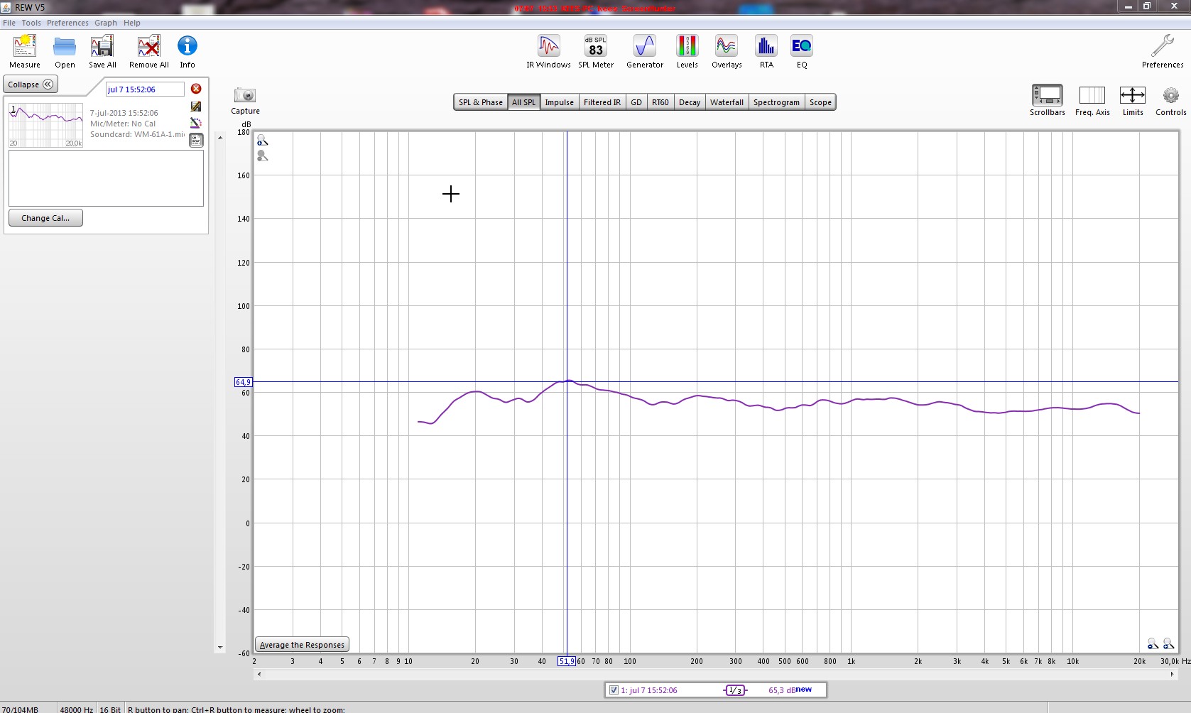

And a picture of the open baffles left and a T-TQWT on the left in corner, this do sound very good, I like ripole bass a lot, see last picture the measurement of the open baffle/T-TQWT.
First picture is of a OD-ML-TL, I did like the efficienty, this photo is the visatons in isobaric, it is ugly afcourse a pointing out speaker in such system other then the T-TQWT.

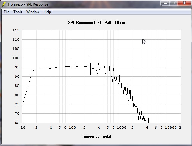

TB 46
I have done the sub like you say, I have tune the pipe on the same low point as te original ML-TL, and put it together in the sub itselfs giving it that noiseless port.
Do you have somewhere also a akabak example?
see text so you can see if I are oke.
thanks
kees

Hi kees52,
Sorry, but I have some things coming up that'll leave me very little time. I'm attaching the Hornresp AkAbak Export for the Hornresp simulation in Post #293. It seems to work fine in AkAbak (after you change the extension back to .aks).
