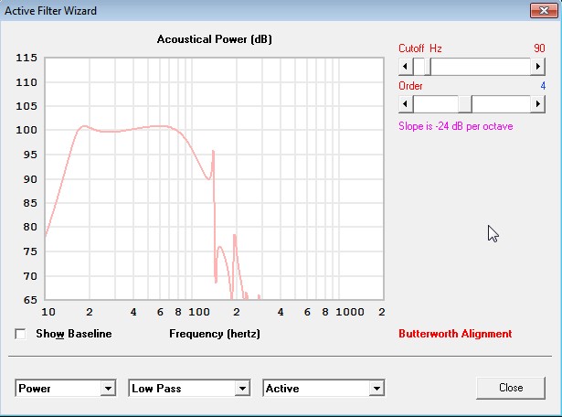

I did sim a box for the infinity 1260W but not have build it yet, to busy
find a classic car, get wood with the bike is problematic.
The box is simmed without damping with low pass filter selected.
And one without low pass filter and damping added.
The jet liking port is separated simmed and after that exported to the design hornresp can do not both in one go.

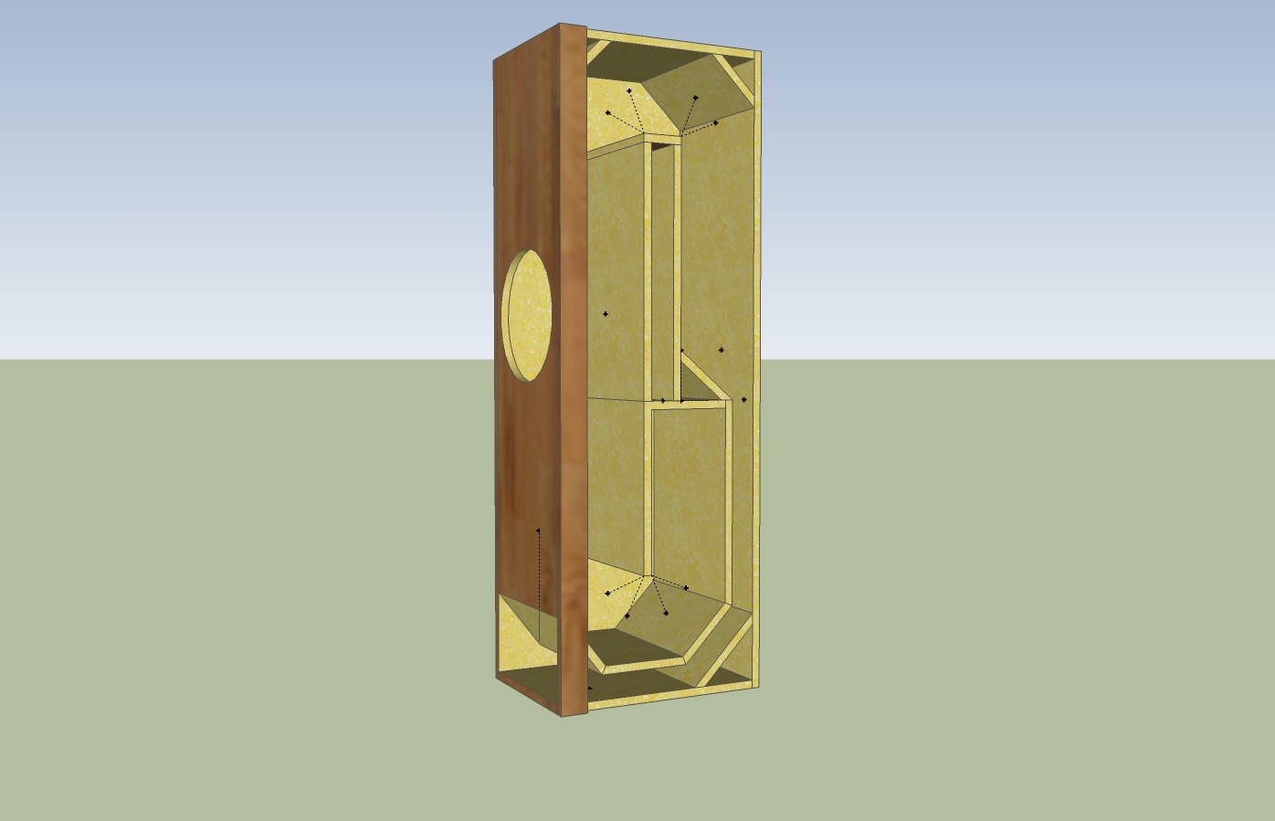

I haven't made any sawdust yet but I ran the sims and 'sketched' it up for an old pair of JL 10's I've had sitting around for many years
And yeah I even took an evening to draw the curved grills & drivers components as separate pieces and assemble them as groups
How come you sim'd CON instead of PAR?
Cause I wasn't paying enough attention, I just changed it and it made a difference of 11.47 cubic inches (0.188ltr) and the sim response didn't change so I'm not worried about it. Thanks for pointing it out though

Great looking 3d model there!
How do you display the 3d model and HR sim tilted on same screen like that?
Can't wait to hear your listening impressions and measurements.
That does look cool!
Tundra,
Thanks! The model view is a 2d export from sketchup, the HR was a screen capture. I opened the model pic in photoshop and added the screen capture with the HR sim as a new layer, cropped it and then used the transform-skew tool to give it a 3d look

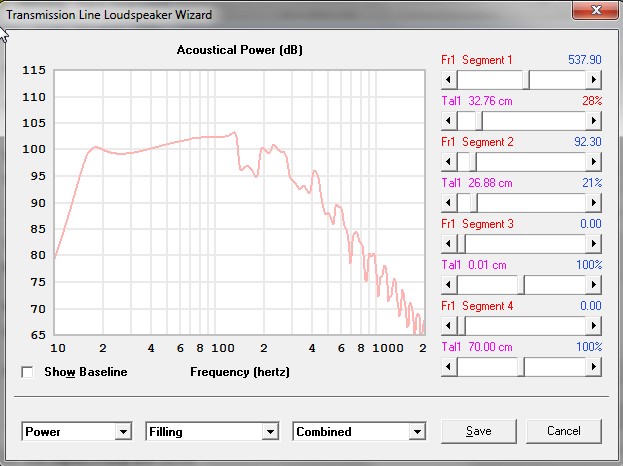

Dear audio mates,
I'm really attracted by this design!
OD-MT-TL let me imagine a transmission line with limitate dimensions, where I can put my Infinity Ref. 1260w.
The purpose is to make a sub for music listening.
I never used Hornresp but now I perceive its power. Having such an instrument for free is amazing, in the hope to obtain a good correlation with measured data. I enjoyed a lot in using it, in these days, especially the "Speaker wizard". But I'm a novice on that and I don't try to add stuffing nor implement electronic filters.
I attach a result I can suppose good. It does not reach an astonishing extension in low frequencies, but features limitate GD, low overall volume (77 liters), and a not too narrow (178 cm2) exit port.
Regarding the folding, I never do that, but bjorno suggestions let me think about it.
I imagine a folded enclosure (like post #273) with a inner depth of 35 cm (to include the speaker). We should have:
S1 = S2 = 580 cm2. So 580/33 (35 - 2cm bracing) = 17.5 cm for the first segment, long 65 cm, going from the back to the middle of the speaker.
S3 = 178 cm2. So 178/33 = 5.4 cm Hence the second segment starts from the middle of the speaker (width 17.5 cm) and extends for 67 cm to reach 5.4 cm.
The third (last) segment is a constant height (5.4 cm) with a leght of 76 cm.
This port, although not too narrow, may have a final flare to improve the result.
I hope some more experienced members can comment, correct, suggest some improvements.

Greets!
Your sim is somewhat different than the OD-MT-TL and can be simplified to a simple one fold TQWT plus ideally should be tuned to Fs or a little lower, making it a little larger with output to 20 Hz where it will need a hi-pass to protect it for some music, movie LFE:
GM
GM
GM, thank You very much for Your suggestions!
What do You mean with "Your sim is somewhat different than the OD-MT-TL" ?
I think Your simpler shape has a comparable construction complexity, isn't it?
I agree that this will require a good "rumble filter"
I also agree that the enclosure should enhance the emission at low frequencies, possibly lower than Fs. Mine do not.
Your simulation is immediately more efficient in that!
Anyway 106 litres of Volume brings some unwanted issues:
1) worst impulse response and group delay (Is there some method to fight that?)
2) quite big enclosure
Music listening, differently from film watching, possibly requires fast impulse response (a lot of audiophiles prefer a sealed enclosure, although with EQ correction).
My simulation features also a great defect in the "acoustical impedance" (peak over 500 ohm) while Yours is under 300. I don't well understand what does it means. Does the the speaker suffer more loading when acoustical impedence is high?
I attach an "intermediate volume" simulation where I limitate the volume to around 90 litres and where acustical impedance is now under control. There is deliberately a peak around 30Hz that should be smoothed with filling...
What do You think?
