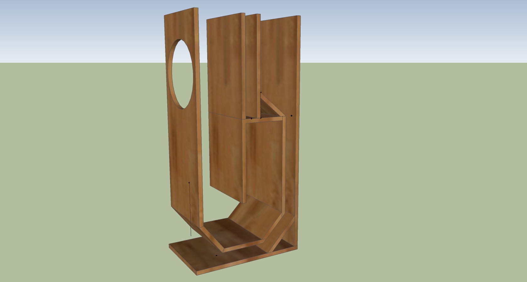

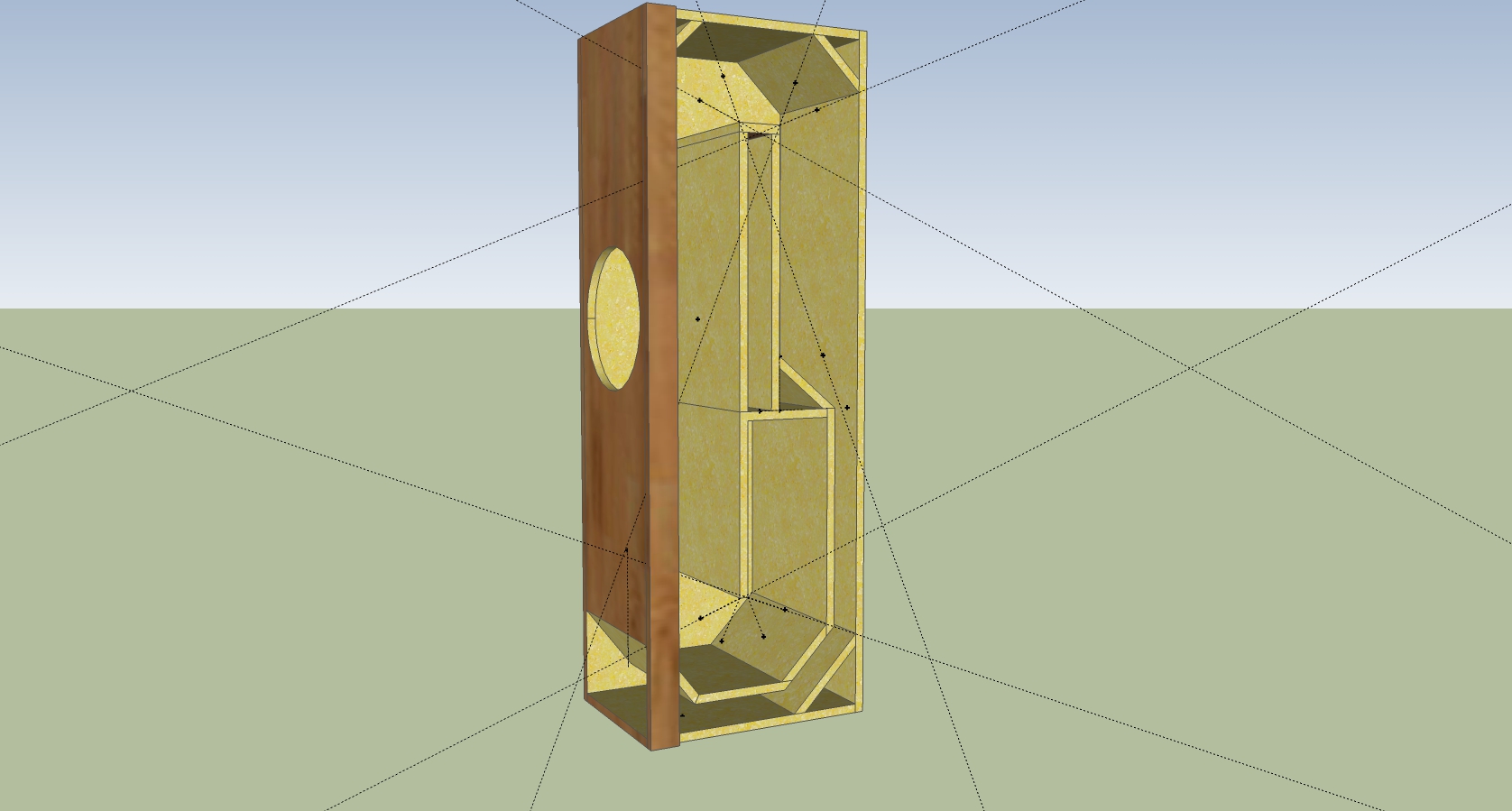

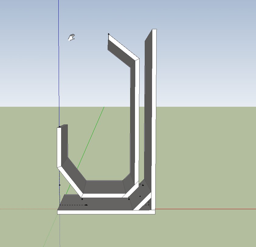

I am been busy with drawning that box, but the long pipe is challence me, this because the box do go low for the movies.
I have to make it deeper so the pipe get lower, etc.
I am this far the rest will come.
regards
kees
That long pipe is really no different than this flared port.

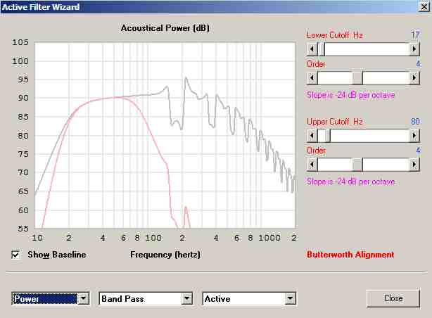

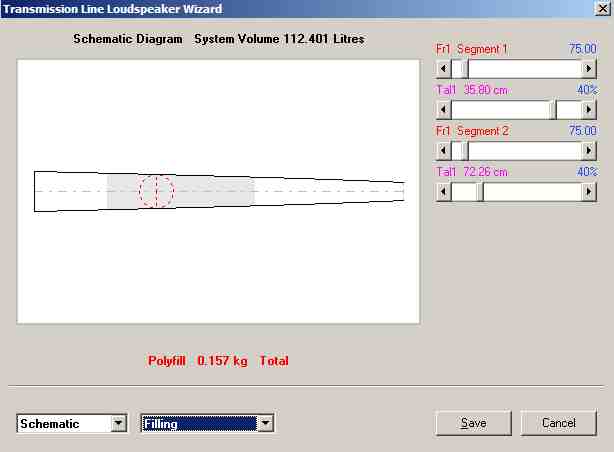

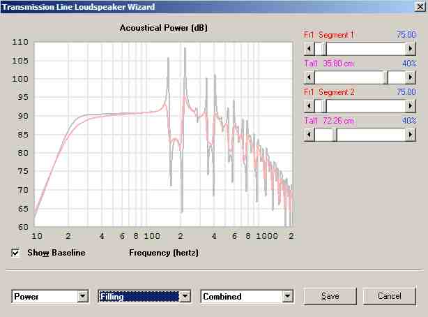

Interesting...if I can get by without the felt I would be pretty happy as they don't give it away. Will try some light stuffing with fiberglass or pillow stuffing near the S1 end. Would be nice to reduce some of the calculated ringing above the LPF that could be audible. However don't want to reduce output.
Posts # 270/273/275/281
Hi Y'all,
Hornresp has come an amazingly long way since this was first simulated. I'll attach a suggestion as to filling and filtering for MOD3:
Hi Y'all,
