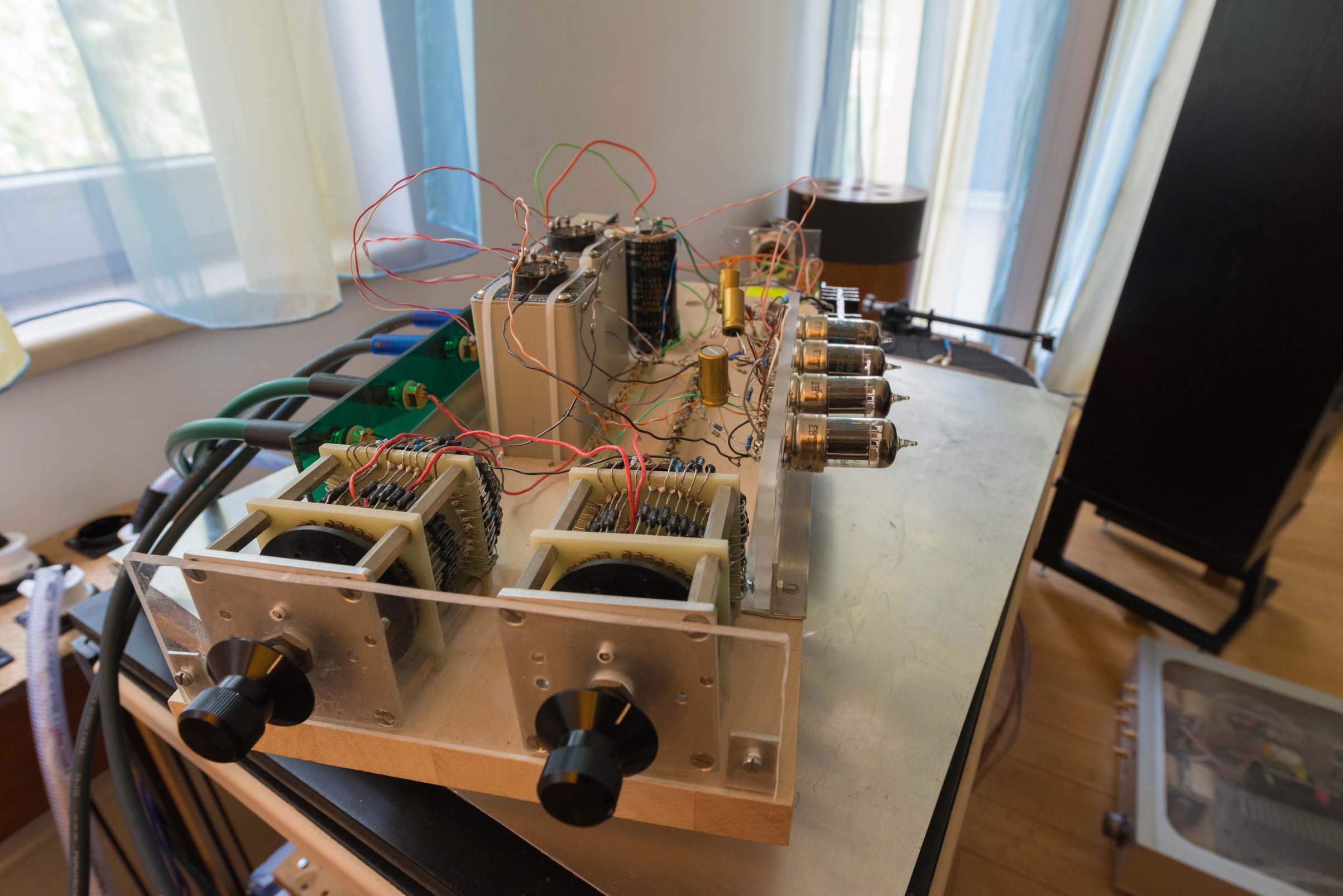

In most of my builds i try to use Shallcos in preference to Elma, Kozmo, Daven and pretty much any other form of attenuation i have tried. Which, incidentally includes quite a few ICs and a few cmos switches. Unfortunately even Shallco are not perfect as the silver alloy forms sulfides which the self cleaning action of the wiper cannot really clean. Not to mention the central contact. So, at least once a year the Shallcos go for chemical cleaning which is messy and disruptive. Apparently the good old Davenoil is no longer available as if whales are more important than the protection of silver 🙂

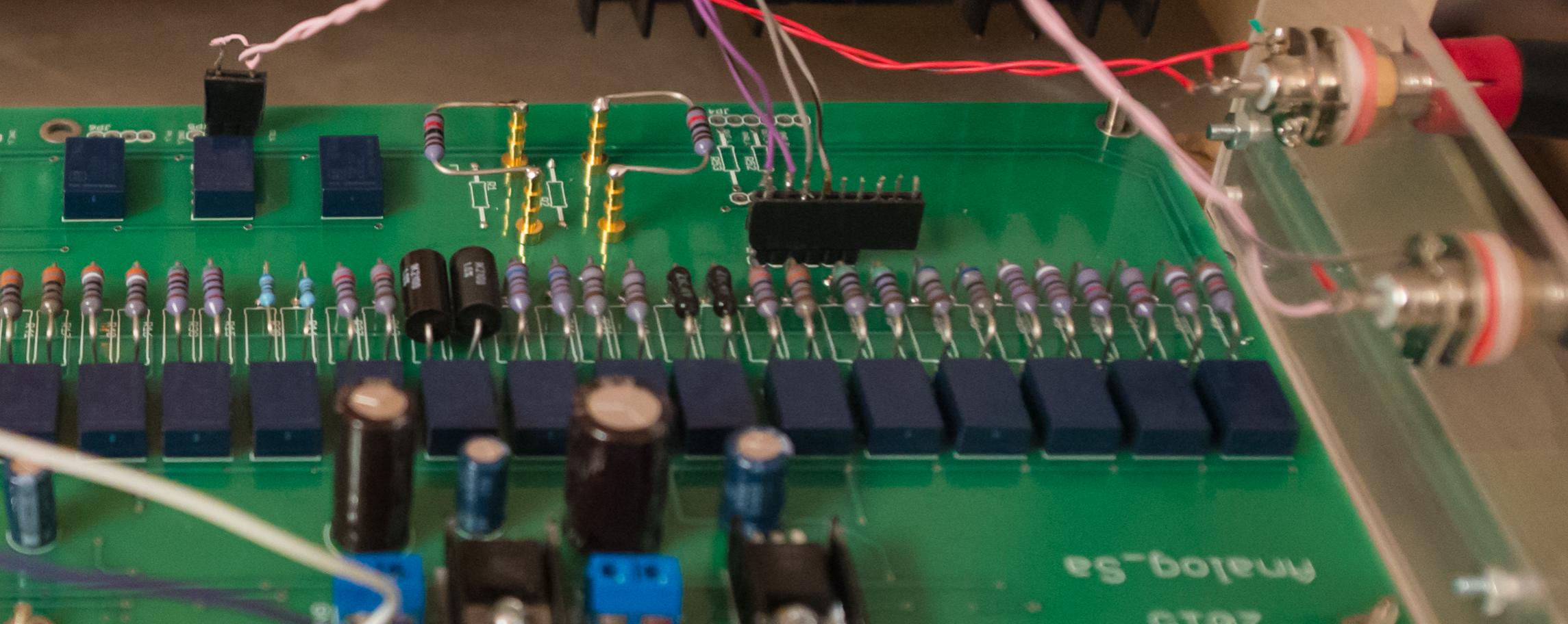

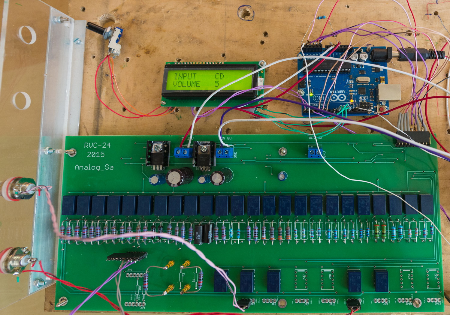

So, my latest proto uses a 24-step shunt relay attenuator vs a 48-step ladder Shallco. The ladder is almost entirely populated with old stock Holcos, whereas the shunt uses Shinkoh in most positions at this time. Having listened to a few relays in the past i chose Pana TQ2 in preference to quite a few others including Clare mercury. I also find that the relay contacts are less audible when not energised, so the control is "inverted": all relays, but the one for the chosen volume level are energised.
Of course the relay attenuator sounds different but it seems i can live with its sound. The fact that it is maintenance free, can easily accommodate a remote and provides a visual indication of level closes the deal for me.

A slight preference for the Shallco, but of course they do sound very different using different resistors. As for transparent, i honestly cannot say; the Holcos are very organic and calm, the tantalums have more air but slightly brittle highs... maybe the brittleness is partially due to the relays. Then, there is the pcb... vias have been enhanced with copper wires but ideally i should have used the tracks only for control signals and all signal wiring should have been raised above the board.
Last, but not least, the shunt attenuator provides an easy and cheap option for balanced operation which the ladder does not.

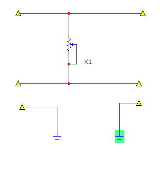

Ladder attenuator is perfectly usable as balanced attenuator if the ground connections are kept separate. Just like a standard pot can used as a balanced attenuator by connecting between the hot and cold lines.
You cannot pull this with a ladder, you are talking about a shunt. Or at least i cannot see it happening. Care to explain with a schematic?
🙂 There is zero electrical difference between ladder attenuator and a standard pot electrically, except the continuous track is broken into discrete steps.
But you still need series resistors at the inputs, right? To utilise a ladder as a variable resistor appears extremely wasteful, but yes, you can do it. What kind of law it will follow and how many steps will be useful is anyone's guess.
