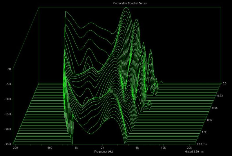

Well I finally got around to fiddle with ARTA to move ahead on producing CSD's (lest I find myself dishonoured due to prolonged inaction). For these tests I left the drivers in baffle, which has two drawbacks - 1. not a huge separation distance to the rear wave, ca. 50 cm path length difference at a measurement distance of 50cm, which limits gating to 1.5 ms or so, and even there I had to gate longer to get a minimal FFT sample size; 2. woofer to close to the floor, with euqal consequences for the gating. Basically, very restricted badwidth and lotsa artefacts. I post it anyway, for reference and comments, and hope to repeat in a proper large test baffle in the future.
Here is the SS8543 6.5", first.

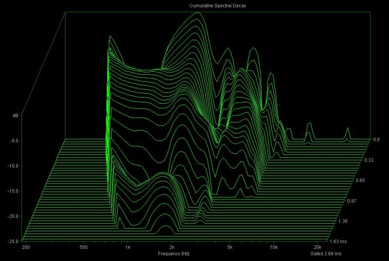

And here the 15ND930.
Unfortunately the range covers hardly anything in the passband, which ideally should be below 1.2k for the 15" and below 2k for the 6.5". Interestingly below 1.5k where the data start to matter wrt to a WG'd tweeter crossed low, both drivers show a fast initial decay (partially hidden by the following time slices) and then a rise, in the case of the 15" in fact two additional "waves". Now I am not sure if these are reflections (diffraction? floor?) or driver generated stored energy (especially those later peaks in the sub 1k region for the 15"). Anyway, to repeat with a more rigorous setup.

Hi
The resonancies moving up in frequencie during decay are most likely due to reflections (floor, walls or cabinet).
Furthermore it seems you have set te time window in the time domain too late - cutting away for the first impulse rising slope and thus the FR completely.
For a wider frequencie range repeat your measurement with placing the speakers as far from floor and any wall as possible.
Use a a time window much longer than the 2.69ms now. ''I fYou use ARTA set the FFT points to the maximum of 1024 when sampling with 44100 Hz.
If you use a 24 bit soundcard you can easily increase the range of the diagramm to 30 dB and the decay time to about 10 -30 ms
If measuring only a single speaker you can place the mic very close - even 1 cm in front of the diaphragm.
This way you should be able to get results similar than here:
http://www.diyaudio.com/forums/showthread.php?postid=1202358#post1202358
"http://www.diyaudio.com/forums/showthread.php?postid=1202358#post1202358"
greetings
Michael

Michael,
I set the impulse window to start before the initial rise of the impulse. The FR when viewed as pure FR looked OK, but you are right that the t0 FR of the CSD had suspicious "holes". Maybe the CSD windowing compounded with the initial impulse windowing and ended up chopping away data.
To get a 1024 bit FFT CSD I would need at least a 10+ ms window: ARTA required a 2.667ms window to get 128 samples for a 256 FFT so this needs to be x4. But that's 3.43 m path length difference from direct to rear wave / reflected sound, i.e. a wall mounted speaker or mounted in a baffle of 3.43 m diameter... or I need to build a box to the backside (your beautiful graphs were done in box as I understand). I can't physically lift my speakers, that's for sure.

CSD: slowly getting there. The SS8543 plot starts looking believable, though it still has a funny "shoulder". And I still can't quite believe the woofer plot, it must be too close to the speaker's foot even when measrued at the cone. Good point about the groundplane technique, this is what I use for regular FR and EQ, all else is hopeless in the critical 100-400 Hz range. So that might work for the woofer.
One trouble I have though is that the exact position of the impulse window has way too much an influence on the CSD. Set the start a bit too close to the impulse start and the FR gets truncated for the first slices. Set it a bit too early and there is no decay. And between these extremes there are just a few FFT samples, that is, microseconds. Will the correct setting please stand up??
Something else that begs the question, is - I (we) might get a good CSD comparison for raw unimpeded drivers in the end, but does the measurement problem not show that the plain driver CSD might be a very unrealistic assumption? Just plain baffle effects seem to have a large influence on the CSD, and in the case of a dipole, the rear wave seamlessly joins in right after the direct sound has decayed. The smaller the baffle, the earlier, right in the time slice magnitude of typical CSD plots. Still, dipoles sound "transparent".
