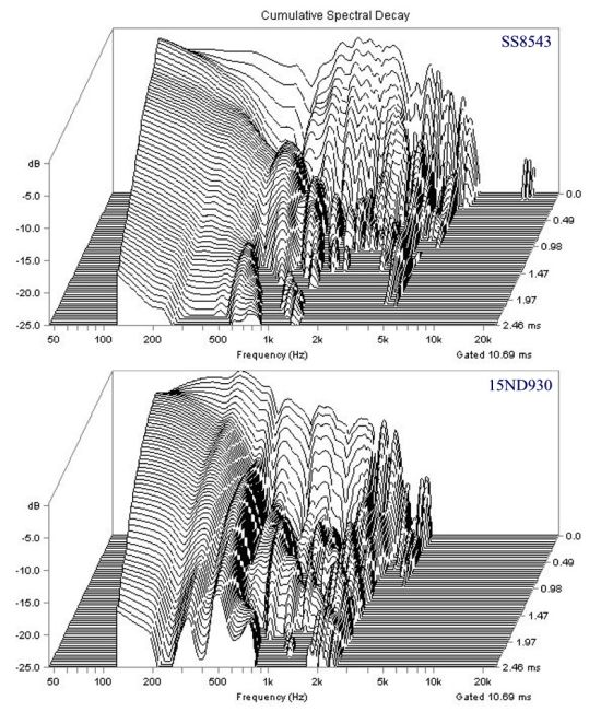

Some thoughts about decay, reflections and spaciousness
While trying to measure CSD of my woofer's in-baffle I reviewed a couple of things about the physics and hearing mechanisms involved. Here it goes:
Firstly, CSD measured in an OB like mine simply must have a lot of artefacts for a variety of reasons. With a path length difference of ca. 18" or 50 cm, the rear wave arrives about 1.5 ms after the front wave. 1.5 ms period or 50 cm wavelength correspond to 680 Hz. Take this and it is clear that the rear wave must influence the CSD very heavily below 1000 Hz and no amount of windowing can change that. Basically, just one cycle of 680 Hz will already take 1.5ms. So if we window at 1.5 ms for an already-lousy frequency resolution and add further time slices after that... we immediately get the addition of the rear wave to the CSD. It can in fact be seen in my CSD's, and Paul's as well, that soon after a first rapid falloff there is a lower level "shoulder" and I believe this is the attenuated rear wave.
Now, I think we agree that dipole midrange sounds airy, transparent and has "depth". [So do large ribbons, line sources, but not so many horns if one goes by anecdotal evidence]. Why do they (and especially, why if their CSD must look bad given the delays involved)? Well it appears that 0.7 ms is the absolute minimum integration time of the ear (and I wish I knew where I got that reference from). Signals closer together than this will get confounded by the ear, and if this time window contains reflections or other sound mirror images, there will be "smear", and below 0.7ms, the less delay of reflections/diffraction, the better (narrow baffle, say). 0.7 ms corresponds to ca. 25 cm or 10" path length difference.
Above this threshold, progressively, and especially >1.5ms, things get better again. While not capable of perceiving an echo yet, we then interpret the delayed signal as "airiness" and "openness". And such a delayed mirror image of the original signal could be a baffle reflection, room reflection, rear wave from a dipole, or the delayed signal from the far end of a line source. From this line of thought the above mentioned should sound open and airy, and they indeed do.
This effect works for1.5 - 10 ms delays, according to Griesinger's papers. Between 10 and 50 ms, reflections seriously impede speech intelligibility, the large room effect, and >50 ms is again less critical because we then perceive clear distinct echoes.
So conclusions? Here are my half-educated guesses:
1) does decay not matter below say 1k? No necessarily - *if* the delay of the rear wave in-baffle (or line source delay, or room reflection, or large baffle diffraction, or horn reflections and mouth diffractions) is >0.7ms and ideally >1.5 ms then the rear wave will not get perceptually "smeared" together with the direct sound. Then the decay of the original signal does matter.
2) how to measure decay below 1k? Either Linkwitz style or CSD with driver in box or in-wall. Possibly unbaffled driver for a very short rear wave delay and peace after that for an undisturbed decay.
3) how to make horns sound "airy" and "open"? No horn reflections in the 0.7 ms window (good horn profile, rapid expansion, dampening materials), and either
- a wide angle WG to allow for decent amounts of room reflections, especially laterally, or
- a horn mouth large enough to put secondary signals produced by edge diffraction outside the 0.7 ms / 25 cm window, calling for a diameter of ideally, 50 cm or more
- in combination with a large mouth, possibly a conscious provocation of edge diffraction to add the "air": say in my case the WG will have a smooth roundover to a flat baffle, but the baffle then continues until a total width of 60 cm (24") with just a 1" roundover to a 90 degree baffle edge. So I'd expect this project to sound "airy" now to satisfy my grand theories here
- variation of the above: staggered diffraction edges on the horn mouth, sort of a coarse, fractal like feathering, to get a whole spectrum of delayed mirror images. Say, a mouth termination that starts at 20" diameter and irregularly extends to say 30", in spiral fashion, with lots of "ears" of different sizes and shapes etc.
Such a horn would then sound airy and open even without any room reflections.
Thoughts?

I believe driver CSD on a small open baffle should show some influence of the rear wave. After a speed of sound delay, an attenuated rear wave will arrive at the microphone. Attenuation should increase with frequency and phase will likely be random...so there should some +/- undulation in the decay display. For driver decisions, I doubt this is a big deal because we can see what the driver is trying to do in the first few time slices. On the other hand, if we were preparing driver marketing sheets, we'd want to use an infinite baffle for the cleanest possible chart...no wrap-around and no diffraction. Measurement closer to the driver will improve the S/N ratio (noise being the rear wave). So, at least broad brush, I think we agree so far.
However, my personal experience is the fewer reflections from anything within 6 feet or so of the drivers, the better. This includes walls, furniture, cabinet edges, and sharp-edged waveguides. At least for me, getting rid of the close-in hash improves clarity/articulation. (this preference shows in the 8" radius roundovers in my avatar and near constant use of felt to attenuate the rear wave) While I don't care for reflections coming from near the speakers, I really do like the lack of box coloration. Of course this is just one person's opinion...YMMV![xeye :xeye: :xeye:](https://files.diyaudio.com/forums/images/smilies/xeye.gif)
If you're interested in staggered diffraction edges, there is a patent showing a dish antenna shaped like a scalloped star with rounded major and minor points. This might do what you are thinking but the inventor's purpose was to reduce the diffraction signature by spreading it out. If you can't locate it on Free Patents, I have it somewhere.

MBK..
wow.. that WAS a lot of thinking for a friday..
However I've seen this problem before.. (your delayed and reduced in level "parallel" decay pattern between 600 Hz and its nasty resonance at 2 kHz).
Its incredibly ironic though, considering how this deviation from linearity is generated, when comparing a good bit of this thread's content..
Its a bad horn.
I.E. directivity has its price when "paid through" cone geometry.
You'll get this same effect in-box as well (..a long with other "perpendicular" decay artifacts generated by box resonances).
This was something I was trying to caution Lynn on early in his Ariel + thread.

Point taken - and part of the reason I want to keep the door open with 2" compression drivers and a generous-sized horn, so I have the option of moving the crossover downward if I want to. The option appears to be more or less foreclosed with 1" CD's and smaller horns. Put another way, it's a halfway house between the smallish typical HF horn/driver and the monster Oris/Lowther setup that's popular in Northern Colorado.
We saw an interesting idea quickly flash by in an earlier post, and I want to draw more attention to it. Simple in concept: cut Karlson slots into the edge of the OB, with the "point" of the slot facing the driver. Not many slots, either. So if a driver is fairly close to one edge (i.e. 7" from centerline to the edge), but is farther away from the opposite-side edge (11.5" from centerline to other edge), you cut a Karlson slot into the farther edge of the OB.
I think you guys can see what I'm trying to do - blur the wavefront coming around the edge of the OB. Similarly, 3 or 5 Karlson slots could be cut into an (expendable) plastic horn, which should diminish the symmetric standing waves. This should be easy to check - just look for the characteristic triple peak in impedance to diminish (the most direct evidence of HOM's in horns).

To clarify my talk about CSD shoulders - I was exclusively talking about *OB's* - not horns - it's what I get when measuring my 40"x24"x7" OB. That's when the rear wave comes 1-1.5ms after the direct sound. Listening impression of this configuration is a very nice depth, like the main singer standing in the room in 3D at a specific location. That's what got me into the delay tangent, why this type CSD leads to this type of listening impression.
Pano - Lexicon: no coincidence here: Griesinger whom I quoted for all the delay references *is* the Lexicon physicist-in-residence.
Paul - "dish antenna", yeah that could also be a way of describing what I have in mind. And, have fun with the line cords!

In truth.. it isn't that big a deal as long as the standing wave "resonances" are down low enough in level (less than 9db) and it isn't "too" high in freq. (..i.e. keeping it under 1kHz should be fine.. and in fact most crossovers will overlay more linear decay distortion, though the distribution will be more uniform and completely "die" a lot sooner). It does *look* odd though.
I'm not sure I "get" the shape of the Karlson coupler for open baffle.. The only OB designs I've seen for this have been fairly normal "Karlson" positioning for a sub (and also a "split" sub).. (..presumably to give a bit more air compression effects in the upper bass response, i.e. make it more "energetic" sounding.)
If the desired result is to reduce diffraction effects for an open baffle then I'd think the best bet would be an edge, (..at least for the baffle's sides), similar to the trailing edge of flaps on an airplane:

Here is my "best" in-baffle CSD for my two woofers, 6.5" on top, 15" bottom, baffle 40x24x7", no EQ, 10 ms gate, at 10 cm measurement distance, over a thick futon on the floor. Both clearly show the "shoulder" below 1k starting around 1 ms into the CSD.

MBK said:Here is my "best" in-baffle CSD for my two woofers, 6.5" on top, 15" bottom, baffle 40x24x7", no EQ, 10 ms gate, at 10 cm measurement distance, over a thick futon on the floor. Both clearly show the "shoulder" below 1k starting around 1 ms into the CSD.
Yup.. Surface stored energy. Intermixed with the "normal" resonant character of the driver.
Now the resonant energy around 500 Hz (and lower) that appears as "perpendicular" ridges in the 15ND930 looks like a box resonance, but is likely a frame resonance.
No question the dipole "bump" is a resonance. But I don't think it's a 1/4 wave resonance of the 7" depth. Also my point was, *only if you EQ* this and other resonances and rolloffs away, can you then see the actual driver constributed stored energy decay.
I actally think these are all windowing artefacts from the CSD, which itself has a 0.2ms window rise time. Not to mention that say, 417 cycles corresponds to a period of 2.4 ms, so the 2.4 ms "decay" duration shown in my CSD plot only corresponds to *one* full cycle at 417 Hz, and less below that.
