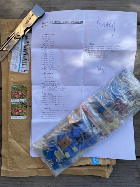

And we start again. I made a careful component inventory referencing the kit list, parts bags and schematics. Completely accurate thank you.

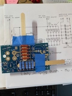

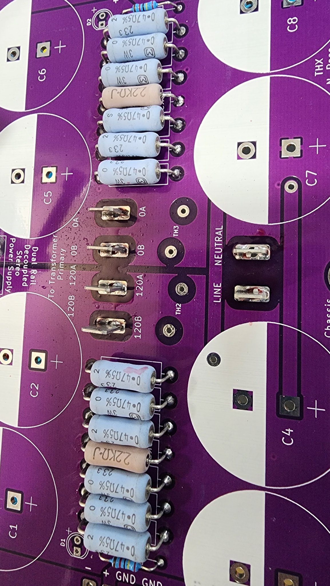

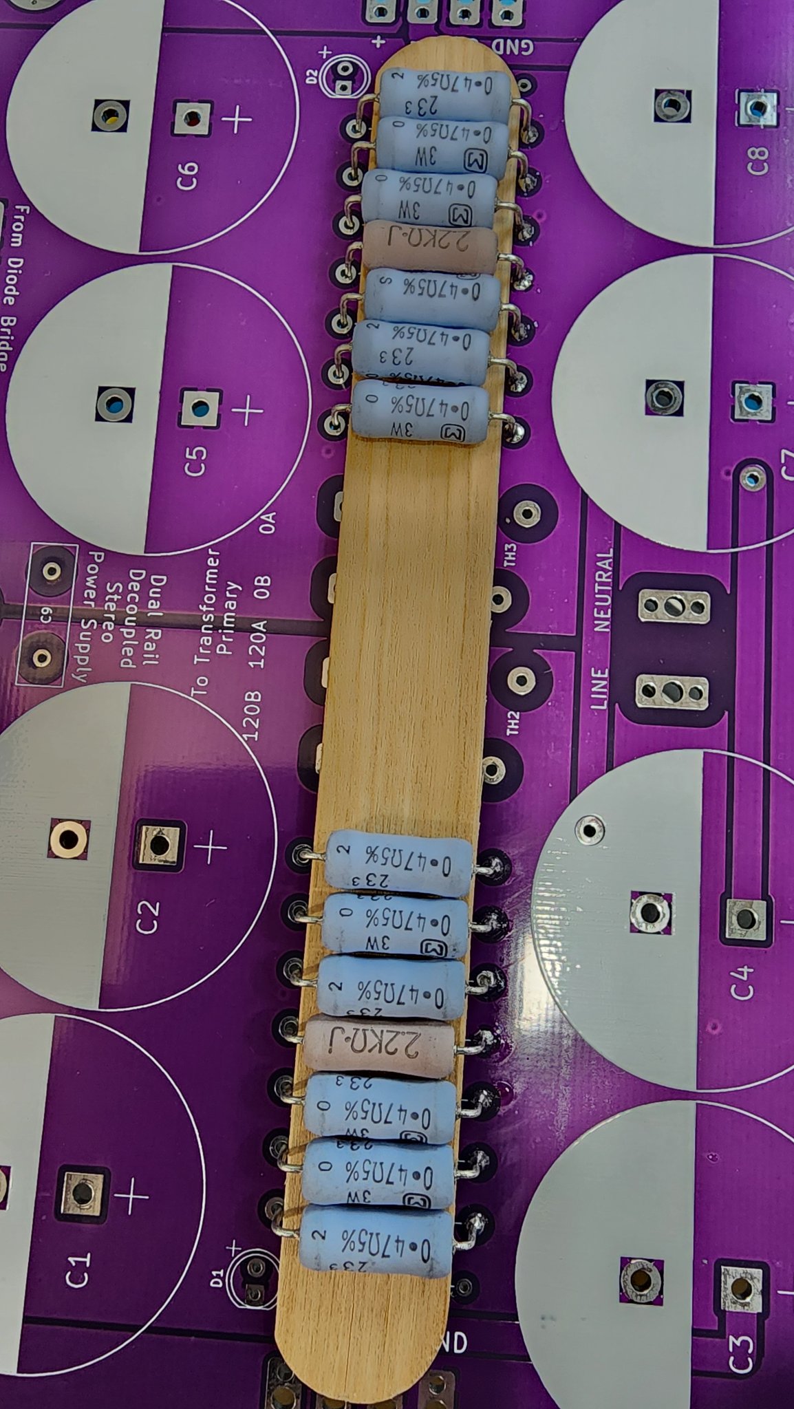

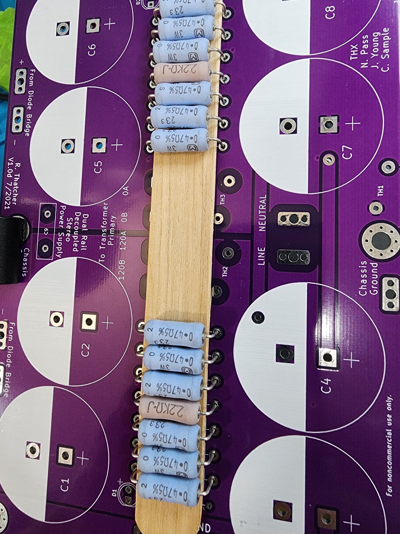

Well that's just genius. I had to give it a try and sure enough the toung depressor size works as well.Thanks ZM and Ben! Mu resistor popsicle
What a great solution to something I know I struggle with. Worked great and slid right out after soldering legs!
Thank you @JKiriakis !!!
@birdbox glad that worked out. I have used carboard or toothpicks in the past which don't work as well as popsicle sticks. Yours are even better.

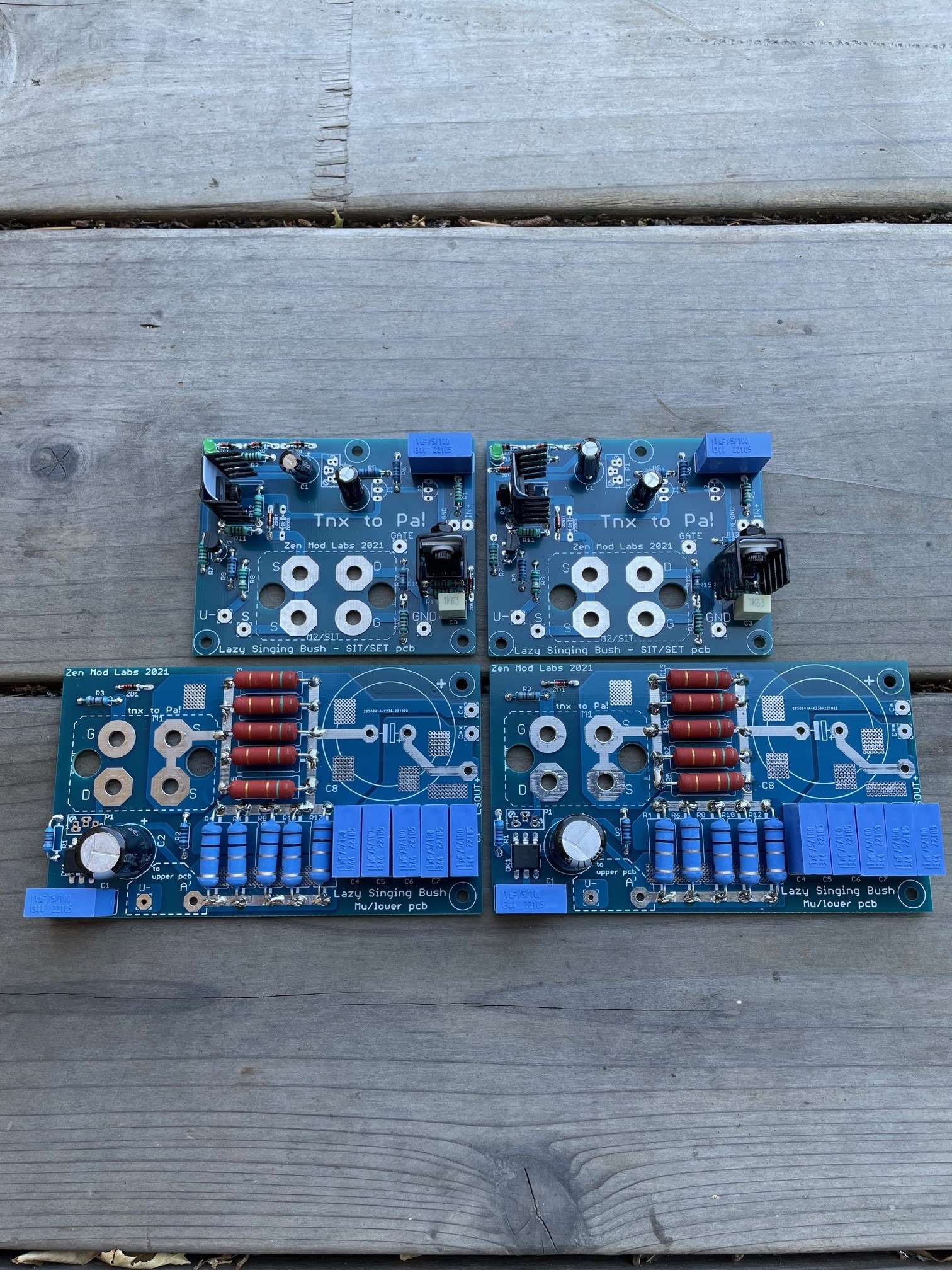

@Zen Mod two quick questions please:
1) how do I orient OK1 which is the 4N35 on the Mu PCB? (EDIT - found the pinout diagram, I see now the dot on the device is adjacent Pin 1anode which connects to Pin 5 collector on to the positive side of C2)
2) is it advised to pre-set trimpots P1 (5k on the SIT board) and 10K on the Mu board)?
Thanks in advance!
naah
they usually arrive from factory somewhere in mid position
perfect for startup
