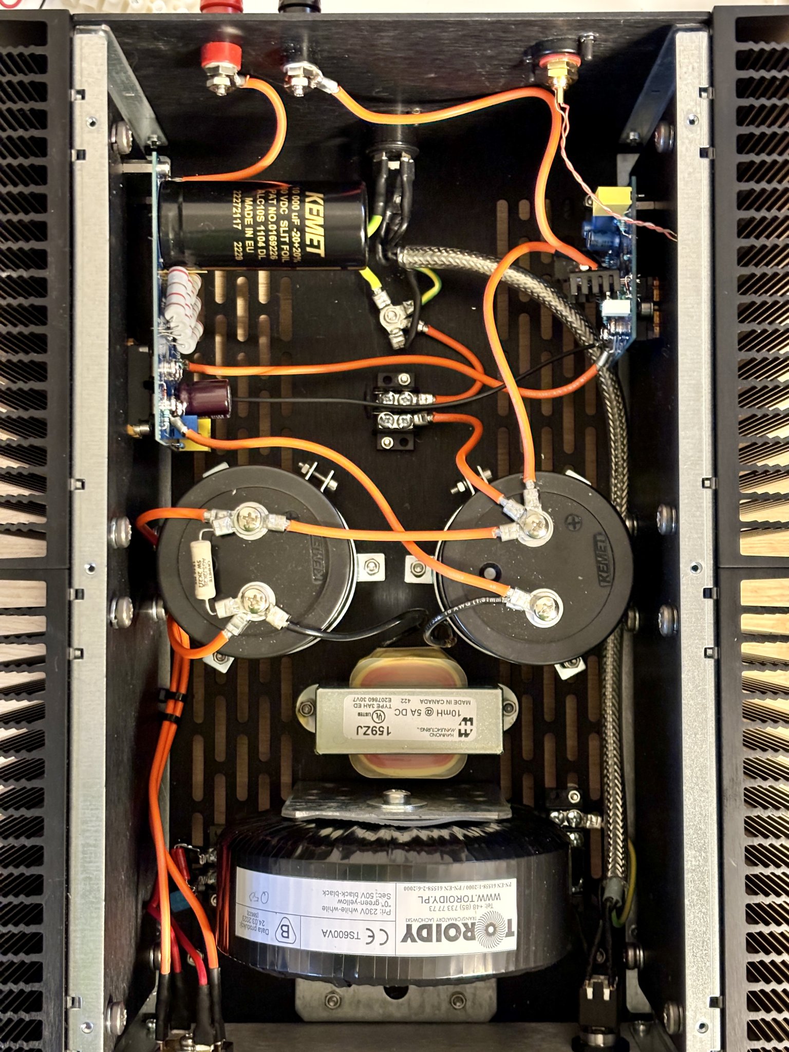

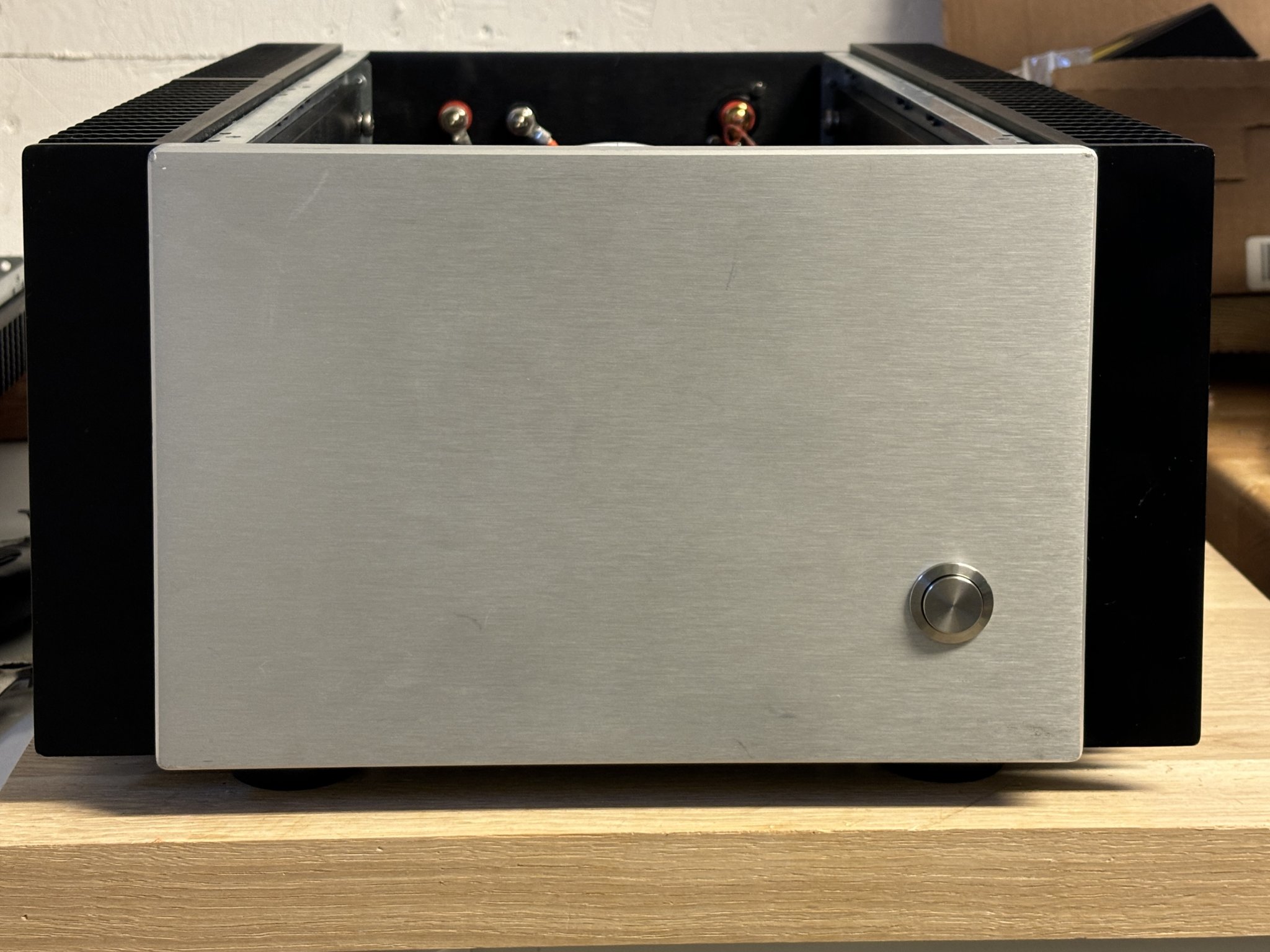

One LSB is almost ready. I must order a shunt resistor before I try to hold the magic inside. :)

Official Court Jester
Joined 2003
clarify/confirm which value of resistors you have there, confirm is it schm from page 1, say what Iq you want to set
if you have sum value of 0R4 of 10 resistors group, just say yes
if you want more Iq - go back with 10K trimpot, put whatever you have instead of 8K2 - say 3K3 or 3K9
then fiddle with trimpot(s) again
