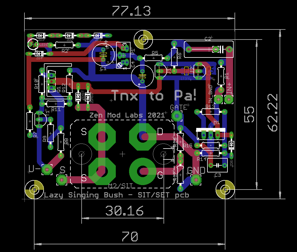

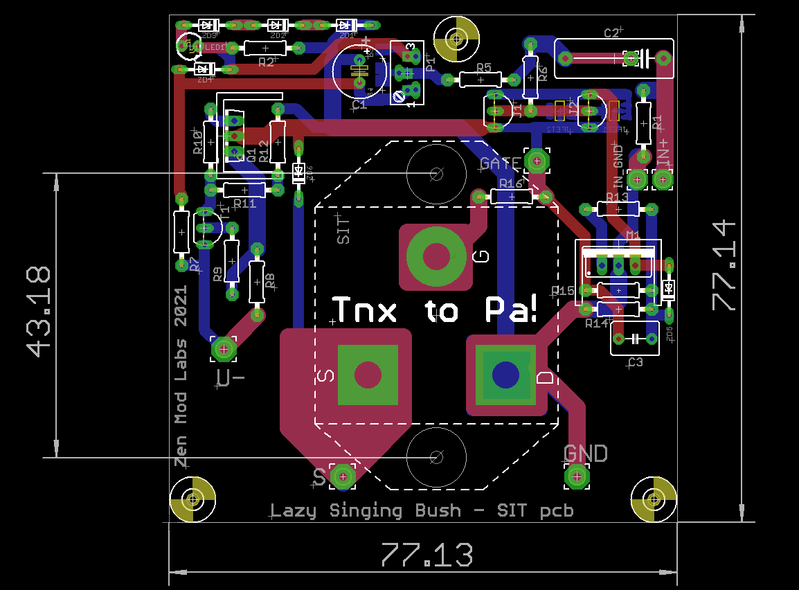

Ok, so a 2SK77B has same "form factor" as the "puck" MOSFETs?
It is nice to see distortion profiles with dominating 2nd and a bit of 3rd and then other harmonics almost zero.
go back to page 1
in first several posts you can see exact performance of pure MOS, Schade MOS, and SIT iterations
all 3 laid out with all necessary graphs, sans Papa's most beloved giglywigly showing superimposed main and residue - I'm too lazy to arrange that test, too much hassle
Thanks! .....then I only need a translation of Shade MOSand difference between 2SK77B and IXYS puck form factors
I believe it is shown on Schade schematic, again page 1 (whatever your browser posts/page setting is)
shown in several threads around, trick to emulate SIT with Mosfet
not all goodies, but most
final result depends of arrangement and surrounding circuitry, but certainly useful trick

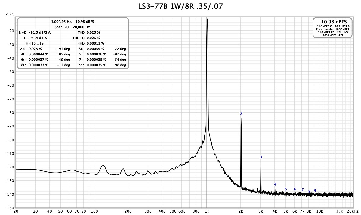

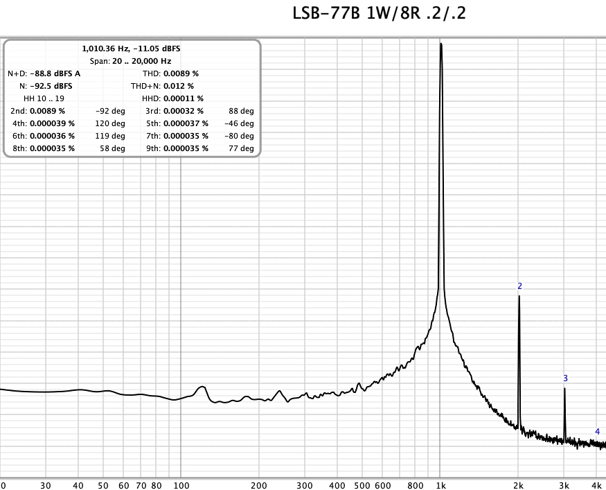

I've continued experimenting with mu values. Attached screenshot for .3/.13. Listened to .35/.07 earlier, and now working back up. Listening to .35/.1 right now. Granted I'm throwing most of the mu-fo advantage away, but its fun to play and listen.

Ok, one more measurement. This one .35/.07 – practically straight CCS. You can start to see more 3rd. and even some 4th creep in. So far, .35/.1 has been a sweet spot for my tastes.
Second image is an animated GIF showing the four measurement frames – starting with largest mu 'action' and ending with near CCS.
