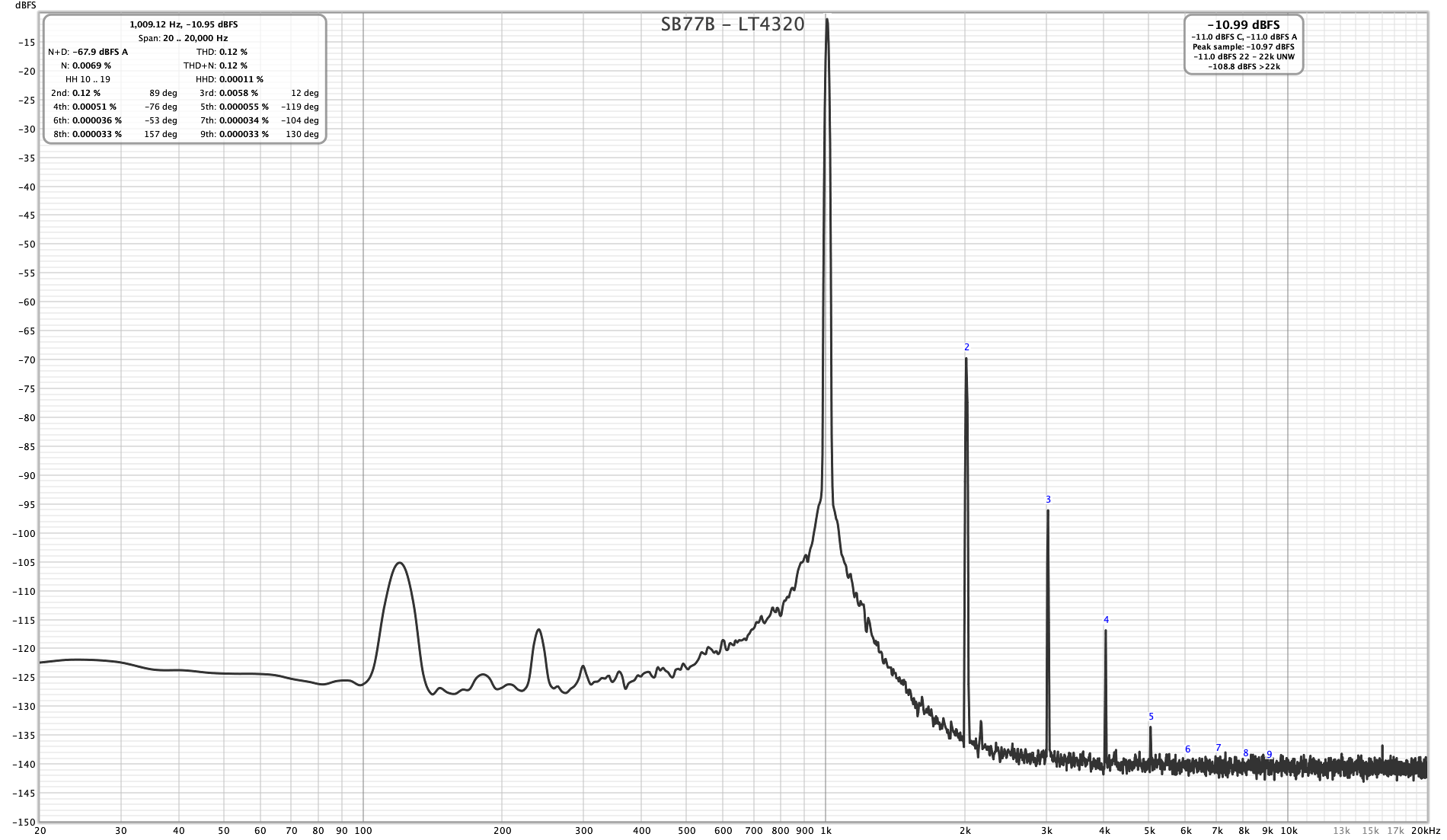

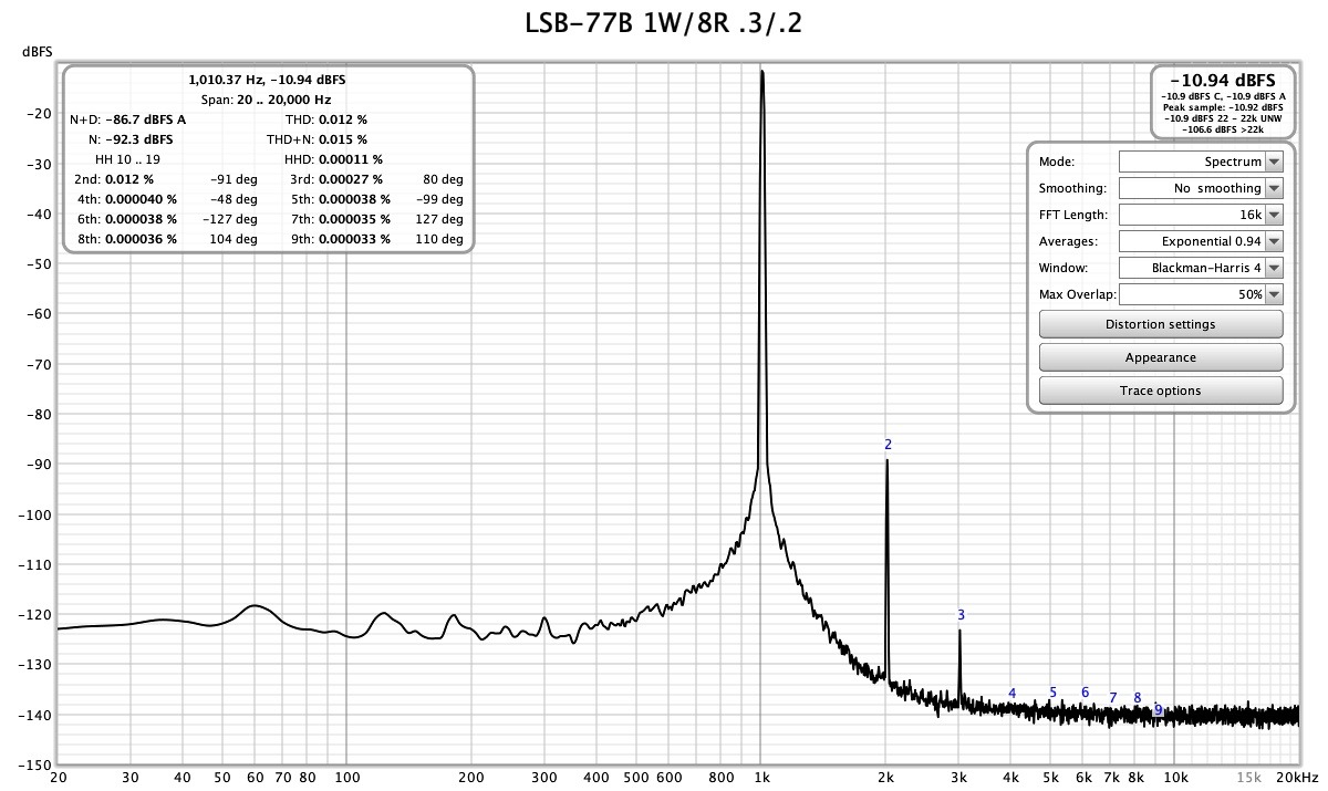

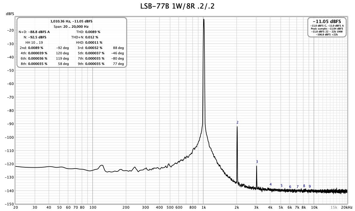

Attaching some measurements. Not surprisingly, it measures nicely. For me, it sounds very much like my Singing Bush, but slightly cleaner and with more of that lucid, follower character. Sounds great with every linestage I've tried so far. The first measurement is with the standard .2up/.2down mu arrangement. The second adds an additional .1 to the top, so .3up/.2down. Not surprisingly, losing some of the MU gain increases the distortion a bit, but in the end I prefer this combo. Also attached a measurement of my Singing Bush for comparison (same gain part, same PSU, chassis, etc).
