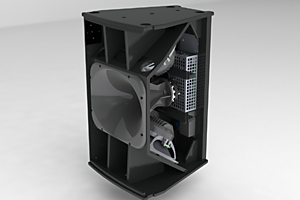

To cover 50-350hz I considering two options:
1. 4 x15" 2 Line arrows.
2. Something like this - mid and high horns surrounded from four sides by woofers. Not sure how this configuration will affect the sound.
I'm surprise by your graph, it's seems that your woofers flat from 40hz(???) up to 700? When I tried to model it in closed box they dived like a rock from 70hz. Is it a room effect?
