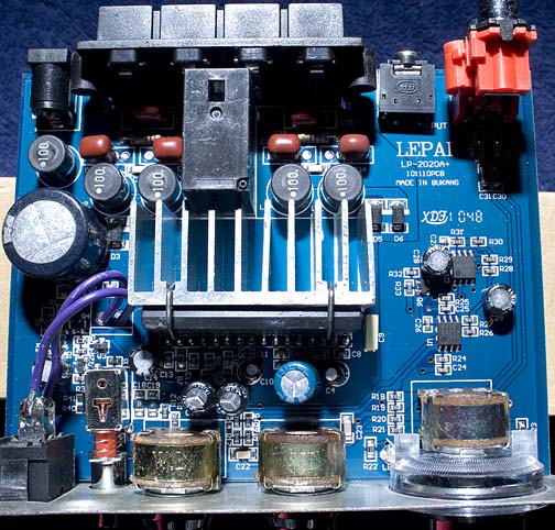

New to this forum, great stuff here. This thread is the reason why I bought 2 LePai T-amps, 1 to keep stock and the second to modify with all the great info here.
I ordered 2 from parts express, got a couple of day later. And just as jarros commented above it comes with a tone defeat push button switch. I opened one up and to my surprise and to my dismay it is a surface mount double sided board, some caps, inductors and relay are thru hole. It also have 2 op-amps JRC4558, why would it have 2? Any idea?
Looks beautiful! Already has some of the mods here implemented, nothing hooked to the mute pin, tone defeat. Values of components are not marked on the board. Going to make moding a little more difficult.

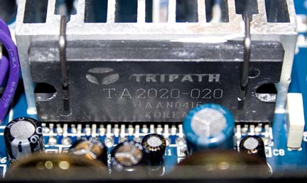

It is definitely a Tripath TA2020, at least that is what is printed on the side of the chip. It is not the one the previous poster showed, does not have the word “bose” on it.
As far as clicks, it has a relay after the chip, inductor and caps and before the speaker terminals. However, it does not eliminate turn on and turn off thumps, even though there is a delay.
The Power switch is not hooked up to the mute switch. I would have to take it apart to see if it is hooked up to the sleep pin, I do not know. I do know that the blue LED’s turn off when the switch is turned off.

I've been lurking on this for a while, but the unit I received is a completely new board. Over half of the components are now surface mount, and there's a tone circuit bypass button on the front panel. Interestingly when I press this button I get nothing but static, so I guess it's actually a tone elimination circuit. 🙂

Just opened my unit from PE that arrived today..it is the new one with the tone bypass.black case..says LP-2020A+.the chip is the TA 2020. Most all the board is pass thru still. the power stiffener on the left facing the front is 3300 16 v 105c japan.no extra diode there that i can tell. there is a big square black box right behind the speaker terminals that says OMRON g5pa-2 12volt. [I am new to all this so bear with me.] there still is a mild jump on turnon. I tested it at 10 o'clock setting with some infinity reference 2000.2 speakers and the bass and treble sound quite good with dire straits and cowboy junkies.Hope this helps.
just found the omron is a "Relay suitable for audio speaker protection",and yet i still hear a pop when i turn it on...hmmm
