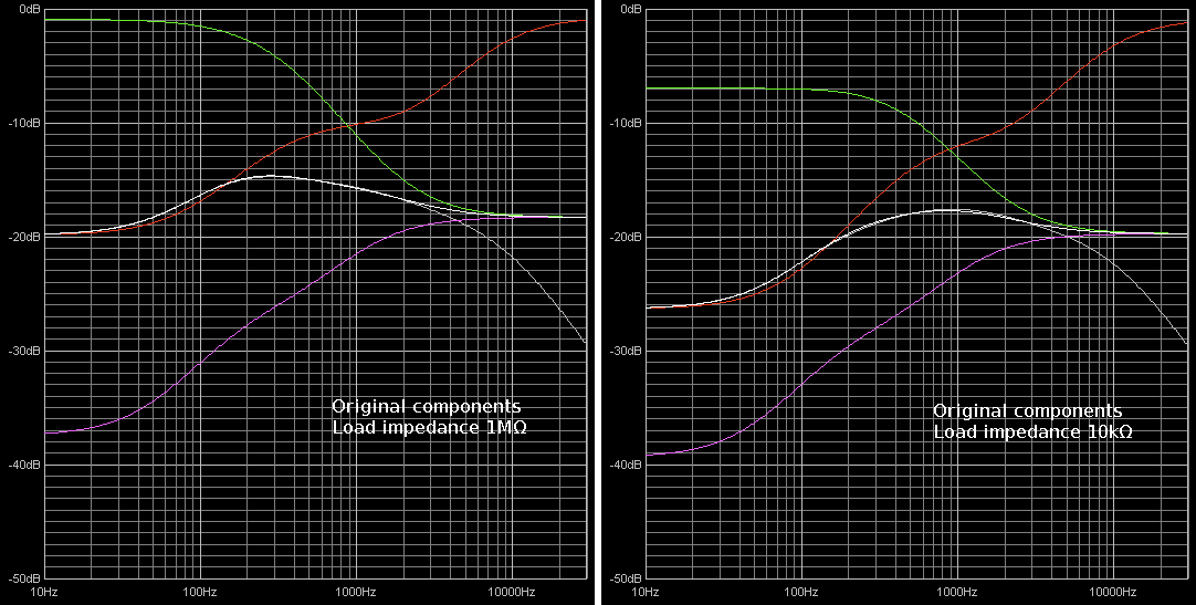

Has anyone analyzed the circuit on the newer models, especially the one with the two op-amps? I don't have one, but my guess is that the second op-amp sits between the output of the tone stack and the TA2020's inputs. There is a very good reason why they did this, and in fact you should either add this second op-amp if you still have a Lepai with one op-amp, or bypass the tone controls. I'll explain why.
The 'James' tone stack used in the Lepai only works well if it is connected to a load of fairly high impedance. But it seems that the input impedance of the Tripath chip is pretty low. I can't find any values in the datasheet but some sources say it's about 10kΩ. This is plausible, some other class D chips also have similar impedances when set to a high gain.
Attached are some images that show how the tone curves differ between a high load impedance (1MΩ) and low (10kΩ), both for the original James component values that were installed on my Lepai and the ones I replaced them with while I still thought the TA2020 had a high input impedance. As you can see, especially in the latter case there is considerable loss of bass and overall signal strength.
It may be possible to find component values for the resistors and caps in the tone circuit that produce good curves even with the low input impedance. But the capacitor values will probably be impractically high and even then the curves would still change with variations of the TDA2020's impedance. The only correct solution is to buffer the tone stack's output, and this is also what I did. If you look at the photo, you'll see a little ugly dangling board which is a simple op-amp buffer. The result is impressive: I forgot how much bass I missed in certain songs 😱. And that's not all: the power-on pop is almost completely gone, even when starting the amp non-muted.
The bottom line is: if you still have a Lepai with only one op-amp and don't care about the tone controls, then by all means bypass them. If you want them, adding a buffer amplifier is a must, as is replacing the components.

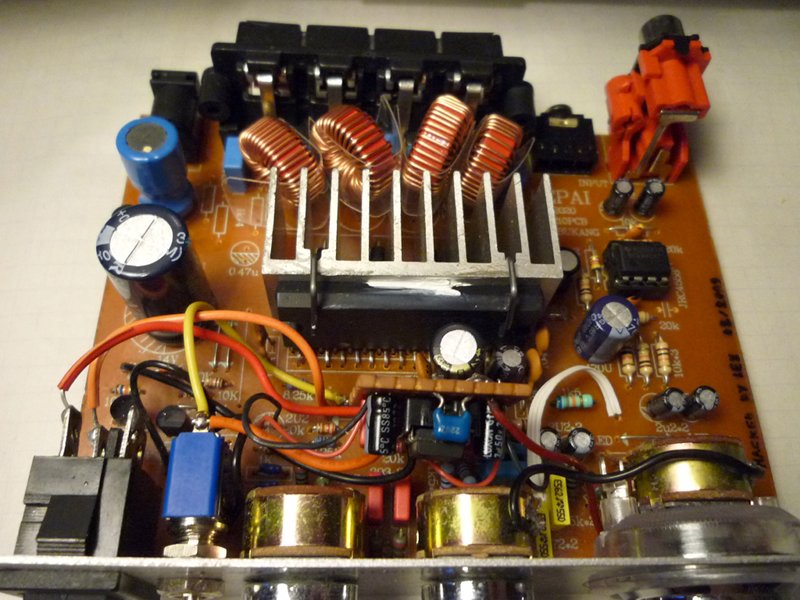

For those interested, this is a picture of the newest board (dual opamp and tone bypass).
There is no component underneath.

Inside they look like the image candoumi posted on this page which means some of the mods posted about earlier models aren't applicable. I'm wondering if anyone has a comprehensive list of things to do the the newest model, possibly in order of greatest improvement on down. ernperkins mentioned swapping the op-amps from 4558s to LM4562s but alas, I don't have any friends with SMD capabilities. I am also wondering if anyone has done a good test of the A+ model to determine what actually needs to be replaced after all of Lepai's changes to it.
[* I just had a closer look at candoumi's photo and it looks like the op-amps are marked JRC 456something.]

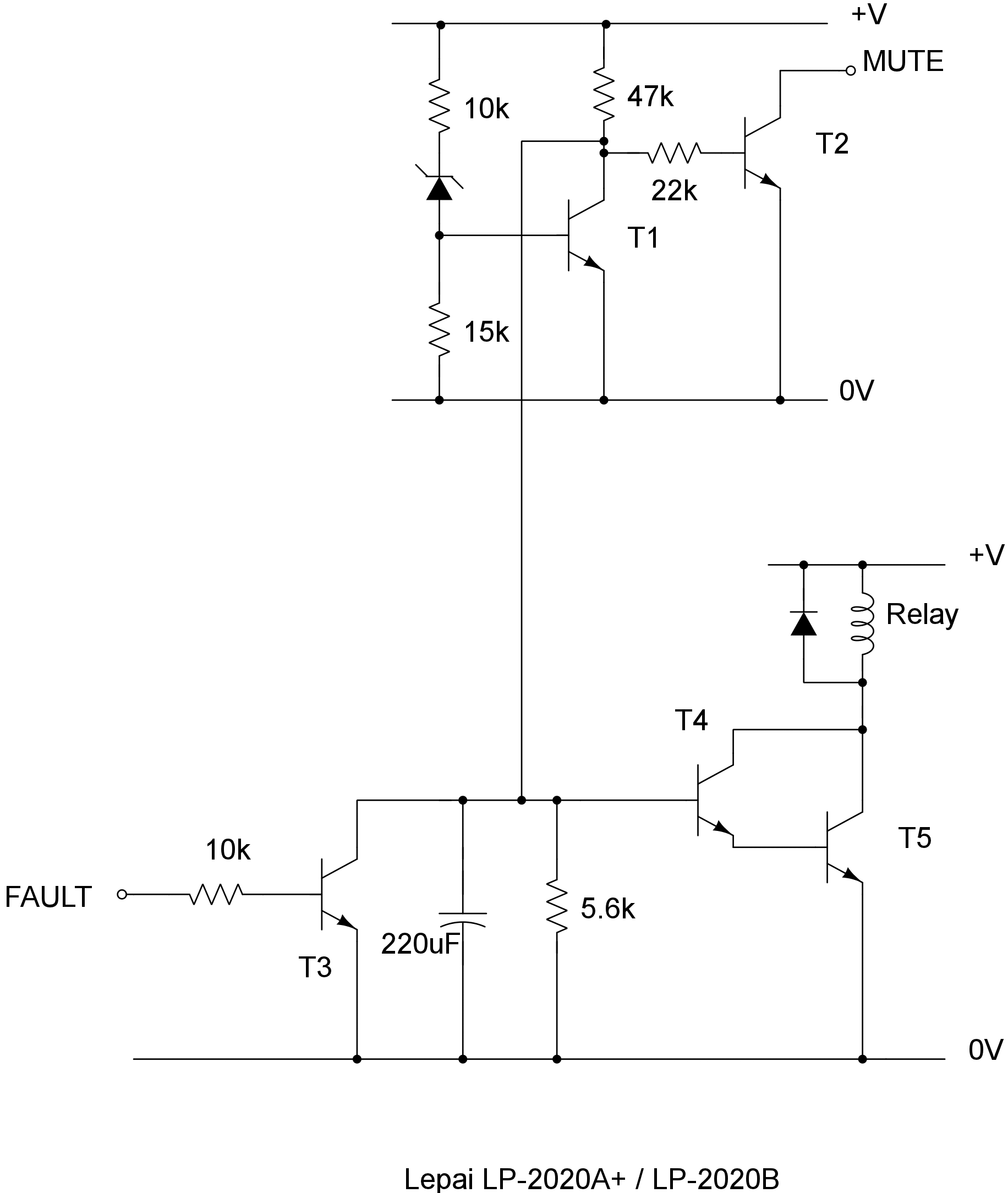

I got another one off ebay arrived a few days ago. Its an LP-2020A+ on the case, but the board inside is LP-2020B... It has the 'protection relay', surface mount components but only one op-amp. I mapped out the relay protect circuit, but I'm not convinced by it... Its still connected to the fault pin and looks like it will toggle the relay off if this goes high, but it is also connected to the mute/over voltage circuit. This will perform an automatic reset of the fault condition (see datasheet), which I don't think is desireable. Another thing - the relay only switches one side of each differential output - so for example, a short could occur on either pin and will not necessarily be disconnected by the relay. I'm not sure why this relay protect is necessary other than to prevent the switch on pop - but then why connect to the fault pin? From the tripath data sheet:
"The TA2020-020 is guarded against over-temperature and over-current conditions. When the device goes into an over-temperature or over-current state, the FAULT pin goes to a logic HIGH state indicating a fault condition. When this occurs, the amplifier is muted, all outputs are TRI-STATED, and will float to 1/2 of VDD."
What do other people think of this 'relay protect'? If I get time I'll draw up the schematic I have and post.
I've made the following mods to the new one:
1. Removed overvoltage circuit and relay circuit - tied mute to gound and added an LED to the fault pin.
2. Removed tone control/volume control and op-amp
4. Replace input caps with 2.2 uF (they were 1.75uF)
I'm very pleased with the result - it does sound much better without the tone controls as an earlier post suggested - better bass response, and I think the treble sounds sharper too. Using a 12V regulated power supply I don't need the protection circuit, or the extra diode on the output (data sheet says they are only needed for voltages >13.5V). The switch on 'thump' is minimal once the op-amp/tone control is removed, as an earlier post suggested.

Lepai 2020B relay protect circuit
OK, here is the relay protect circuit as best as I can trace it. It is all surface mount. The thing that concerns me is the connection between the fault/relay circuit and the overvoltage/mute circuit. In the case of Fault going high, I think this would 'toggle' the mute pin which resets the fault. But if the fault condition persists, will this lead to damage to the TA2020?
