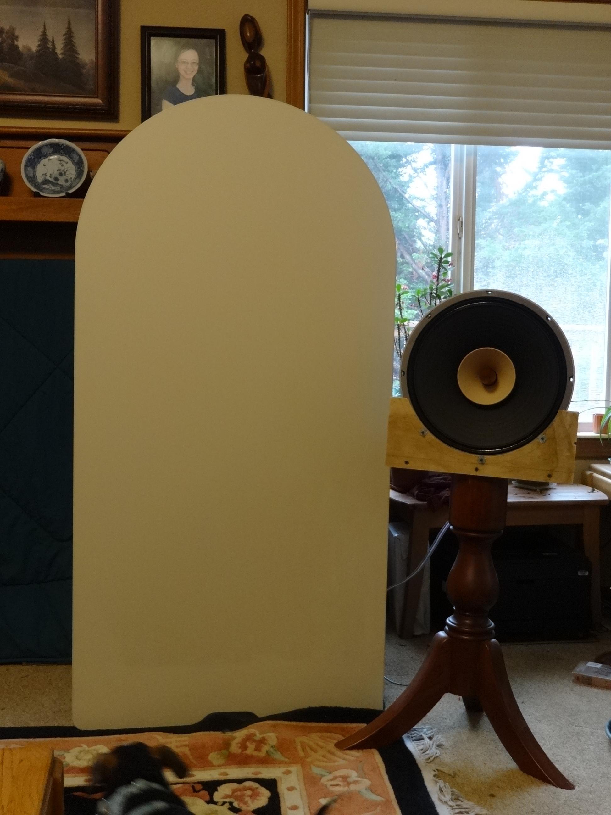

Proud owner here, as of last week. I threw them up onto a pair of table leg stands, just to be sure they're OK after shipping, as a Saturday morning effort. They are.
I'm quite happy with the sound. Now, I need to mount them on an OB design of some sort. Any assistance would be much appreciated!
I was casually thinking I might replicate Decware's "Betsy" design and would like to understand why the "barrel" shape works. Caintuck Audio, the originator of the Betsy, also offers "tombstone" style baffle boards with parallel sides.

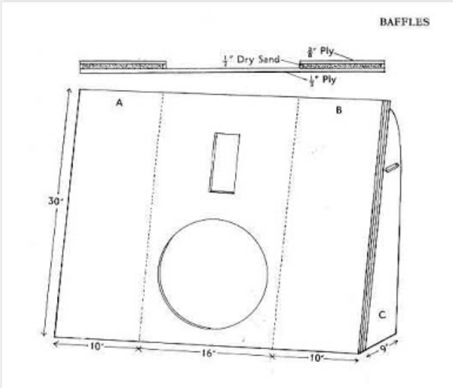

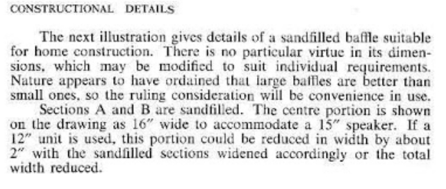

I had a look on line for the "old wharfdale baffle" and found this;
I like the comment that "There is no particular virtue in its dimensions". Also the tilt-back angle wasnt shown in the drawing. Apparently the "Betsy" stands up straight and I was wondering if I should incorporate some backward tilt into the stand part.
I'm also wondering about speaker height. I'd like to keep the speaker center 20 - 24" up off the floor (to match my seated ear height) but I understand this may be wrong thinking on my part, as there may be as much to lose in some other performance aspect if I do this.
I can see that the speaker position on the baffle correspondes to the wing shape of the sides. If I flipped the whole thing 180 (conceptually), would I get combing due to the speaker height being more toward this ear height I think I want?

Gilbert Briggs was being a touch 'British' with that one; it was actually a rather well designed baffle. Mixture of accident and design perhaps, but it's popular. The driver position is deliberately low to pick up some boundary gain for e.g.
The Edge program shows best bass with a wide baffle and the driver off to one side. The wider side of the baffle can be turned back 90% so the from looks like the driver is centered.
I like that idea, folding the baffle back on one side only means less of a problem with cavity resonance and the overall narrower baffle means less blockage of the front wall reflection.

Well, here it is. (My wife went with me, so I didnt, er, get a chance to stop at the granite store...) I got 4 of them and they charged me next to nothing for a brand new table top.
They weigh 53 lbs each, very close to my max safe lift limit. 30" wide, and I'll probably be using somewhat less than their 59.5" height but I'd like to keep the vertical orientation.
I'm hoping someone can suggest where to arrange the 15" driver cutout on the surface, if different than the obvious spot. I'm OK with it being offset from the circular top, if sonic benefits are a result.
As all of it is a compromise, I'd simply like to do the best I can with this set of material. I'm OK with losing the octave below this speakers 60 Hz Fs; these cones are pretty tight and not suspended at all like the Wharfdale woofers.
