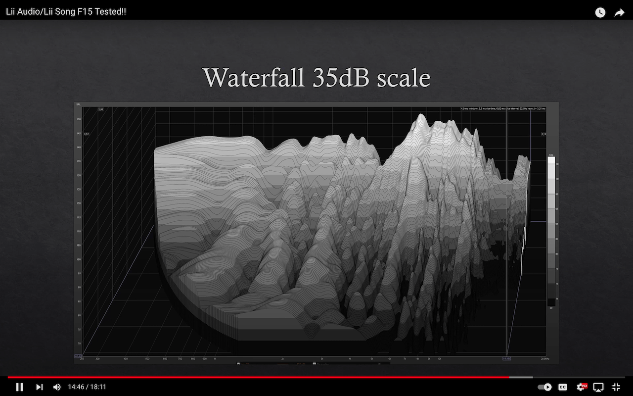

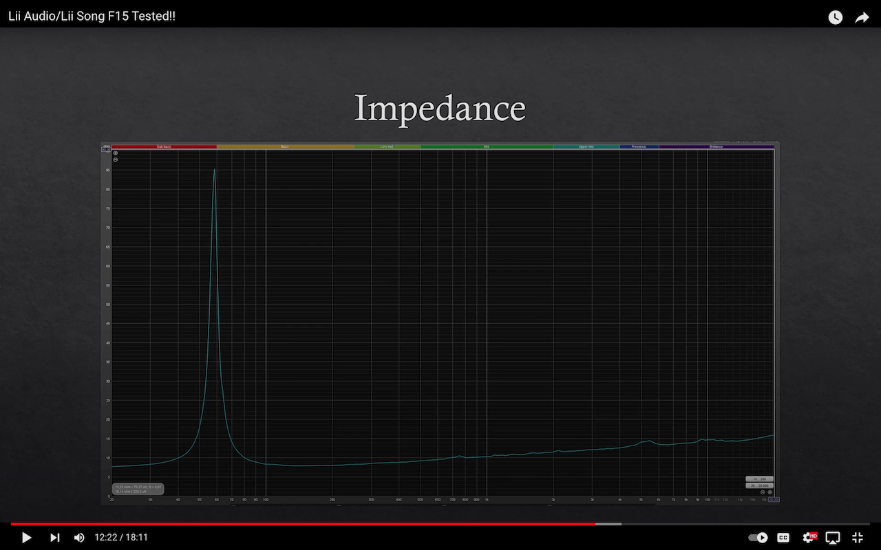

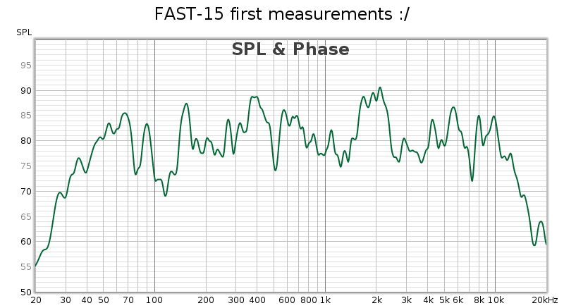

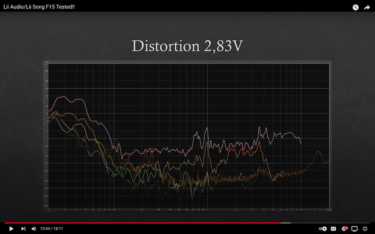

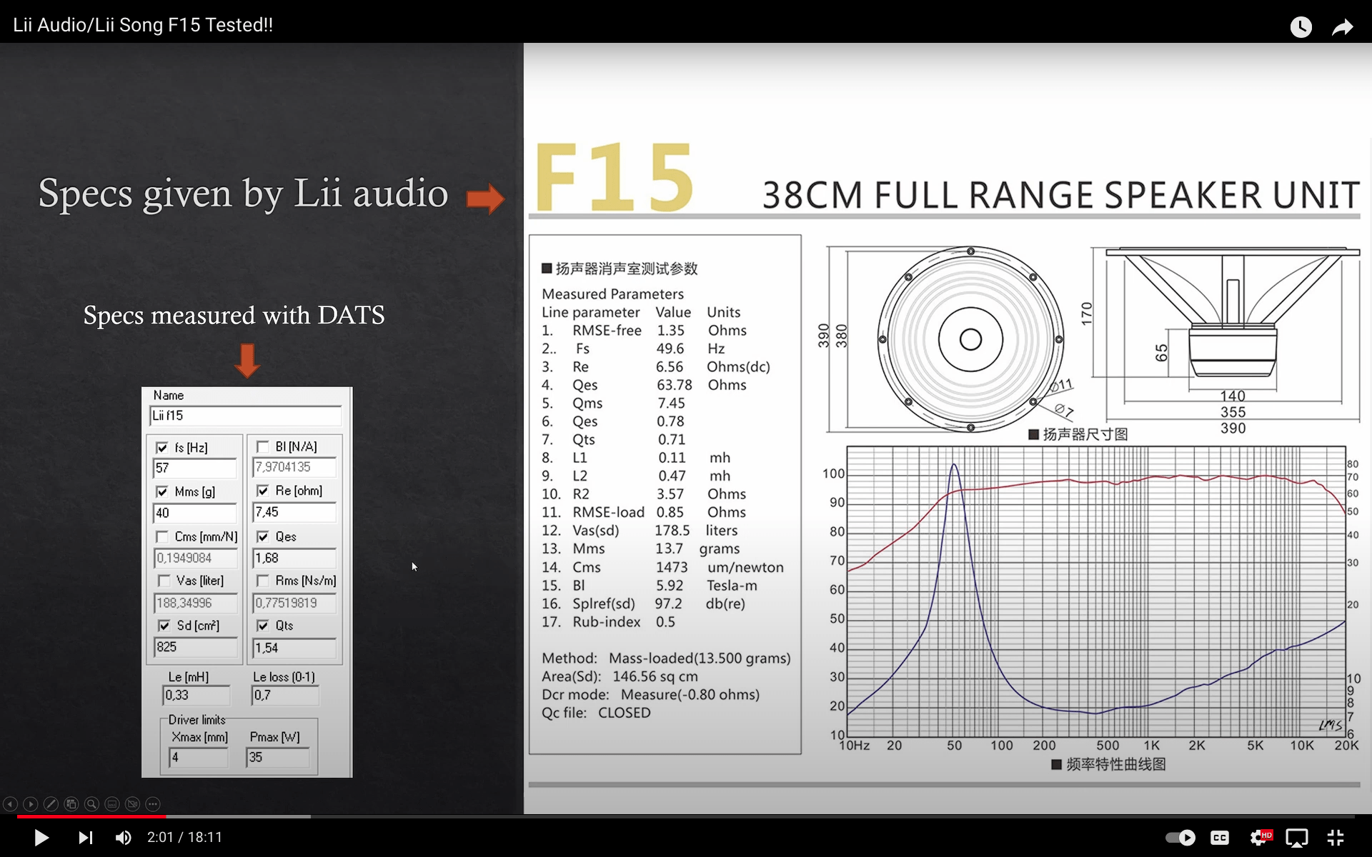

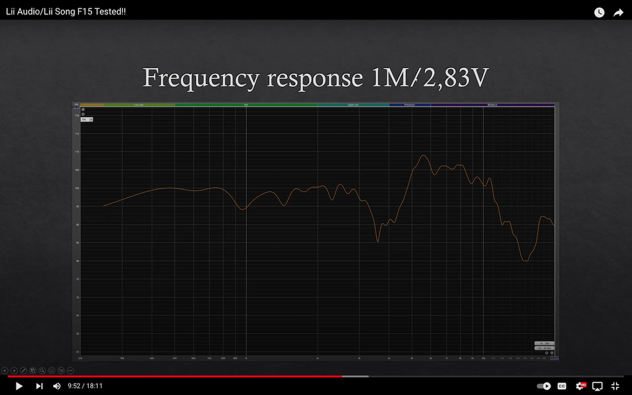

Lii Audio 15" full range
from yt link
huge gap btw published and measured TS 🙁
take a look at the Mms... and others
SPL measured from 1m

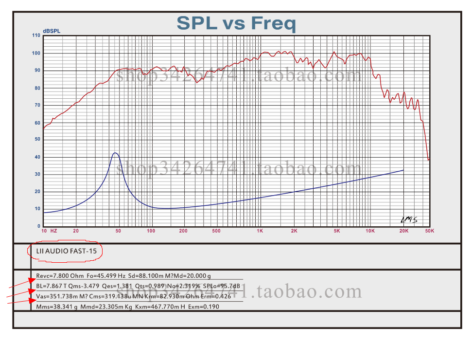

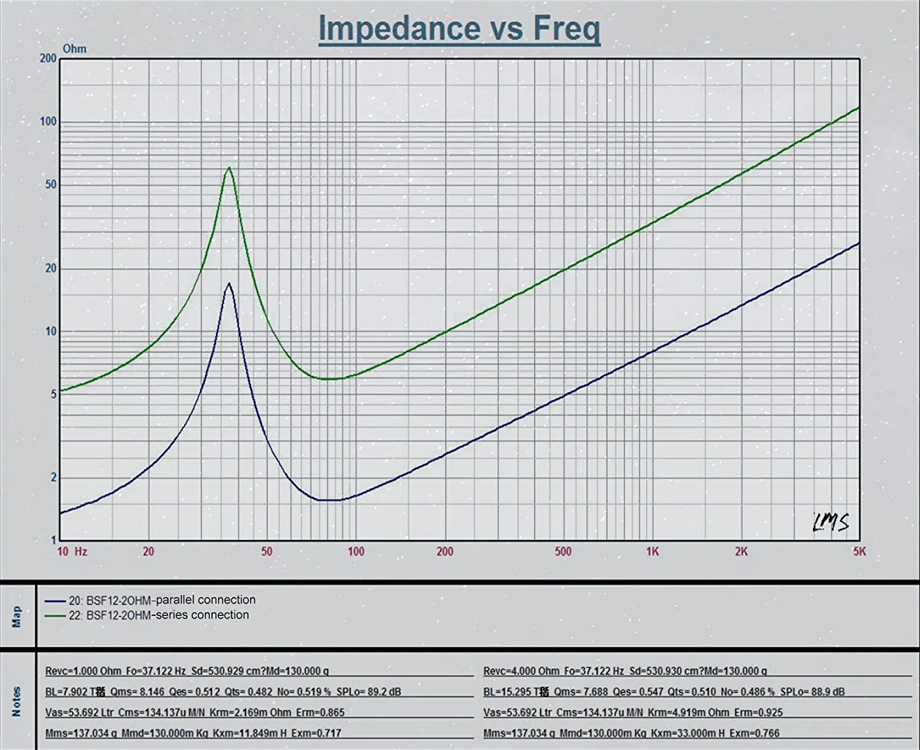

There are some arguing about 2 "brands" of these drivers. IMHO booth are "fakes" and probability that they cooperating is high...
Booth companies using same generic metal baskets for drivers (as every single driver comes with in last 10 years), generic just slightly modified cones and hangings, generic magnets and so. Probably some generic voice coil...
The published datas of TS and SPL are false.
Measurements software using the different font and standard for displaying measured datas according to some member of this forum published facts (This is from "original" brand given datas), so published pictures are retouched...
For me the story about these "2 brands" are over... cheers

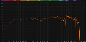

I asked a commercial loudspeaker manufacturer for frequency response graphs of his designs. He answered, with a grin, "sure, which frequency response do you like?" He explained that he had bad experiences with providing the graphs, because people focus on what they think matters and always find fault. They also compare graphs to those from other manufacturers. And he knows the effects of his room perfectly, so he can find this one angle and distance where bass extends to 20Hz, there is balanced midrange etc etc etc, so he doesn't see the point. He can post measurements and still be lying. He does not object to users posting measurements however. Occasionally someone has measured his speakers and there are some wildly different response graphs out there... 🤣
None of these measurements are done in the standardised way like review magazines do them, and it shows. It's like several different drivers. Frustrating.

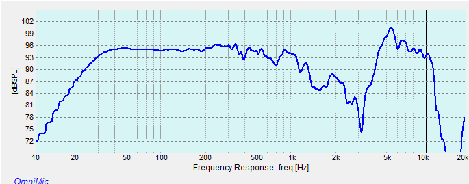

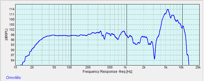

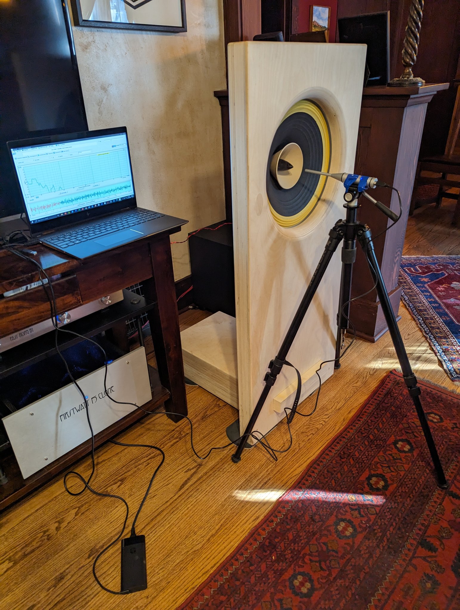

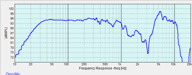

@Zoran, regarding your post 406 above I did those measurements with my Omnimic V2 and at a few different distances. I was planning on posting measurements to show how the results change with mic distance since a previous person on the thread had expressed interest. Unfortunately I have reason to believe my Omnimic has developed accuracy issues and I'm not sure if you can trust the results in my previous post. I hope to resolve this soon-Dayton Audio has not responded to multiple messages so I need to call them. By the way I agree that the frequency response that both Lii companies post for their versions of this driver are poppycock.
